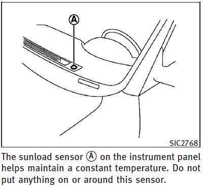

Are there any objects covering the sunload sensor?
Attached Thumbnails Is There Something Wrong With The Auto Climate Control?-sunload_sensor.jpg

From: New York Metro Area
No objects on the daash covering the sensors. I turned down to 60 and it still did not go full blast. Saw 4 bars on the blower graph, but not full blast as it should. I'm thinking.....that this car lowers the blower speed when using voice recognition. I have my cell phone on when entering the car, bluetooth picks it up within a minute. Maybe something to do with that. We'll see when I bring 'er in for first check up at 1,000 miles.

Retraction: Now with the G parked in the sun, I did experience Full Blast Auto A/C kick in. Evidently, in original post of this thread, the car was parked in a covered garage, drove a relatively short distance of 4 miles to get home and the Auto Climate Control never went into full blast mode even with the outside temperature at 90 degrees.... She worked yesterday as designed....
