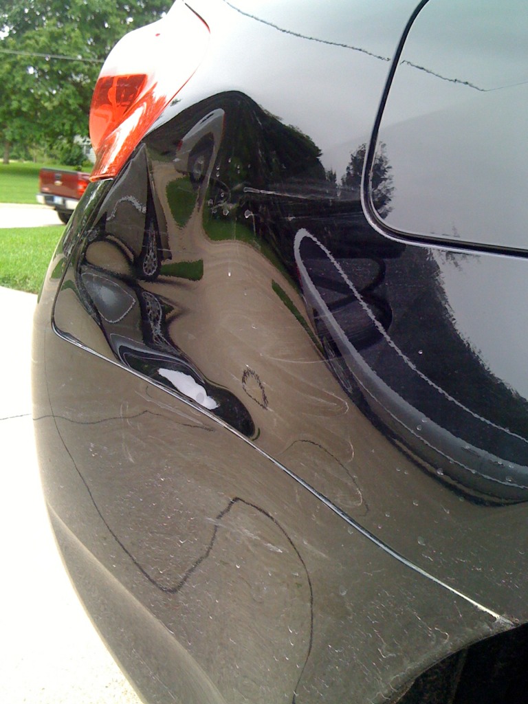

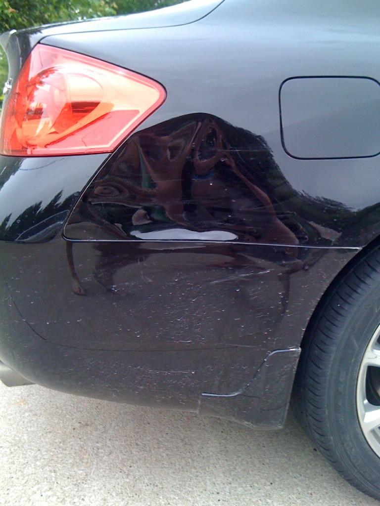

Hello Everyone,
I am looking for advice as my 2009 G was backed into a couple weeks ago. There is a dent behind the rear passenger tire on the seam between the rear bumper and the quarter panel. There is a little bit of paint damage but not much. I got an estimate at the my local dealership and it was around $3,200 to replace the bumper and a section of the quarter panel. The insurance adjuster (other lady's insurance, not mine) wrote pretty much the same estimate and wrote me a check for $3,500 (I think he used different labor rates or something which caused the $300 difference). I then took it to a really good body shop that I have taken my other cars to and their estimates was $1,300. They said they could repair the parts and not have to replace them. At first I was hesitant to do this until I found out that they dont replace the whole quarter panel, they cut it somewhere and weld in the replacement piece. The guy at the body shop said the other two estimates included replacing both items because that is easier to input in the estimating software and that fixing the parts requires a little more experience as to estimating how long it will take. I even told them that the other estimates were $3,000+, basically telling him I was willing to pay that much, but he still said repairing the parts was a better option. I am confident that this body shop does excellent work. Am I crazy to just have the pieces repaired and not replaced? Thanks in advance for your help!!

You would be crazy to replace the entire qt panel lol... from the looks of it, the rear bumper doesn't even have to be repaired or repainted.. you got REALLY lucky.

yes that is how body shops do it. They always cut a section of the quarter panel that's damage and replace it with a good piece. If u replace the entire quarter panel it will cost way too much. What the body shop advise is a correct method and not juz something he made it up. Saving money is always good also

^^^ sorry but that is NOT how a proper body shop does it! I went to school for collision repair before doing this as a career.
Ok listen to this...
I work as a body man at a dealership here in my city. That's realy wierd how they said they only section damaged part of the quarter panel and not the most of the thing. If a new quarter panel is needed the proper way to do is to replace the whole thing, that's according to "I-CAR" safety, there is no other right way! It might easily look good after they are done with the car, but in reality if you get in an accident and someone hammers you in that or similar area, it might be your neck, and you might end up getting hurt, cause the car was not repaired properly.
If they section it somehow (I don't know what that guy meant) but it sure didn't sound like the proper way to do the job. I guess I might say they will hack the job and take less for it.
Well by judging the pictures, it looks repairable and I personally would try and pull the dent instead of replacing the whole new quarter panel. But i can't judge, I can't see how the metal is stretched and what other sheet metal is involved in that area. Perhaps it does requires a new quarter, in pictures it usually always looks minimal.
You have to be careful in these situations, cause there are many shops that hack jobs like that and take less $$ for it, it's good to know the shop and it's reputation before giving your car away for the repair.
BTW it would be easy to tell what they did after the repair. Just open the trunk, take the inside trunk lining out and see how they fixed the quarter from the inside.
