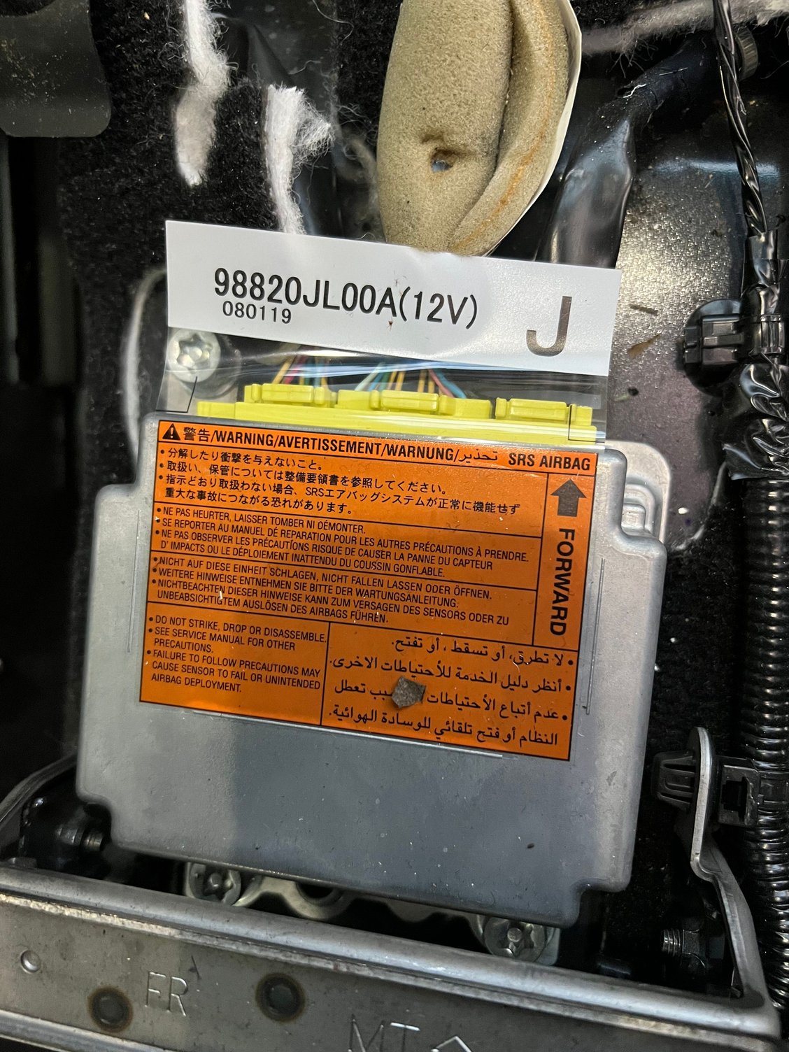

Is the passenger air bag sensor under the center console? Found this
see atta
ched

That is the SRS airbag control module. You have zero reason to touch it. This is the "brain" of the system which includes diagnostic functions, crash detection/ airbag deployment judgement, and backup power. This module contains capacitors which store electricity. This backup allows for airbag deployment in the event of a complete electrical system failure. This is why it is imperative that the battery be disconnected for at least 15min. before removing the airbags. This time period allows for the stored charge in the capacitors to dissipate.

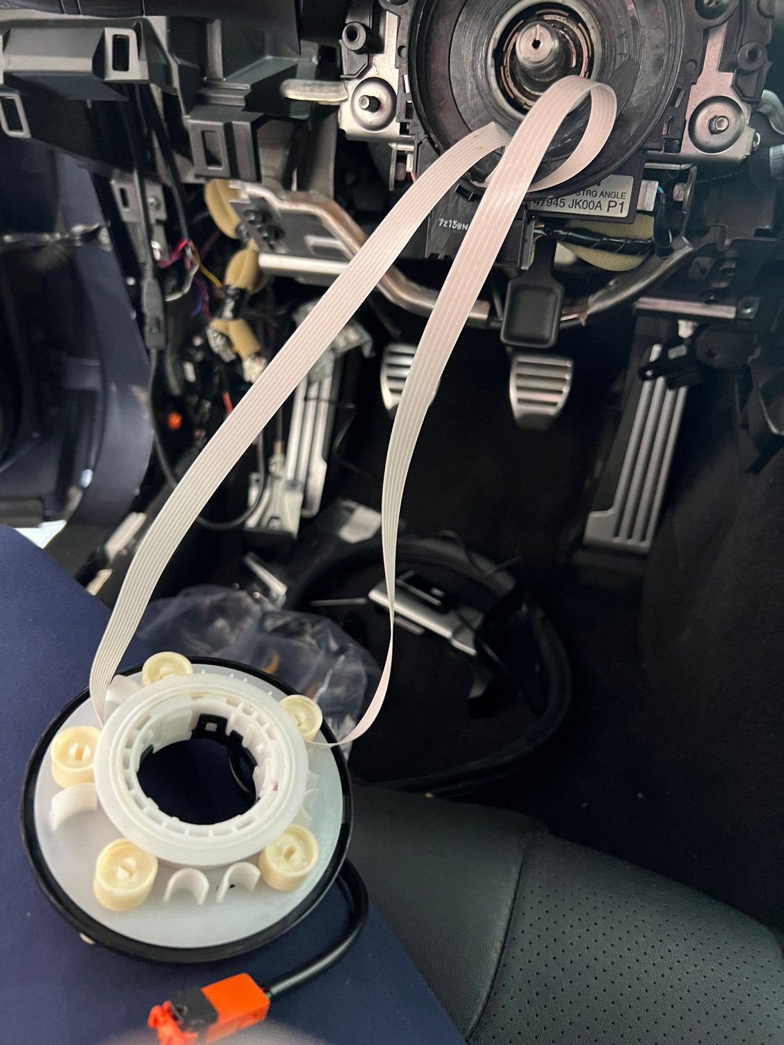

Anyone know how this goes back on? Popped off putting the gauge cluster on

Well, I have bad news for you. You will never be able to get the ribbon cable back onto the spool. Despite the tricks and tips that "google" suggests, the odds of you getting the ribbon properly centered and threaded between those spools will be next to impossible.
Best advice, get a used replacement clockspring from eBay, make sure it is properly centered (clocked) and call it a day. Unfortunately, this means your car will be out of service for a few days.

Dang so close to being done!

A quick check on eBay showed several from the low-$70's on up for used so to get a new unit for $90... ¯\_(ツ)_/¯ New from the dealer will run a few hundred, easy. Your call on that one.
Is there a local junkyard. pull-a-part near you?

No, p/n: 47945-xxxxx is for the Steering Angle Sensor (SAS). The p/n code for the clock spring is 25554-xxxxx (sometimes B5554). To buy new, for a 2008 Coupe, the original p/n for the SRS clock spring is B5554-JL00A which has been superseded to B5554-1EA8A- however, this would have to be matched to your specific VIN. All for ≈$275 and up.
When shopping used, especially on eBay, many sellers will lump both the clock spring AND the SAS together as one unit (often mis-identified as 47945-xxxxx). It is easier and safer for them to do it this way so as to prevent the clock spring from spewing its guts (like yours did). If buying used, just match donor to your car.

got it! So there are two parts here…
so basically I need B5554-1EA8A, then attach to my existing SAS sensor

IF you decide to buy NEW, then VERIFY that p/n against your VIN before purchasing. That 1EA8A number was based off my '08 Coupe VIN...
Either way, when you receive the replacement, wrap a piece of tape around the clock spring to prevent it from spinning. When you are ready to install, you will first have to verify the clock spring is properly centered (neutral position) before installing it onto the column. The centering process takes all of two (2) minutes and will prevent the cable from snapping the moment the steering wheel is turned too far. Section SR (SRS Airbag) of the factory manual will have more detail but the gist of it is as follows:
My method: remove tape, center, re-apply tape, install. When you are ready to install the wheel, remove the tape and put the wheel on the shaft.
It goes without saying that the battery MUST be disconnected BEFORE working on this system.
