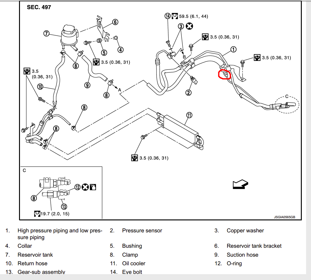

Hey guys, I've had a progressively worsening power steering fluid leak for the last couple months on my 2008 coupe. I was able to get under the car today and locate where it's leaking from, but I'm not sure exactly what I need to replace or what the part number would be, and I'm hoping someone could help me out. Right now I'm just topping off power steering fluid after every drive.
I've circled where it's leaking from on the diagram below. It seems like maybe the connector is bad, or the hose it's attached to above it. I'm not too sure. It's really only when I have the wheel fully turned in either direction and when the car is running, but when it leaks it leaks a lot fast.
If anyone is aware of this part number, or if this is a common issue, please let me know. Thank you!

I'd say somewhat common with these older cars. I had to replace mine a few months back. I suggest purchasing from Rockauto. They have the best deal I could find. Also it comes as a full set both complete hoses. I only replaced the section that was leaking, mainly 2 reasons, one to save time and two because quality seems good but not as good as the original OEM, so kept the rest of the parts for incase...
