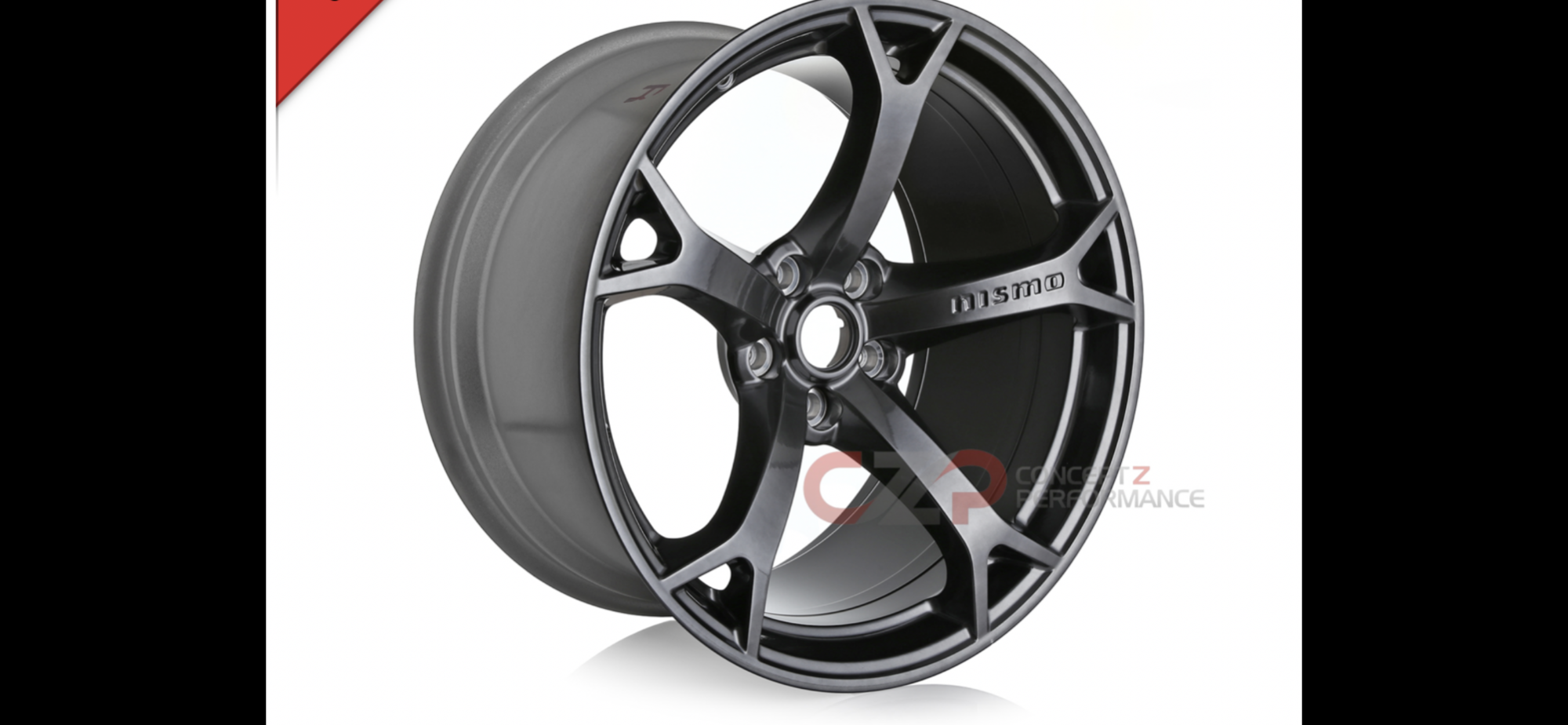

Hey Everyone,
I currently own a 2014 Infiniti Q60S AWD Coupe and am sourcing and shopping around for some Nismo V1 Wheels. (Looking and comparing prices and availability as I’m from Ontario, Canada).
I’m new to the forum and to Infiniti’s. I tried using the search bar typing Nismo V1 etc but nothing came up that I could find.
Just looking for some friendly advise, pointers and information regarding fitment on a factory setup. At this point and time I’m not looking to lower or bag the car.
I was having a hard time picking a set of rims I like, when I stumbled upon these that I personally just liked the look.
Any help would be much appreciated!
Will they bolt right on, do I need spacers, what’s the widest tire I can go with the AWD and anything you guys think I should know or be aware of.
Even if you guys are better at navigating the forum then me and want to copy and paste a link to a previous thread or threads. I’d be glad to read it and do some more research.
Cheers!
attached a few pictures I found on Google

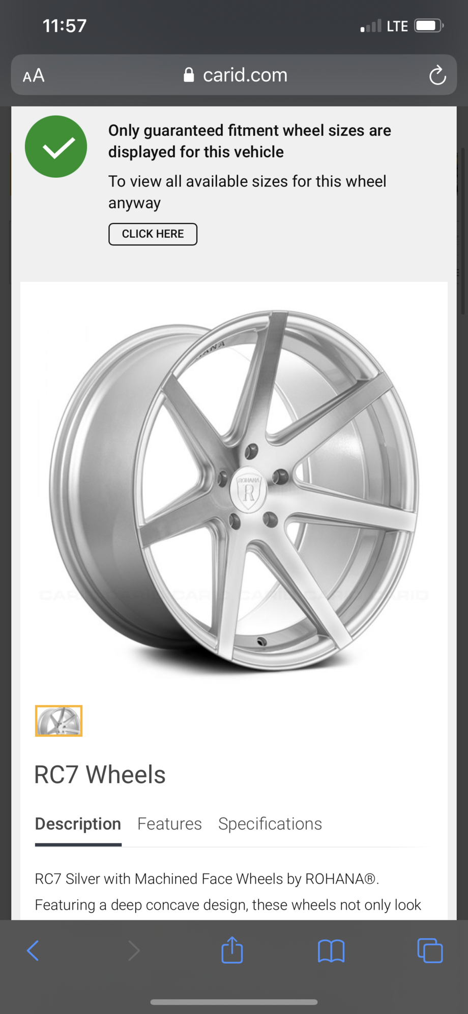

Also just found another set of wheels I like today.
Rohana rc7. Seems like these will be easier to source and be a little more affordable as well.
Just a matter of figuring out a local shop that knows what there doing regards to fitment.
Ideally I would like to keep the factory suspension setup and not get into cutting things, rolling fenders, running etc

I personally like the Rc7's in 19 inch. https://www.myg37.com/forums/wheels-...awd-coupe.html, https://www.teamstance.com/wheel-off...cing-coilovers

Those old Nismo 5-spokes are a great looking wheel.
Aren't they staggered, though? Be hard to find a full set of fronts for your AWD Coupe, if that's your plan.

They are defiantly speaking to me lol. I like them a lot. Price tag is defiantly steep and looks like there’s a few options on where to get them. I believe they are staggered.
I’m a complete Noob when it comes to rim and tire set ups.
Don’t want to mess up the car and the AWD. Want a clean nice look without getting into too much or any modification if I can pull it off.

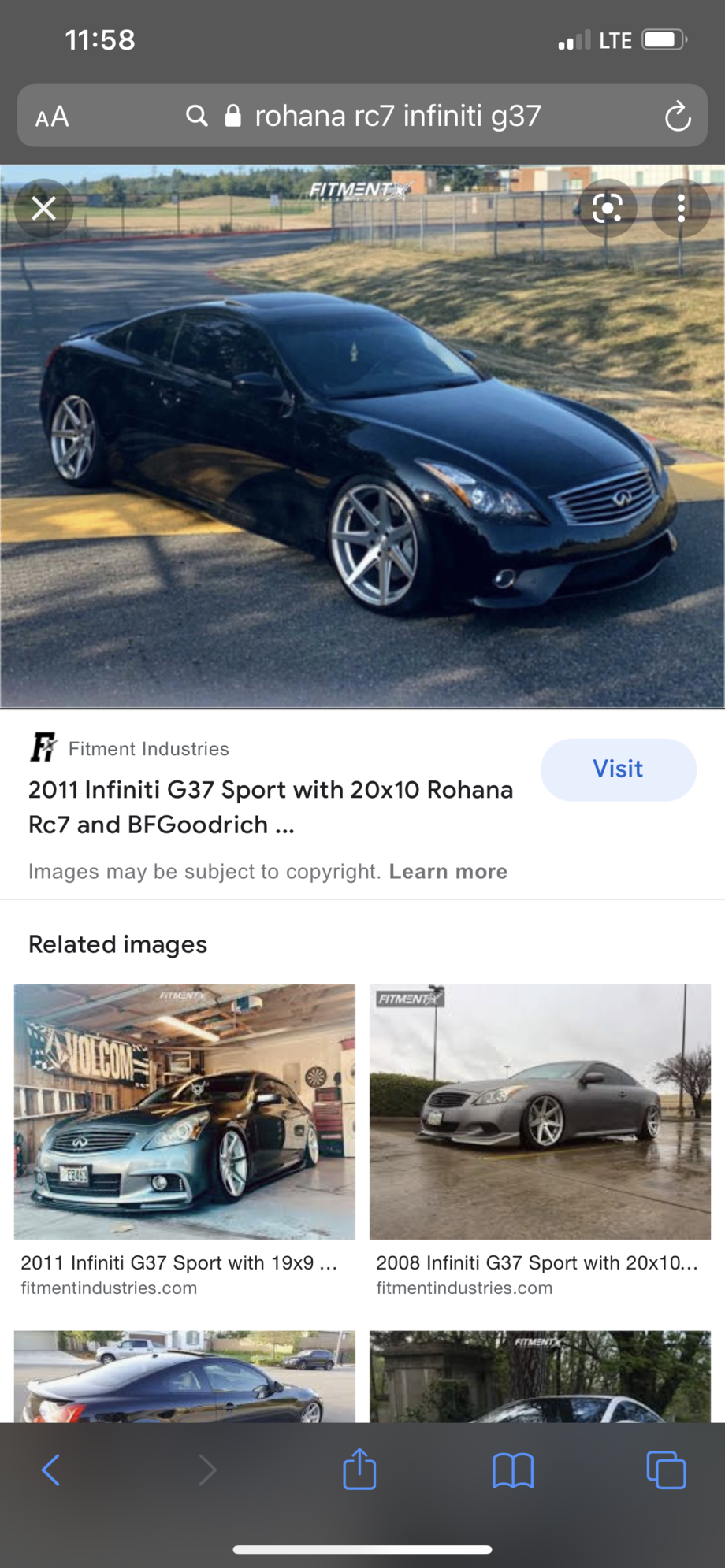

He’s running Rohana RC7's.
20x10 Front on 245/3520
20x11 Rear on 275/30/20.
Mild stretch on the tires and did have to shave off the rear bumper brackets and roll his front fenders only because my drive height is pretty low being he’s on air ride.

You ever see something in picures and was like "they look good", but then you see them in person and wasn't impressed? That's how it was when I saw the Nismo wheels in person. I've seen wheels like the Rc7 in person and they catch your attention more. But to each their own.

The V1 Nismo is tough looking, while still being elegant and OEM. The V2 Nismo wheels look odd at first, but once you see them in person the design pops.
Personally I think those RC7s look uninspired and unremarkable. The kind of wheel every manufacturer has. Some people like them I suppose.
