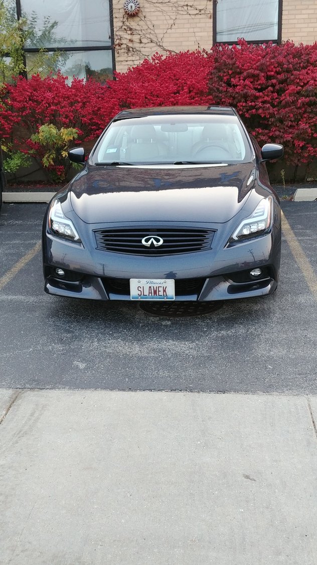

Front , rear and sides.

Originally Posted by spoolin03
like those headlights in here
Alpharex. Full LED
