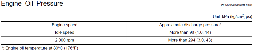

Is it normal to be at 100+psi when accelerating? I just installed an oil pressure gauge and wasn't sure if this was bad or not. I know that it should be at least 14psi at idle and 43psi at 2k rpm. The car is also supercharged, if that makes a difference. I've read that I need to have a gauge that reads up to 150psi, since our cars can go up to ~125psi. However, GlowShift doesn't sell an analog gauge that goes up that high.

Short answer: Yes, it is normal to have more than 100 PSI at higher RPM for the VQ37.
Oil pressure is determined by only 2 things: (assuming good mechanical condition)
• Engine RPM
• Oil Temp
On my G37, with the engine oil temperature around 80°C / 176°F, it will show more than 100 PSI from around 3,000 RPM and up.
The VQ37's oil pump is very large and moves a lot of oil to keep the VVEL system well lubricated.
Also, a 120 PSI gauge is OK, but it might get pegged a few times.
You don't need to worry, everything is as it should be
