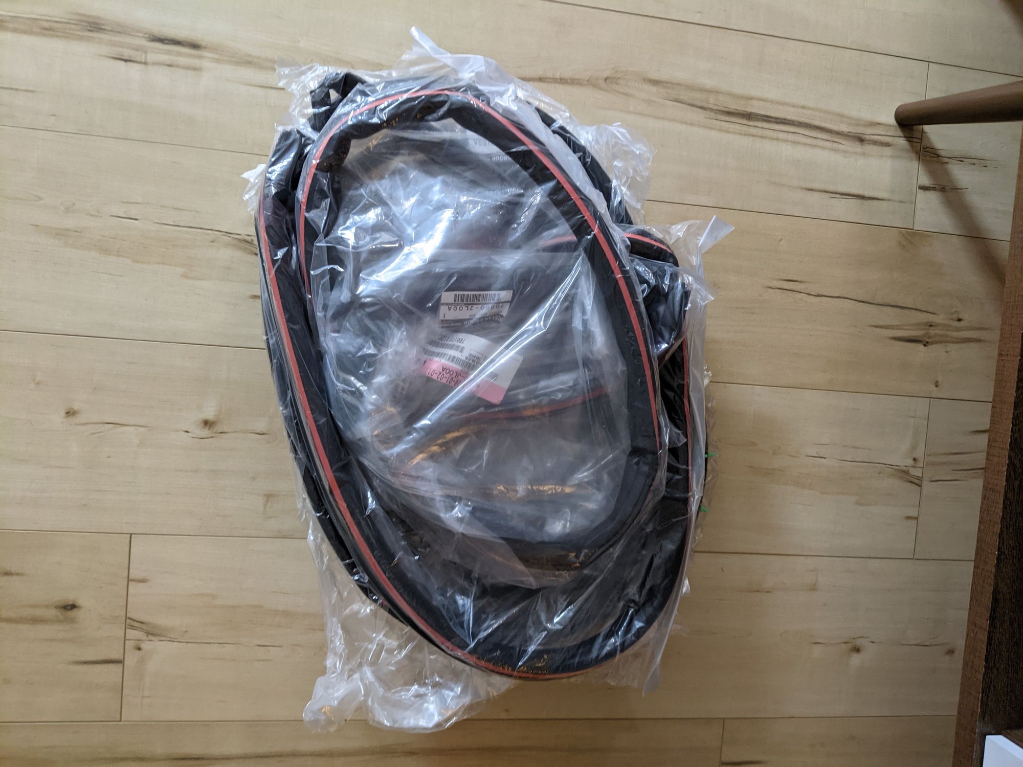

So my parts from Japan finally arrived. I placed my order on February 05, 2021 and paid extra for International Priority shipping. The parts took a while to be sourced, package was shipped on 2.18 and it took a little over a week to get to the states. Packed very well, all seals were in place and I saved a ton of money by ordering from them. I will try to install them all tomorrow.

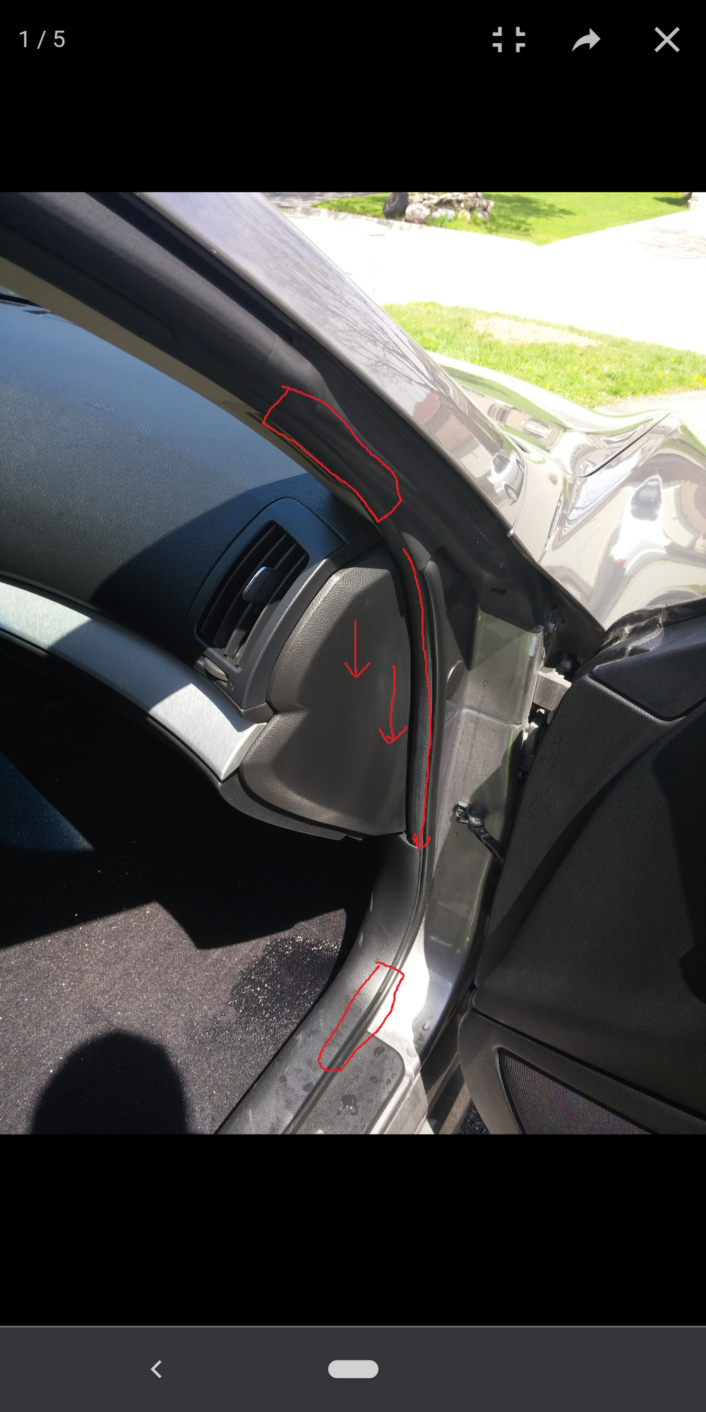

So, I replaced all door seals: upper, triangle and lower door on both sides. It was raining yesterday and I checked the car. It appears as passenger side still has the same issue as before. I carefully looked at the seal and where the water is coming from. And it appears to leak from underneath the upper seal. I attached a screenshot of someone else's photo that highlights the issue. In their case it was solved with a new seal. In mine however it appears to be something else. The car has a clean title so that should not be a problem. Driver's side was dry before seal replacement and it remained dry after, I installed seals the same way on both sides. It seems the water gets through that plastic roof trim and comes behind the seal and follows down where the kick panel is, instead of leaking in the interior it pools around kick panels and remains there. I imagine with heavier rainfall it will end up overflowing inside. When I opened the door, I was surprised with a slush of water pouring out of the kick panel area. I'm gonna try to replicate the issue today while it's dry, and see what I can do.

UPDATE: As I mentioned before, the water was coming from under the top body side weather strip around the area in the photo from previous post. Seals are brand new, properly installed. To replicate the issue I started pouring water between the front pillar finisher and the roof, not in the sunroof because that is completely different drain system. With the weatherstripping in place, it was hard to see where the leak originated so I carefully pried the top weatherstrip off and I saw where the front pillar finisher met the roof of the car and followed the water drops. Once even a little bit of water was poured in the channel between roof and top plastic pillar the water immediately ran down inside the interior, the weatherstrip was simply routing the water in the kick panel area hence nothing was getting inside the interior until it was overfilled. The door seal kept water between the door and body side welt and once I opened it, a pool of water would be released on the ground.
After I removed front pillar finisher, it was obvious where the water was coming from. See attached photos. Not sure how the clip broke, not sure why this was removed at some point... But the fact is the water was simply getting under the pillar finisher, behind the seal and ran to the kick panel following channels in the weatherstrip. Front pillar finisher comes with a seal that supposed to keep water out, in my case it failed due to broken plastic clip. I will epoxy this part and put it back in place and test it.

So, in other words, the dirt built up creating a "dam" effect and allowed water to seep under the finisher seal which was loose from the broken clip?
Sometimes it is the smallest things...
Hopefully this will resolve your leaking issue.
