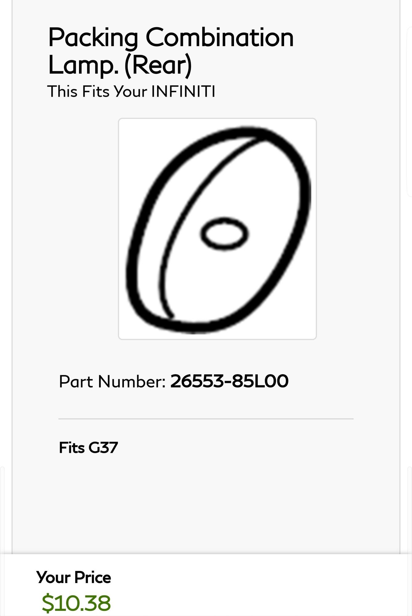

For those inclined, the part number is 26553-85L00 and they cost $10.38/ea. from parts.infinitiusa.com as of 8 April 2020:
Mighty expensive rubber washers.

Are you guys afraid of Nissanpartsdeal? The same part number on there is $6.97.
