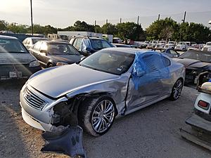

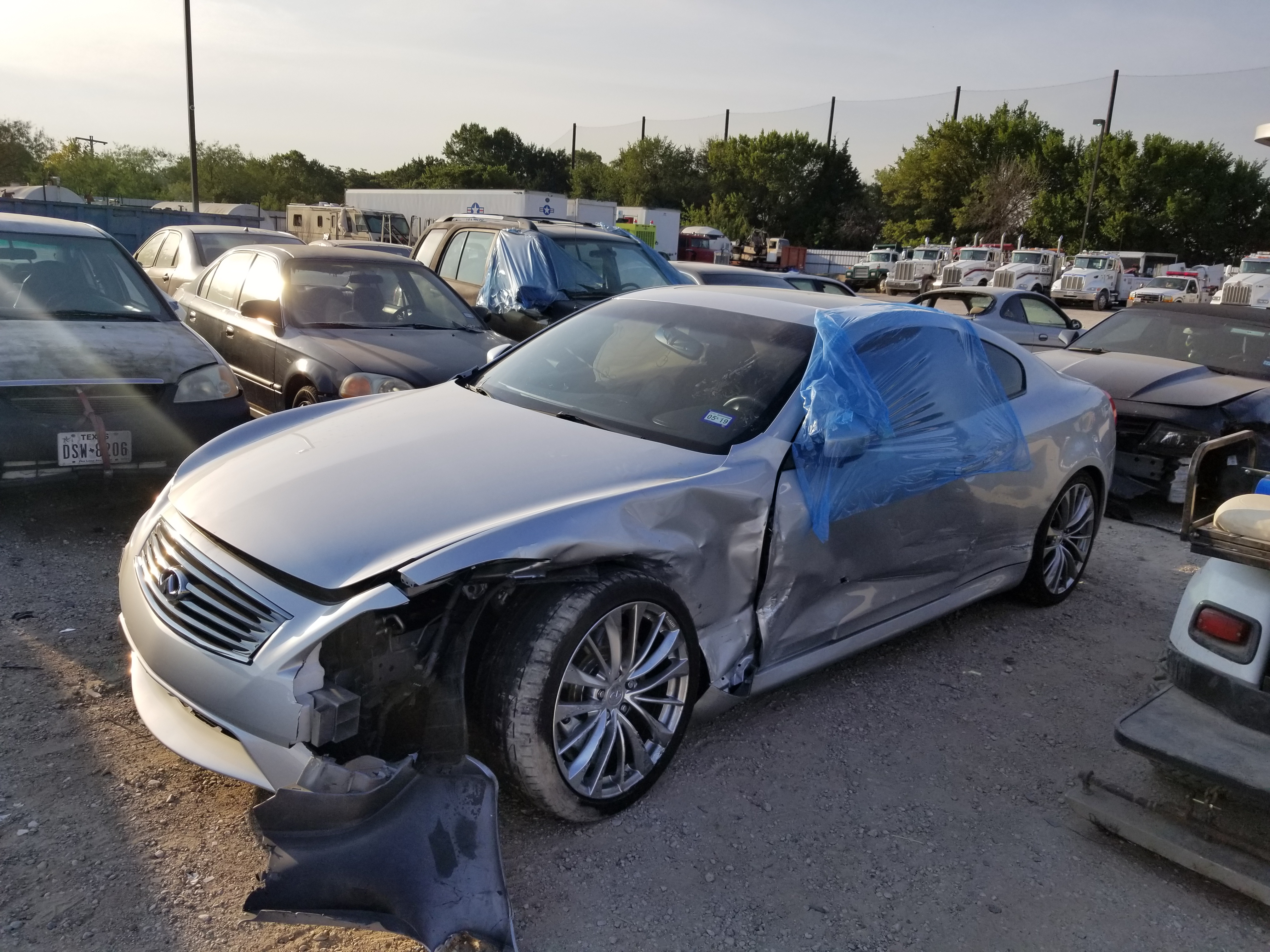

I can one up you

awh junk i thought this car was modded and had good parts to grab
Old Jul 25, 2018 | 02:41 PM
Surfnazi's Avatar
Surfnazi
Posts: 2,109
Likes: 176
Engine mods, exhaust, brakes, suspension, v1 hardwire, wicked cas box and jl amp
