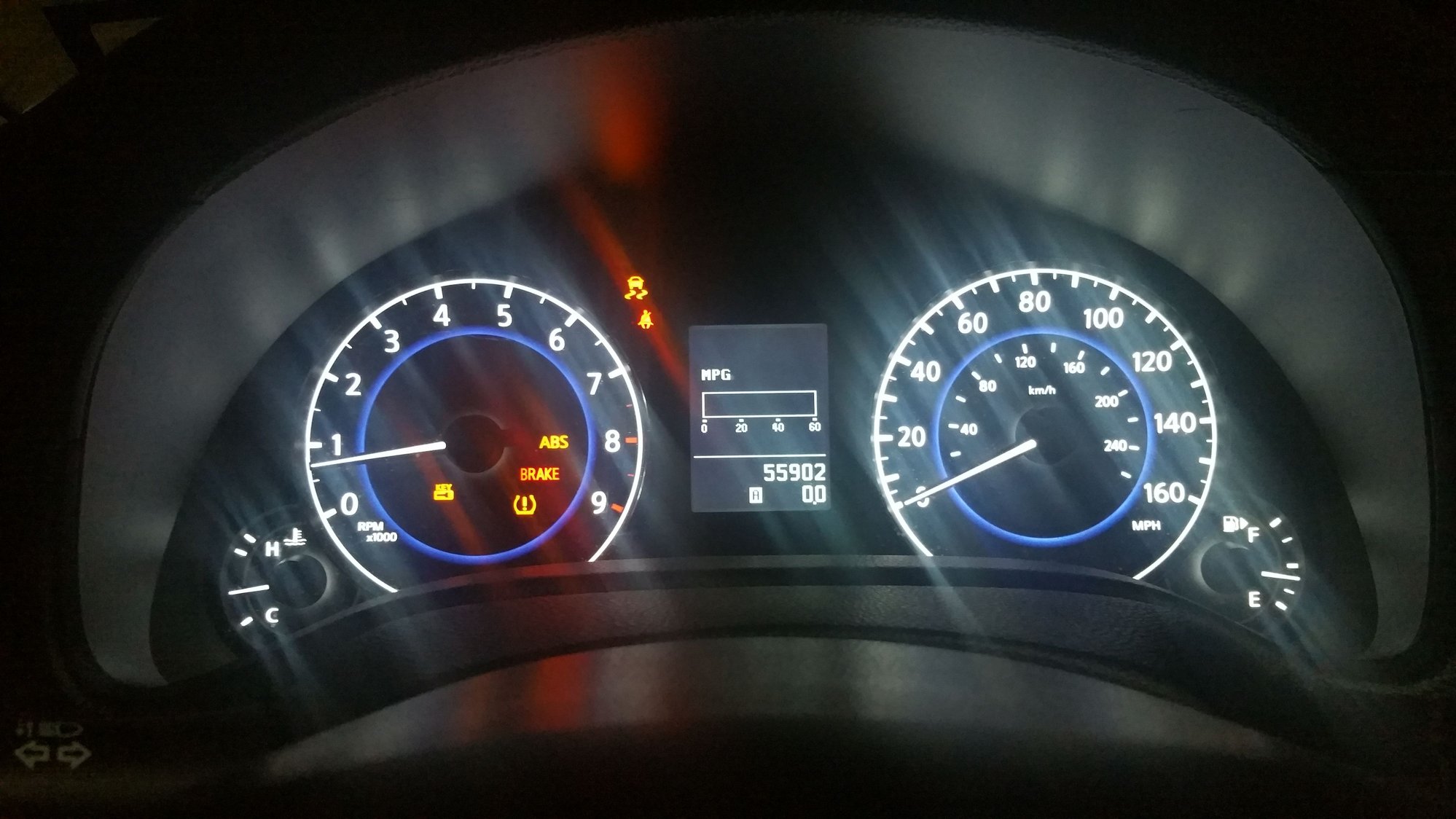

Well I went back and attempted to change out the yaw sensor toggle switch I installed, for a more pretty one... Well this may have just cost me a ton of money...
So first thing is first.... I am probably the dumbest person on the planet for at least the next 14 days. I forgot to unplug the battery before working on electrical stuff.... I'm already beating myself up plenty for this, please keep it to yourself...
BEFORE I disconnected the battery, I disconnected the 3 or 4 plugs required to remove the center console. Then I proceed to remove the yaw sensor switch and keep the wires apart from each other. I then connected my new fancey switch, pics below, to the 12 volt wires that my radar detector is connected to. Eureka! the switch had power! But the slip light was still on. Here is where my genius really begins to shine...
I FINALLY decide oh lets unplug the battery so the slip fault code will clear. Then it hit me, well **** Austin. You are working with electrical stuff, why the hell is the battery still connected????
So I removed the negative terminal. Well the damn wire kept moving from where I kept putting it and striking the ****ing terminal. Of course this happened probably 8 times in quick succession and of course there was a little spark. FINALLY the negative terminal stayed put. I gave it a few min, started the car, and now my dash is light up like a christmas tree.
Car starts just fine, however I have to hold the ignition button for a good 4 seconds for the car to turn off. The car drives just fine, but it feels like I have no power steering. I have reconnected everything and I still have the same lights. Even went for a drive around the black and the lights remaind.

Sorry to read about your mistake. Everyone who "DIY" has done something stupid.
Rapid cycling of the power or unplugging connectors while the power is on can damage control modules, and I suspect this is what happened.
I suspect the ABS module since the YAW sensor is directly connected to it, no speedometer, and stiffer steering. (The power steering control module needs the vehicle speed, or it goes into a fault mode)
Your best bet may be to take it to the dealer. Special tools are required to access the ABS module and test it.

Originally Posted by G10
How about you drive around the block and see if the sensors reset itself.
I've driven her about 10 miles and nothing has changed
Yeah. Going to have to just take her to the dealer. Hopefully extended warranty will cover it!
