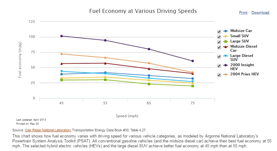

Interesting chart. Keep in mind how much air resistance (at higher speeds) effects fuel economy.
Old May 20, 2016 | 12:35 PM
  #98
Kris9884's Avatar
Kris9884
Posts: 2,073
Likes: 202
From: MO
Good find ^^ that adds some insight to it.. Apparently Diesel is where its at.

Frictional drag vs aero dragplot
Missing is engine drag which is proportional to rpm. Thus the desire to drive in the highest gear at the lowest speed.

So a Buick Park Avenue's most efficient speed is about 44.7 MPH
Old May 20, 2016 | 05:02 PM
  #101
slartibartfast's Avatar
slartibartfast
Posts: 6,105
Likes: 842
From: Houston, Tx
And that will be close to the same for most cars.
