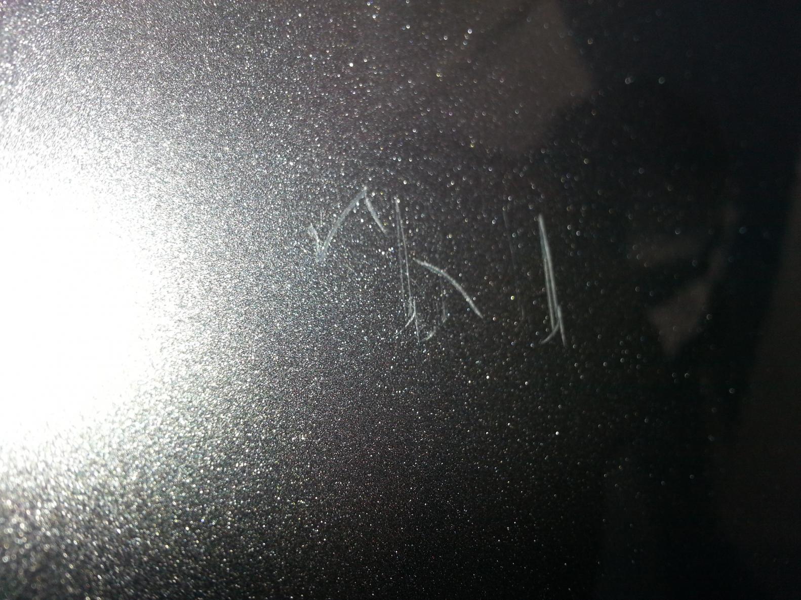

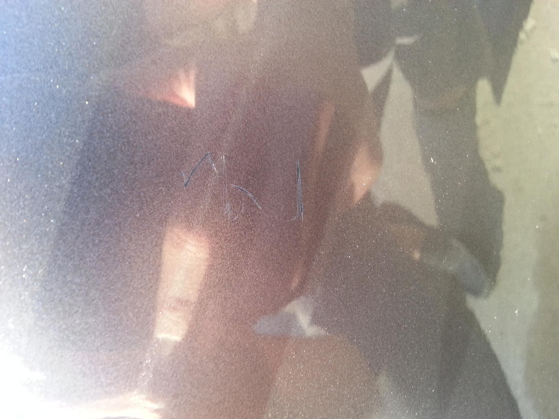

So you guys can see the scratches look, this is a picture. I apologize it does not show the size of the scratches in comparison to the car, but I would say total area is about 1.5in x 1in.
Also, thanks for the replies guys. I guess I'm just afraid to get a whole door repainted over this and have it come out not looking the way I want and have to go through a huge amount of trouble and be disappointed.

No paint job will be ever 100% because the amount of metallic flakes and the spray direction/pattern. It's definitely a tough choice because I think you will see this imperfection either way since you are such an detail oriented person.

That looks like it can be buffed out.

Some of that could be buffed out, but not all. I can see the primer in some spots. He already had a professional body guy who works with the dealership that is paying for this say it can't be buffed out.
I vote for the respray.

Also.. just wondering since most of you are more experienced than me, is it deep enough that it may have a chance of rusting?

ok so here is my background. Im a collision and custom painter have been in the business since i was 18. I worked for 6 yrs at a nissan infinity benz dealership in clearwater fl as the head painter. I am currently living in bristol tn working for a chevy caddy dealership in the area. I am the head painter there as well. I am very **** about color and quality of my work. Unfortunately not all painters are or can even see color good enough to be a painter but somehow they are lol. The scratches from what i can see are to deep for it to be buffed out. not to mention the infinity has what they call a hard clear coat which boils down to it being a ceramic clear. so when it scratches it actually 80% of the time is to deep to buff and is very hard to buff. the estimate for 900 to me sounds like they are atlas "blending " into either the 1/4 panel or the fender. or even both. which is a good thing cause most painter can't blend or match for **** so the extra room is good. When you drop it off tell them you don't want the color to be off at all. you want the ceramic clear on it like it comes from the factory and you do not want any dirt in the paint at all. Dirt is very fine dust that can get into the base coat or clear and is noticeable to a trained eye and you can feel it in the clear. a good painter gets minimal dirt in the paint. It is just wet sanded and buffed after the car is baked. and tell them you do not want any swirl marks either. if you tell them that they will think you know what your looking for and they will make sure usually that the car is perfect when its finished.

and HOLDMYMOUSE that is completely incorrect if the painter is a real painter and can match paint good then you will never know. I've had many warranty surprise reinspections where even the trained guy couldn't tell the difference. not even with a mill gauge. same flake size no paint lines nothing. the sad part is this misconception comes from the fact that a good painter is not easy to find. you could set 500 painters in the same room and maybe 1 or 2 is a good painter 5 or 6 are worth a damn. There is a big reason why a good painter WILL make over six figures a year no matter what. I know i do and have for the last 7 yrs.
