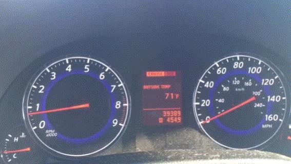

Somewhat frequently, when I start the car, the "CRUISE" light is illuminated and the "SET" light flashes (ON/OFF cycles every ~1 second). When this occurs the steering wheel controls (for cruise) are unresponsive. I don't have the wipers on, my VDC is not disabled, and I'm not outside of the allowable cruise control speed range. Shutting the engine off and restarting the car will occasionally fix the problem but on a number of occasions it hasn't. This doesn't happen every time I drive the car but lately it's been happening multiple times a week (I usually drive the car twice a day to/from work).

I have a 2008 6MT and I've had this problem going on ~3 years now. It happens once in a while and I can't figure out what triggers it. Told my dealer about it but they couldn't figure out what's wrong. There are times when it comes on for 2-3 days while driving and then it won't go on again for a few weeks/ month.

I had this problem with my G when it was under warranty. Took it to Sewell Infiniti in Dallas. They were able to contact Infiniti who recommended replacing the brake switch. No issues after that. But they were able to find out it had been reported and there was a recommended fix.
I had this problem and was posting in another thread. A forum member was sure it was that the upper clutch switch (the one that disengages the cruise control) on it's way out. He said to replace that and it'll be fine. I ended up adjusting my pedal and switch and it stopped acting up. I'll replace the switch when it warms up, but for now it's sorted, so I'm going to ride it out as long as I can.
Yes, "Take it to the dealer" seems to be what ends the hundreds of previous threads on this subject. Problem is that that answer doesn't offer any info! In my case, I don't have a warranty, and I'm not going to pay dealership cost for what ended up being a 10 minute DIY job.
