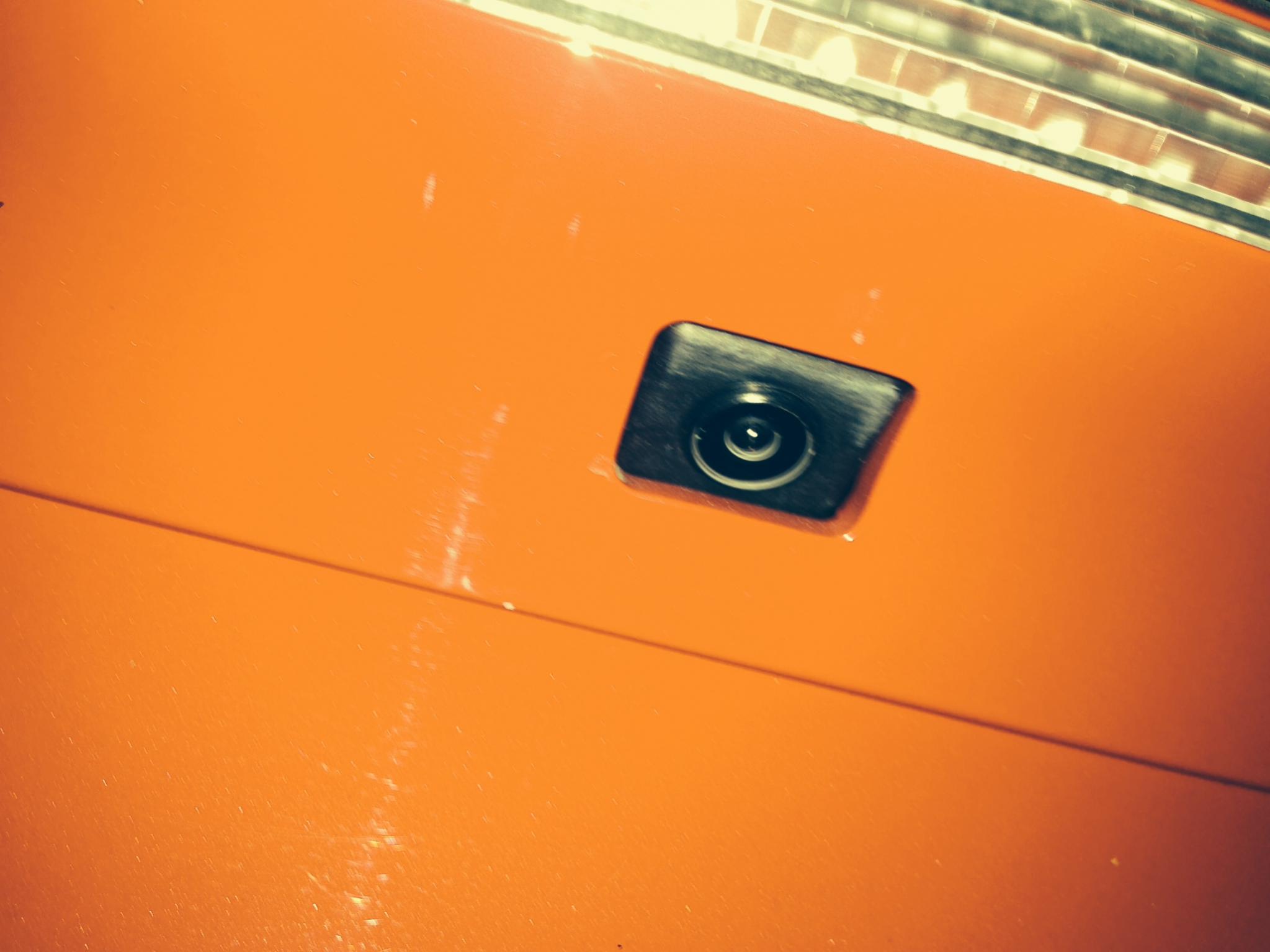

It's not pushed in; mine looks the same.
The edge is a bit rough but the fact that I never noticed it before means it's not something really visible.
Excuse the orange appearance; the car is red but with the iPhone flash...

But I don't see an open gap at the bottom on yours like mine has.
So that's definately a gap of empty space that leads to the hollow of the spoiler (not a shadow in the picture). Can you shine a light in there to see what you can see?

I'm guessing it's actually a shadow and not an opening into the spoiler. I was putting on a license plate frame just now and remembered this thread, so I checked my camera. Mine sits the same way as the pictures that have been posted in this thread. My car is black and it looked like I also had an open gap into the spoiler, but when I grabbed a flash light and looked at it, there's no gap, just shadow.
I've always noticed that I was able to see a bit of my rear bumper in the rearview cam video, but my car is black so it doesn't stand out as much as the white car does. Also, if you look at the OP's picture, you'll notice the graphical guide lines stop at the bumper in the picture, which is another possible clue that the camera is aligned exactly how it was meant to be.
It's definately a gap. I've put some little tools through there in an attempt to see if the camera would pull back out. I'd say the gap is about 1/16" to 1/8" wide, and could allow water to enter the void of the spoiler if sprayed directly at the camera.

Its definitely pushed in a bit..mine has the same problem, and the same visual. A couple years ago my son pushed on it, thinking that would pop the trunk open, and in doing so, pushed it in same as yours.
for a while I tried to get the factory spoiler off, in order to push the camera back to sitting flush with the edge but couldn't figure that out, and just gave up. Just got used to the somewhat off camera angle.
If someone knows how to remove the spoiler easily and cleanly, I'd give it another go.
i tried the exact same thing, trying to get a little tool in there and behind the camera, to pull it back out. no luck.
my gap same as yours, no water leaks and its been at least 3 yrs.

I recently added a factory rear spoiler to my 2013 vert and my camera doesnt have that line because of the cut out. it sounds like the camera didnt get mounted well and when you washed it it pushed it out of position and to have so many others with the same view it might be a flaw in design or something. Maybe there is additional support that doesnt always get installed. Everytime i put something together i almost always have left over srews or parts even if im not suppose to. lol

From the research I've done, sounds like the spoiler has two bolts, but is also stuck on with heavy duty two sided tape that I'm sure would be a nightmare to get off cleanly!
Guess I'll just live with the situation as it is and try to be careful about spraying water at the camera. Maybe a thin application of clear silicone to seal the gap a little better.
A hair dryer will help here if you decide to try to fix it...
