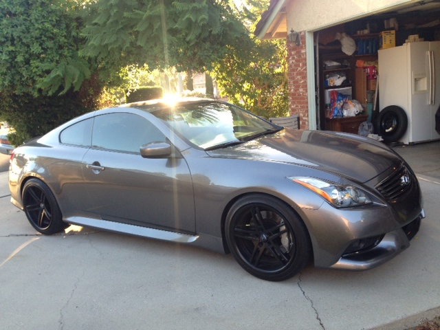

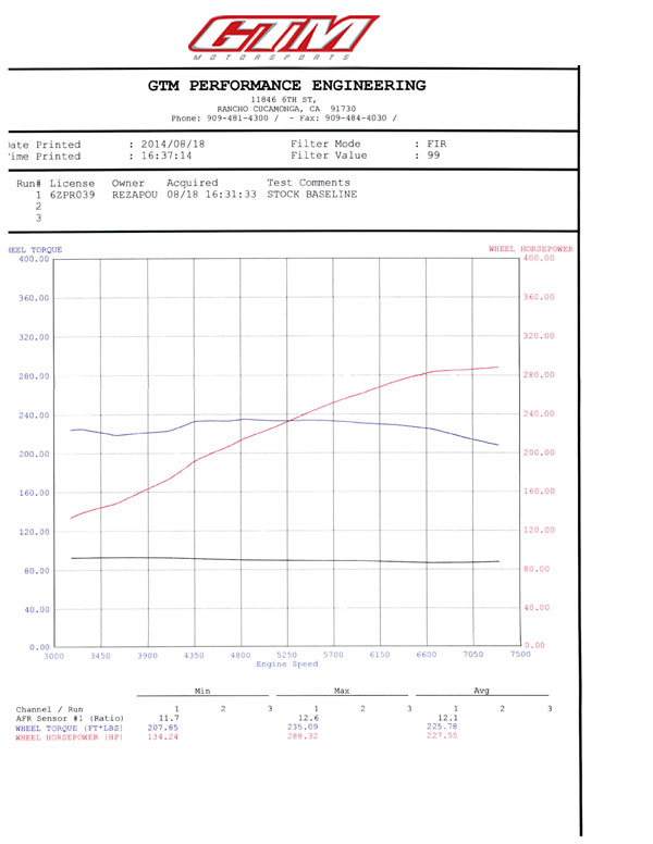

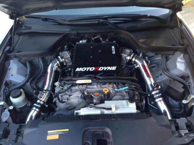

You know that feeling when you just feel like you wanna keep your car forever. I had that today. Just got the g back from the shop. Had the Stillen gen 3, Motordyne manifold, and z1 TP's installed. Scheduled for UPREV tune tomorrow. Attached a couple pics. The dyno was from a month ago when the car was completely stock. Hopefully make some good gains tomorrow, wish me luck!

Great setup and congrats. I have the same setup but trade the gen 3 for Takeda LTCAI. Subscribed awaiting the dynos. Oh plz do a before tube dyno as well sir

I was on the fence about the stillen and takeda cai. Can't go wrong with either one.

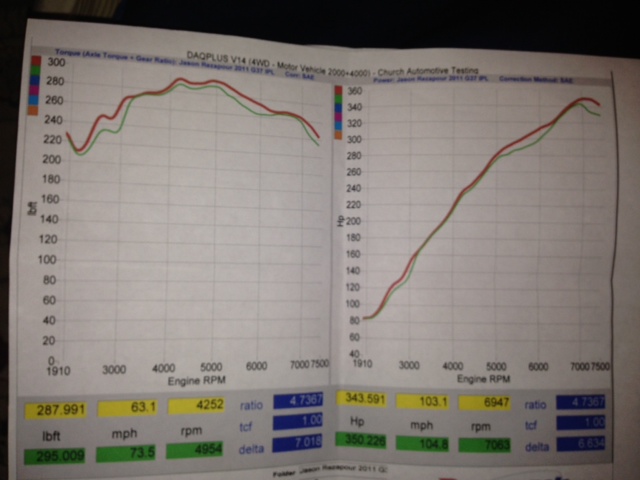

Made 350 on the dyna pack. Take it for what its worth

Na, more like 325-330whp on a traditional dyno w/ LTH. Dynapack takes off the wheels and attaches straight to the hub so there's a ton of rotating mass gone, and the power is much higher. On a normal dyno he'd have lower readings.
Go on a Mustang dyno and you'll only make 295. Dynos are subjective

This is very true. Sean at Church told me I would probably make around 330 on a Dynojet but I find that hard to believe as well..what do you think? Car feels faster since Ive put on the mods thats for sure.

I would estimate around there. My car made 323whp/275wtq on a dynojet with Gen3/ARTs/E370/Tune. I believe Chruch's reads high, even for a dynojet, so you should see good 330-335 I'd guess
