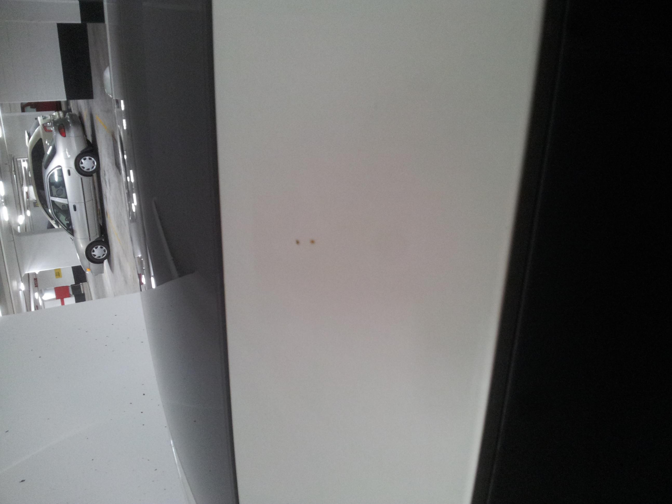

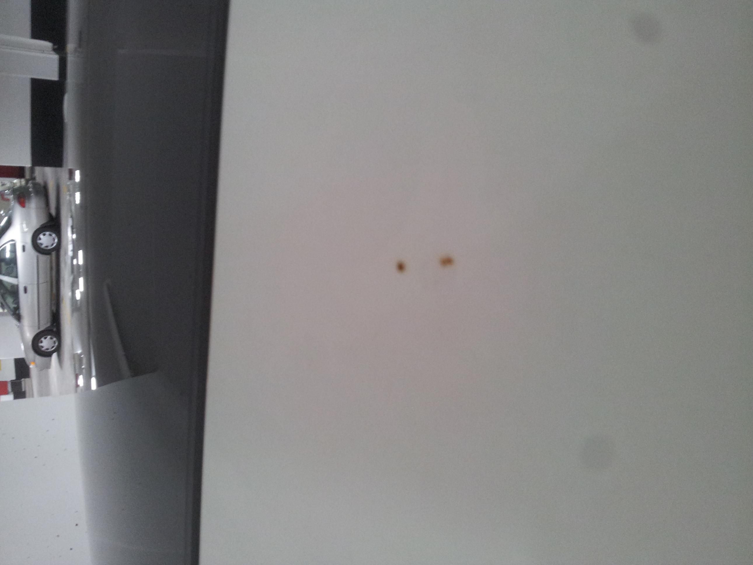

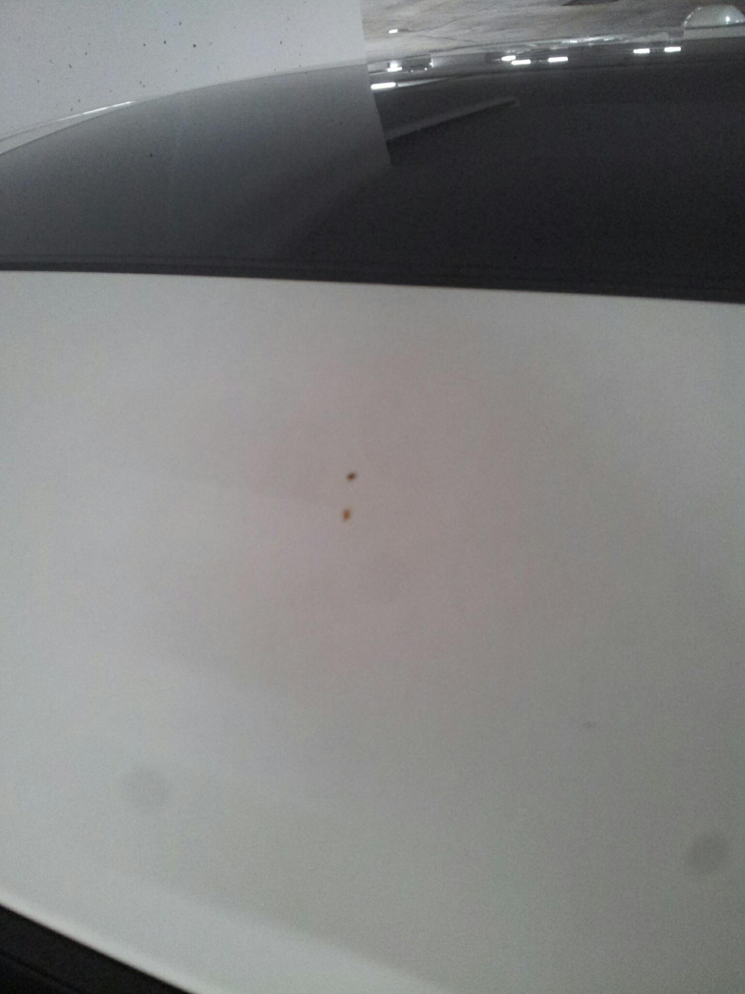

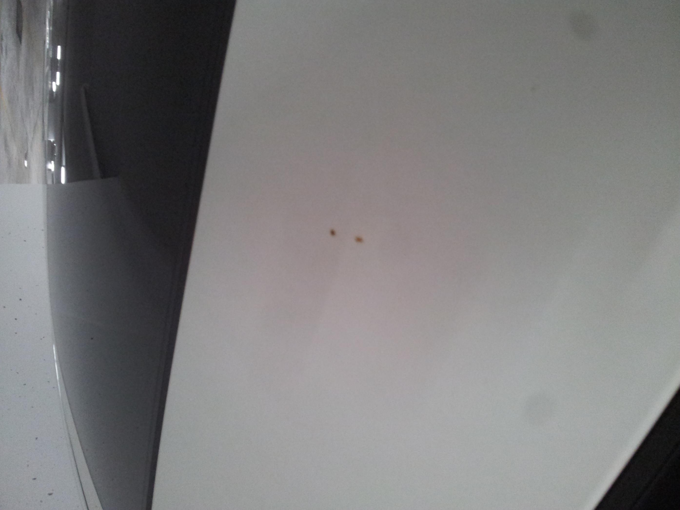

Hey guys,
Love the G. I have a 2008 G37S and just noticed 2 small spots of rust on the roof between the windshield and the sunroof (looks like from stone chips).
I'm looking to see what options I have to fix and prevent it.
I'm from Toronto and searched the forums for body shop recommendations. Someone recommended Avenue Collision in Toronto. They quoted me $1245 (taxes in). They will rope off the windshields, remove antenna (take off headline inside), treat rust, rust inhibitor, paint, and finish. They're not available to take the car until the end of June.
Does the price seem right?
Thanks,
Raj

I would never spend $1,245 on two little spots of rust like that, especially on the roof. I would get a rust remover that is safe on paint and get as much off as you can. It should come off easy since that is surface rust from the bare metal where the paint chipped, it isn't perforated. It may help to use the corner of a sanding block. After that, use touch-up paint. Were talking a less than $20 DIY and you can keep your OEM paint.

To me - that sounds like a pretty normal price for the amount of labor involved. Go get more estimates. Can never hurt.
As far as treating it yourself, it can be done, however it will never look perfect (unless you're some sort of body guy that we don't know about). You need to make sure to get rid of the rust. The stuff spreads like cancer. Living in Canada, I can only imagine it spreading fast!
Do research, get opinions, and more estimates.
