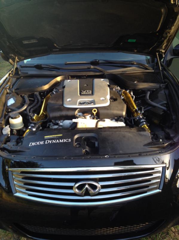

Attached is a pic of my Gen3 CAI wrapped in DEI gold heat wrapped I bought from Brainchild.
