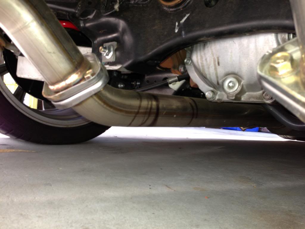

Originally Posted by Dough1397
F***, I've had this on my car since I got it a 1.5 years ago. This explains the monster wheel hop i get while doing burnouts and the brown stains on my diff cover. Any info on if its covered by extended warranty?
Yeah, covered, unless they accuse you of abuse, or suspension mods, like the 370Z guys.
This involves replacing the complete rear suspension crossmember.
Yes, wheel hop is the telltale sign.
BROWN STAINS!!!!
Mines blown too, Im replacing it with a Whiteline bushing.
