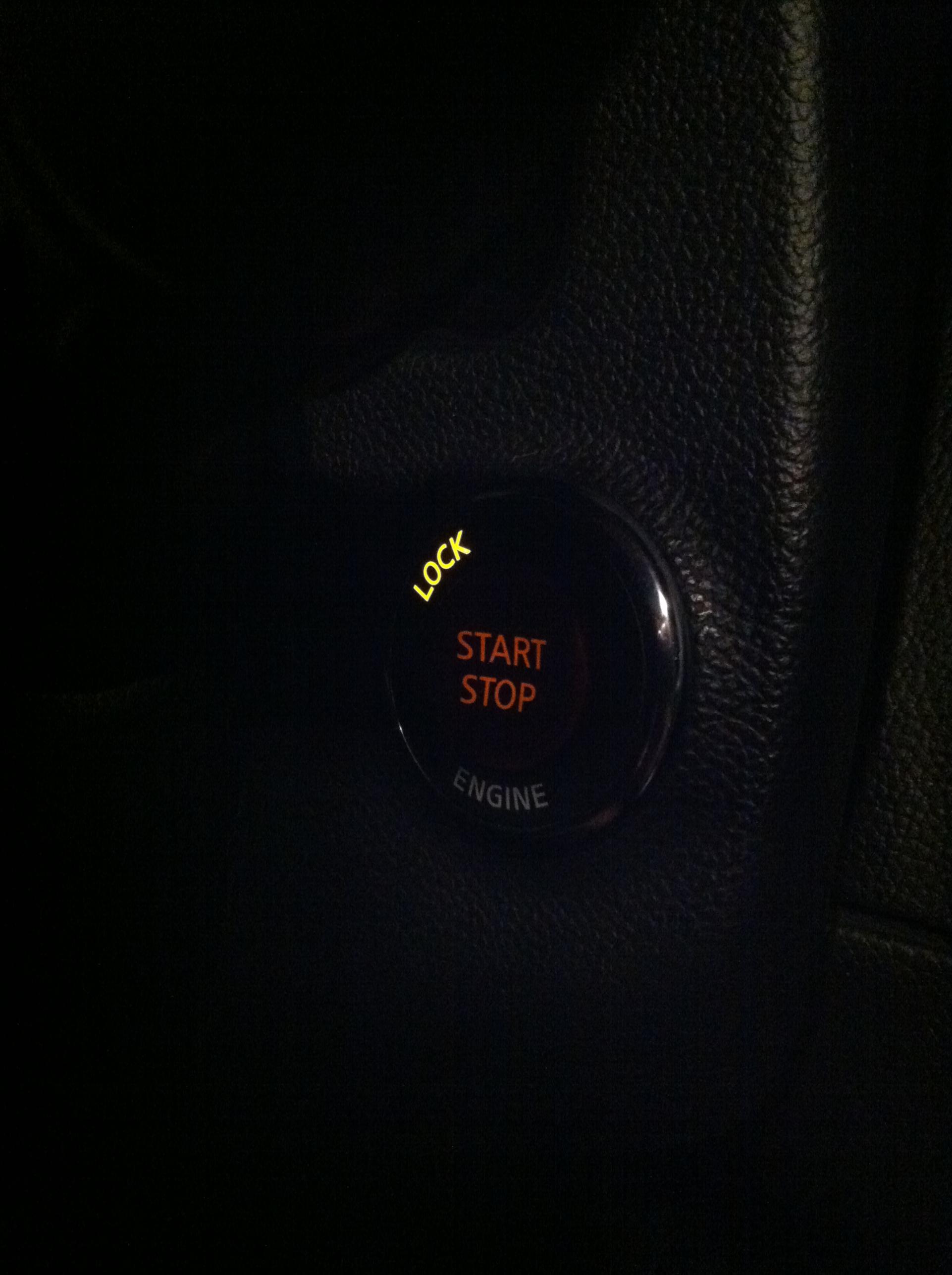

I installed the GT-R red push start button today. Looks great! Except the installation was a pain! I read all DIY's on the forum and my original button simply would not come out by pushing from behind. I had to remove the panel under the steering column to get access behind the button, and used a flat head screwdriver to push the snap tabs out.
Another problem is that during my attempt to swap out the electronics so I can have the ‘white’ vs. ‘orange’ lighting, I broke off (my own fault, it fell out of hands and broke off) one of the LEDs on my original (blue) piece. Pissed!!! So I had no choice but to install the button as is.

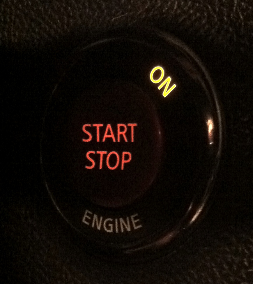

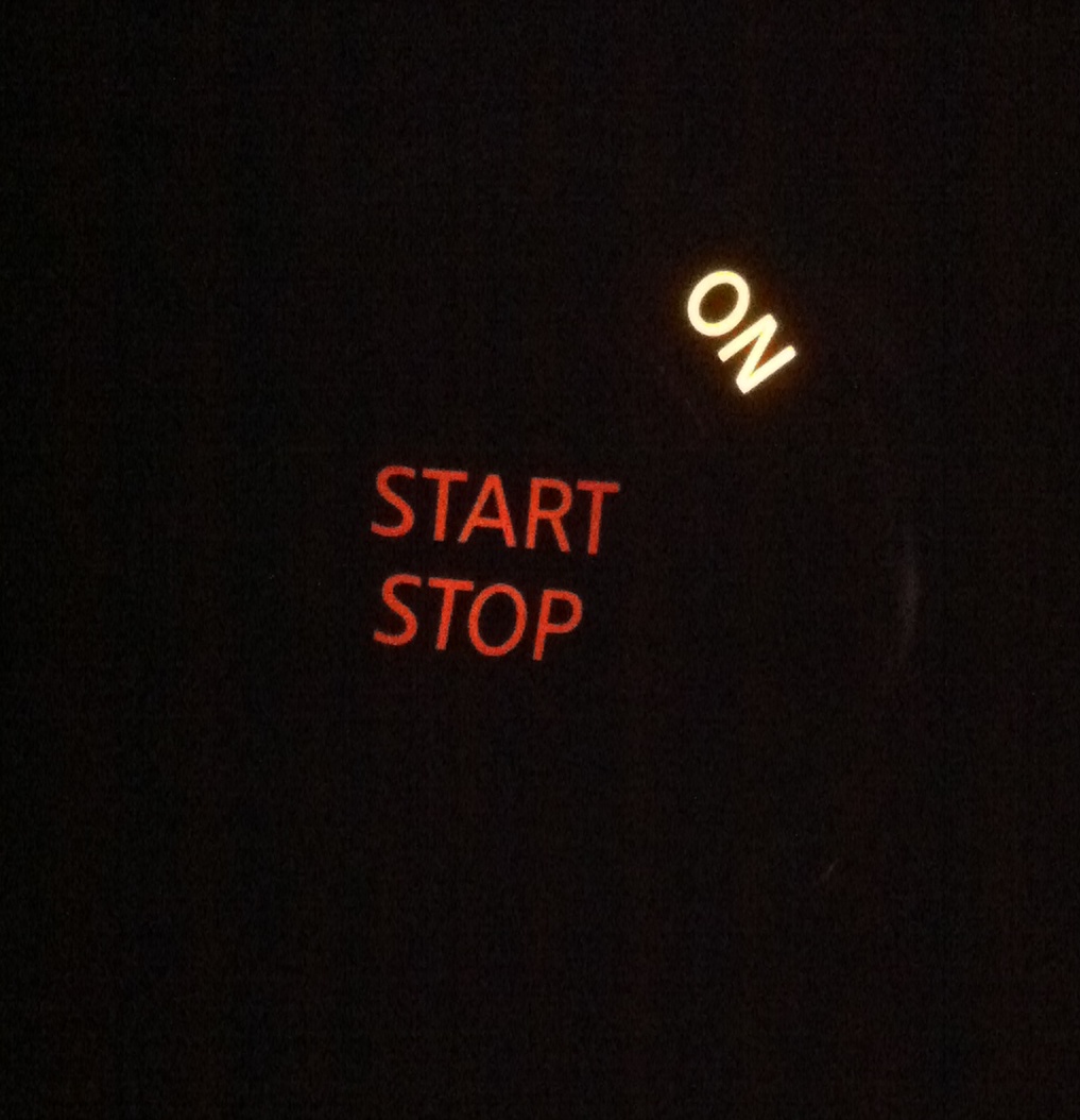

Does the GTR button illuminate at all? I was thinking about this but I like how the stock one illuminates
The button itself does not, only the START/STOP letters illuminate orange... If you swap about the brains, you can have those letters with illuminate white... I took pics so you can see...
But overall, the button looks super awesome!!! Especially during the day... Pics don't do justice...
