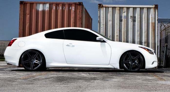

So after weeks of sitting with a design team here in Dubai I've finally signed off on a custom design with work scheduled to begin September 17th 2011 and to be finished by September 27th.
The mods will include a new molded front bumper with integrated LED's, a rear diffuser with the porsche/lambo style tunnel intake, various detailing.
Now after weeks of searching for suitable aftermarket rims I've settled on Incurve IC-S5's
I am however a complete novice at this and despite trying to research and understand how wheel sizing, spacing and offsets work I am still at a complete loss.
I'm hoping you fine gents can help me out a bit:
* I do NOT intend to lower the car at all.
* Current wheels are stock 2011 Sport wheels (114.3x5, 19x8.5 19.9)
* These new Incurve wheels will be 114.3x5, 20x9 20x10.5
As I said I will not be lowering the car at all so I want to know a couple of things:
a) What tyres do I need? I hear Sumitomo are a good brand for this region but what about sizing?
b) I understand that the offsets are +25 for these wheels, will this cause an issue?
c) What do I need to know about using offsets with larger wheels? Does it deter from handling? Does it affect the wheels/tyres in any way?
d) Will there be any friction or problems by using this modded setup?
e) What do I need to look for to make sure everything is put together properly?
f) What happens when the dealership services the car and takes the wheels off the check the brakes or otherwise?
The reason I ask is because everyone is grossely incompetent here and you basically learn the hard way that you really need to scrutinise and know everything about what you're doing or you'll end up paying for it later.
Thanks alot for your help
With all the work you're doing, you really should at least just get rid of the 4x4 wheel gap, it's a must. At least the Eibach ProKit, just lowers your car by an inch but trust me, it makes a difference.
245's and 275's should be fine
+25 for both fronts and rears?
Your fronts will fit nice, rear will poke out a bit. You'll need a little negative camber and drop to fit them. Try and see if they have offsets in the high 30's for 10.5" if you don't plan on dropping your car.
Nope, wheel width and offset only tells you how much they'll tuck in or stick out.
You rear wheels may rub on dips/imperfections on the roads
Well I'd make sure you don't get your tires mounted at a ghetto shop because they will scratch your wheels. As for the custom bodywork, if they're as good as you say they are then I wouldn't worry much there
It shouldn't be a problem unless they want to be a**holes, my car doesn't clear their jacks so they stopped admitting it in but that's not the case with you I believe.

Why do you have apicutre of a lowered car? Just curious. I wish I could answer you other questions but I can't. I will tell you I stand behind your decision NOT to lower your car. I think they look fantastic the way they are.

Posts: 661
From: Louisiana
I know you are getting a lot of flame for not wanting to lower your car. However, the picture of the car in your original post, which I assume your are modeling yours after, is significantly lowered. I, like most others here agree, believe that wheels are only half the look, and that it is important to have a proper lowering kit to achieve the desired stance. Without a lowering kit of some sort your car, though it may have the same wheels, will not look as attractive as the one pictured above.
best of luck, and happy modding
I don't actually think the car looks good in the picture I posted. I was posting the picture only to illustrate the wheels I've decided to go for in an attempt to ensure whoever was reading the post fully understood what wheels I was going for.
Call me stupid because I really don't understand this stuff but to me it seems quite simple. Increasing the wheel size and thus its dimensions should bring the wheel closer to the body by 1 inch anyway shouldn't it?
Btw something else i forgot to ask - if I swap out wheels and tyres will I need to have new sensors installed for tyre pressure etc?
