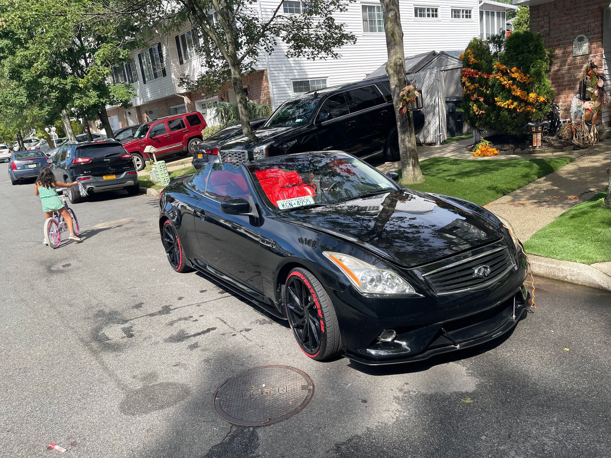

front bumper is the same so any splitter made for the base or s model bumper will fit your base or s model convertible
side skirts different. But you can get away with fitting the convertible with side splitters
rear bumper is different and I dont believe any rear diffuser was ever made for our rear bumpers but I have seen some members convert rear diffusers to fit our rear bumpers. See my convertibke below with front and side splitters. Didn’t go the route of adding a diffuser.

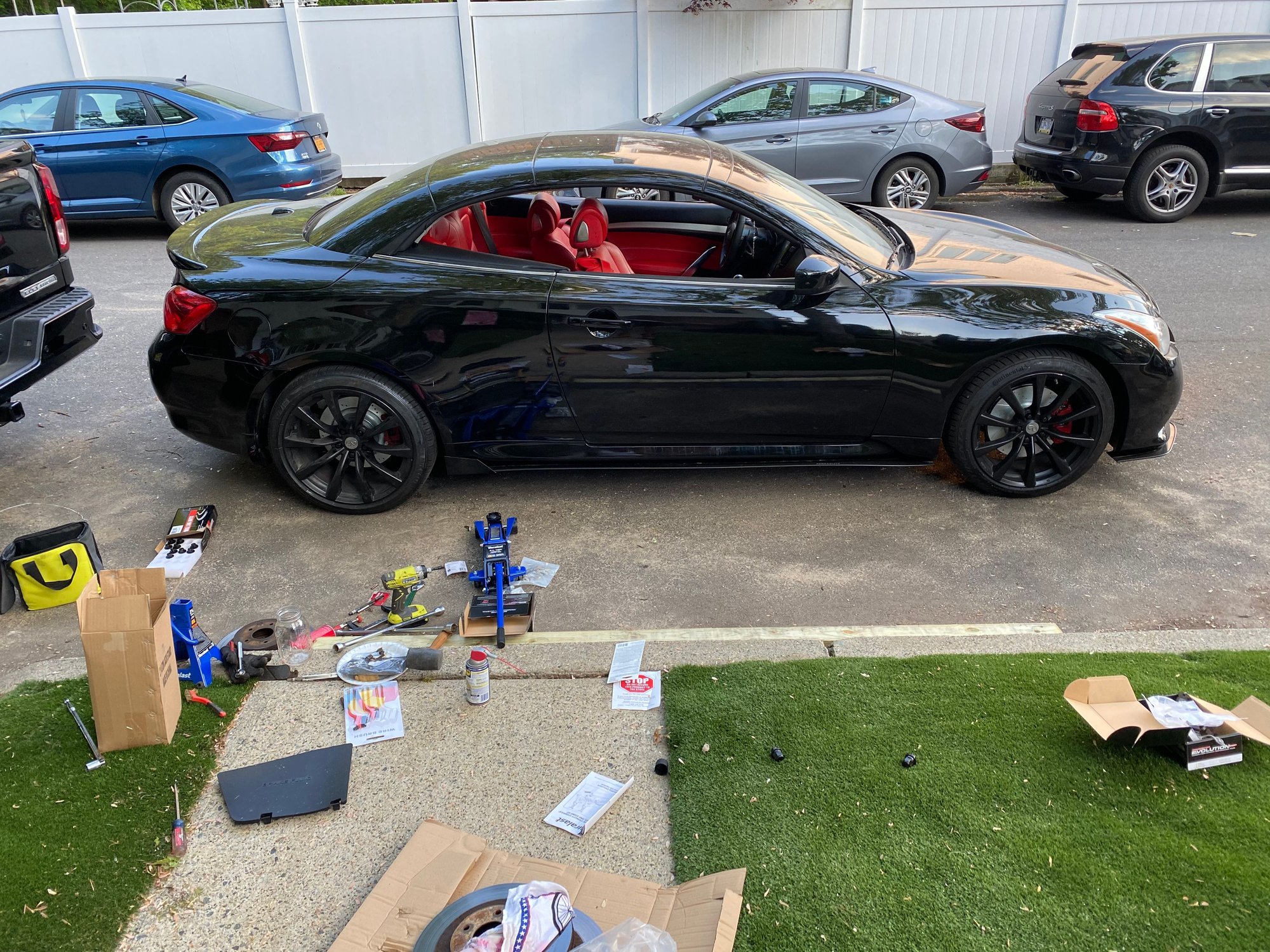

hoods are the same but id stay stock unless you’re going full carbon fiber. These duraflex hoods are made like crap and you’re going to spend a whole lot more to get them fixed to fit the correct way.
again I’d be careful on the wide body kits because of the slight difference on the sides from the convertible compared to coupe. If you do go that route plan on spending a ton of money to get them on correctly. I highly doubt you’ll find a direct bolt on without having to do any modifications after that.
that’s top up with my old rims. Don’t have many pics of the car with the top up
