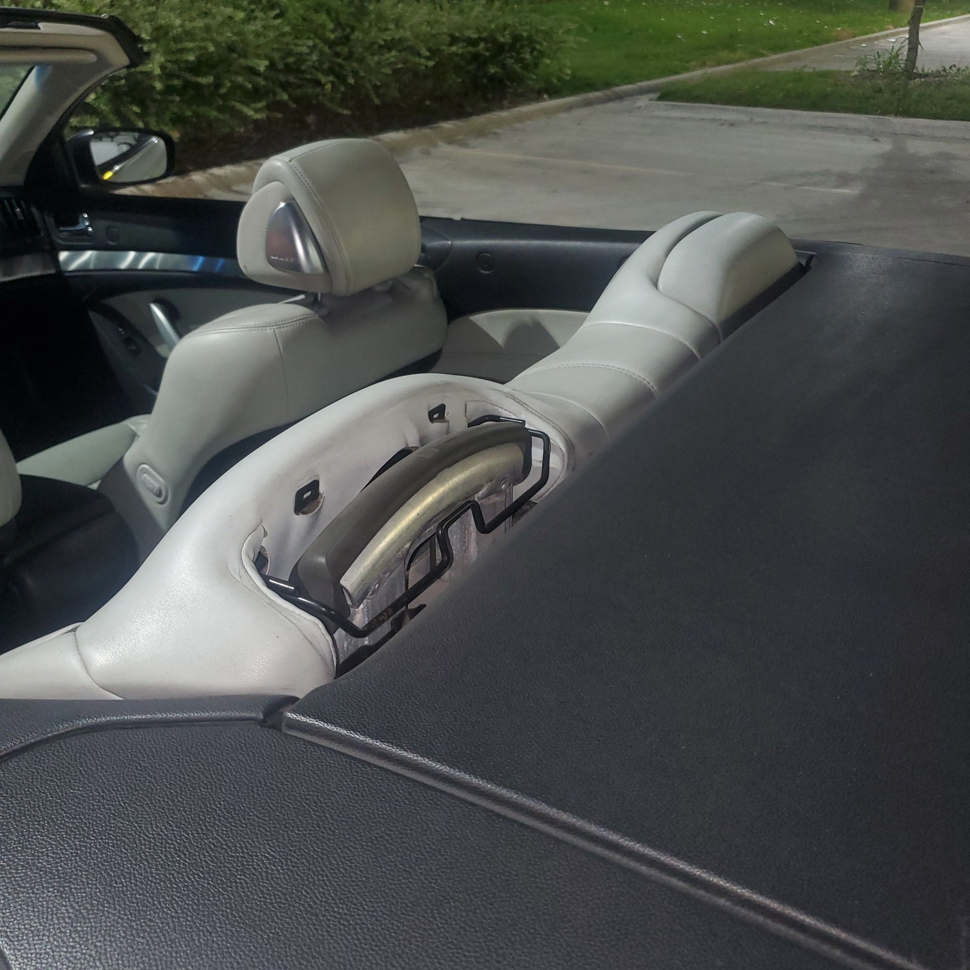

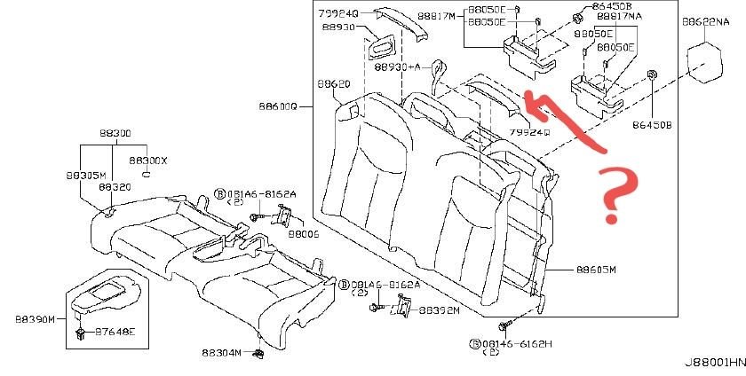

Hi I have a '10 Sport convertible and recently discovered that the back of the driver's side rear headrest is missing. I don't know if it was never there when I bought it or if someone took it but regardless, it makes me sad that the back view is uneven due to this being gone. I have looked EVERYWHERE I can think of to find the part name/number so I can order a replacement but for the life of me can't even find a diagram of it on a site, much less the correct name for it to explain to Google how to search. Unfortunately no junk yard places even have the car to part it so I'm kinda stuck. Does anyone know where/ how to find the part name or number? My seat interior is white/grey just like the picture but I can always get it reupholstered as long as I find the part. Thanks!
It's the back half of the rear headrest
It's the circled part, the back half of the rear headrest

Can you provide a closer picture to the area where the piece is missing? I'm trying to visualize what is missing to the parts diagram....

This is a picture of the missing piece when the top is down. You can't see any of it with the top up.
It's this back half part of the rear seat. It's just a plastic cover from what i can tell but i can't seem to find the name of it or the part number

ILM-NC G37S is correct on the part he circled.

That appears to be the piece. Thanks Said Amir.
Patti, did you check on the floor and in the trunk for that piece? I find it hard to believe someone would rip that off. These pieces are lightly clipped into place as they are designed to immediately pop off in the event of a rollover collision (you can see where the SRS rollbar sits)
I'm wondering if the roof operation may have somehow snagged that piece or, if the wind somehow grabbed it off... just thinking out loud.
I would check the other one to make sure it is tight and secure, just to be safe.
Either way, glad to see this part is available and not ridiculously overpriced.
