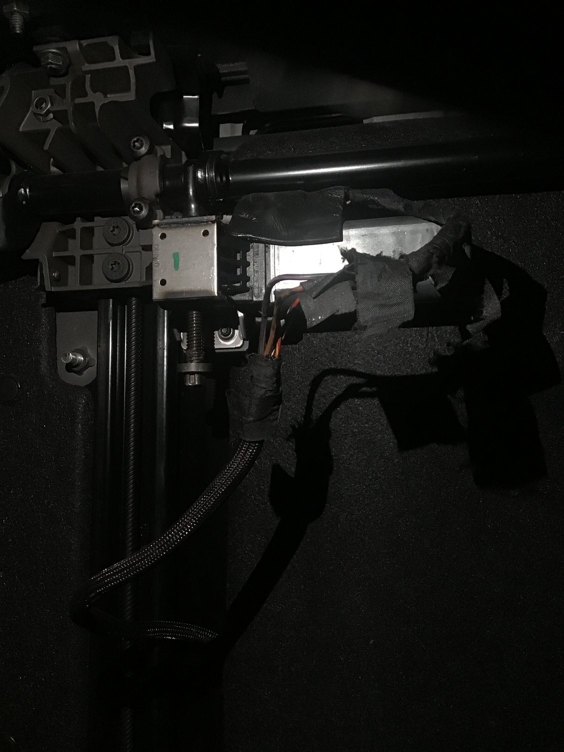

I had a similar problem. I found that the wiring of the top on the drivers side had gotten loose and rubbed through the covering of the harness and exposed some wires. Taped it up and haven't had a problem for 2 years now. Knock on wood.

Can you see the wires with the top up or do you have to retract the top to see them?

I had the top partially open/closed. The wires are on the drivers side. I left the car running when I did this as others have reported that their tops would get stuck if stopped mid-cycle.
OMG!!! that luck's VERY BAD!!!
Check for any crushed wire there.Isolate and secure the wires in place so they don't get crushed again.
