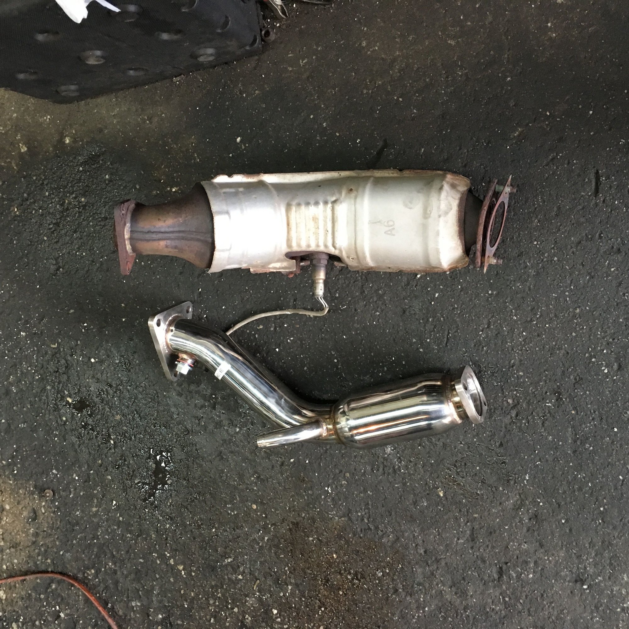

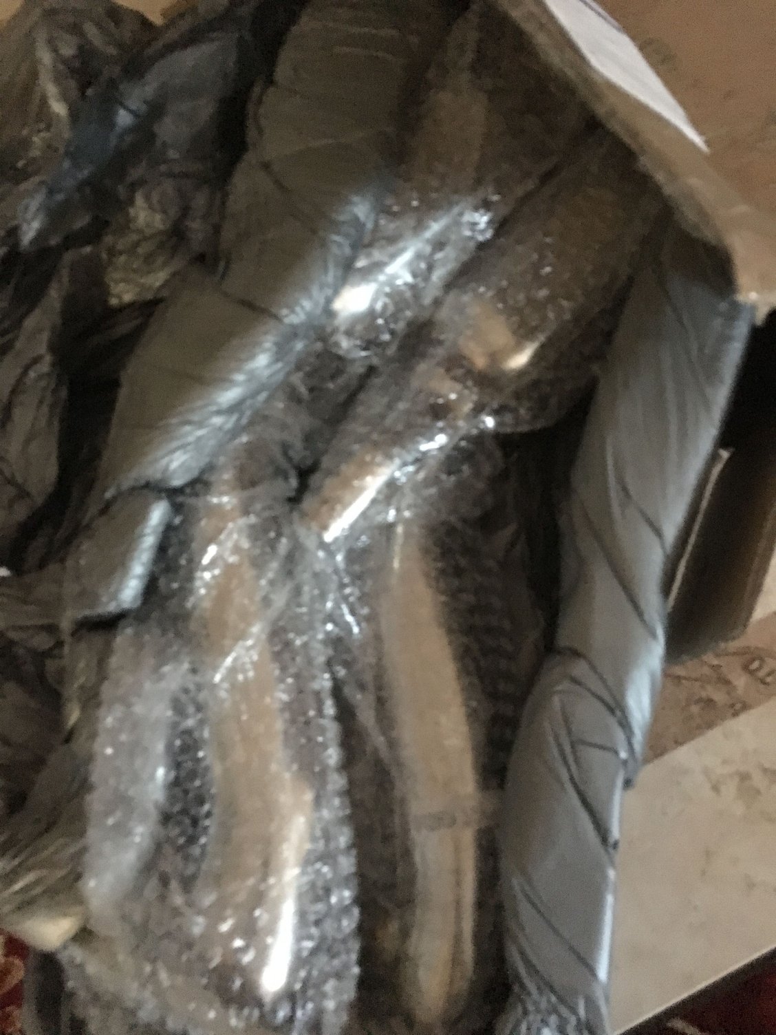

I got them a few days ago. Haven't had the time to install yet but I did get a quote for $240. Once the mechanic lifted the car, he changed his mind and said $300. He says the bolts are rusted to hell and will be hard to remove. I will go elsewhere sometime this week. Here they are:

Finally got these installed today. This is the only mod done to this car. The reason for them was primarily to get rid of the rattle that the OEM cats were causing. I thought it was the heat shield but it wasn't. Anyway, the CEL hasn't come on and I've driven 100 miles so far. The sound is very close to the sound of a stock G37 coupe. The only thing I would have to say I don't like is the hiss, but that comes with having test pipes. I had a G35 sedan prior to this with test pipes and full exhaust so I am all too familiar with the sound and smell. I don't feel a huge difference in acceleration, although time will tell. The only way I'll know for sure is when I take it to Island Dragway in a couple of weeks. On to the pics! Vid to come soon
