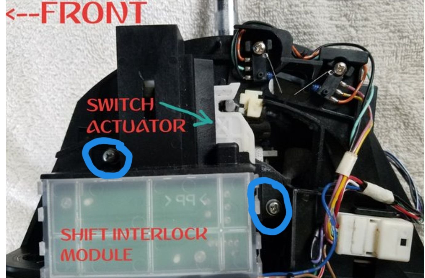

The two screws are circled in blue:
There is also a small wiring connector at the bottom of the module.
It might be helpful to remove the center console to gain access as it is a very tight working space. If you are not careful you will drop one those screws into the abyss below.
Once removed you can check the interlock for signs of dirt, wear, and get everything greased back up. Again, that actuator slide should move without any resistance once the manual button is pressed down.
Installation is the reverse of removal- just make sure the metal tab slides onto the actuator slide (green arrow).
