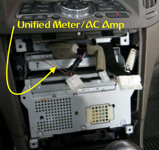

Where is the ac amp
Dumb question but where do I find that set of terminals I saw behind the centre console but does anyone have a pic of what it looks like thanks ?

What exactly are you looking for???

hey I’m looking for the wiring harness that I put my paddle shifter wires into like the ac amp just curious where it is in the car

The wires from the paddles go the Unified Meter/ AC Amp which is located behind the preset switch panel (the clock one):
Is this what you needed/ wanted?
Friendly advice, make sure battery is disconnected prior to working on any electrics AND, mark each connector as you disconnect them to ensure you put them back in the proper location. It is VERY easy to mix up some of the connectors in that center stack which can brick the car.
thanks so much I truly appreciate it

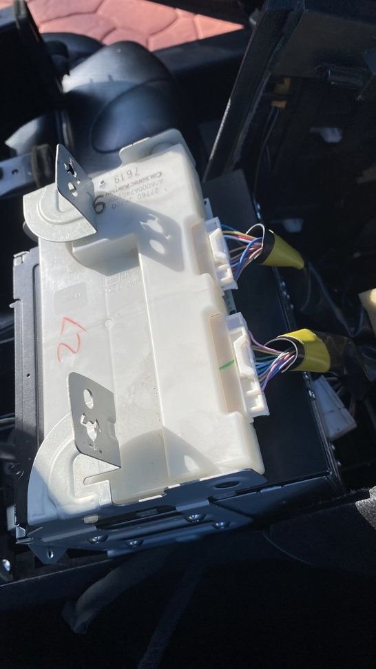

Just wanted to chime back in here in case it helps anyone else. I have a 2010 base convertible that didn't come pre-wired for paddle shifters. I purchased a custom wiring harness from an InfinitScene forums user "Rex" and completed the entire installation in 1hr 45minutes. It cost me $139 to have the wiring harness built and shipped from Taiwan to NC.
For reference, I'm not a very handy individual. The most intense installation I've ever done before this was a Stillen Gen3 CAI. You basically just plug in the white connector from the harness below into the back of your unified meter and a/c amp harness located behind the center control stack with the clock, volume and climate control dials. Follow all of ILM-NC G37S's instructions to get there. This solution worked best for me because it was "plug and play" once I got the harness from Rex. You can reach Rex by email at rex0926@ms89.url.com.tw
