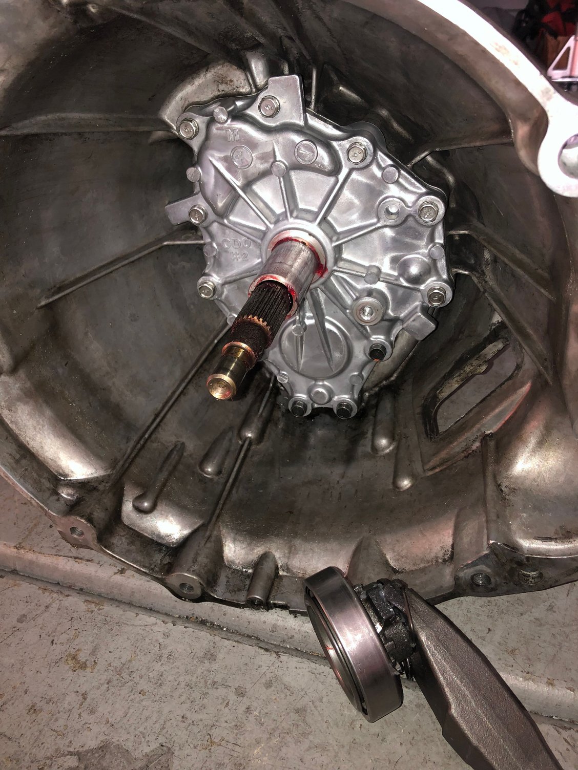

Going into conclusion that after sufficiently bleeding the clutch fluid, I am going to detach the transmission again to recalculate the stack heigh and add more shims.
Clutch pedal relaxed. (Close to the front of the window)
No pressure applied. (1mm of air between the bearing and pressure plate)
Full pressure applied to the clutch pedal. (Pressure plate hardly flexes, preventing even going into gear when ignition is on)

i figured it out after dropping the transmission. I calculated the stack height wrong at first by 1.5mm of shim. I originally calculated that I needed 3.5mm of shim on the pivot ball, then adjusted it to 2mm of shim. An accurate digital caliper did the work for me.
Now the kit is working flawlessly after bleeding it. No issues so far after a week of driving.
Exedy clutch kit/AASCO lightweight flywheel.
I literally dropped the transmission. Lol
Took out the pivot ball to adjust the shim.
Clutch throw after adjusting.
