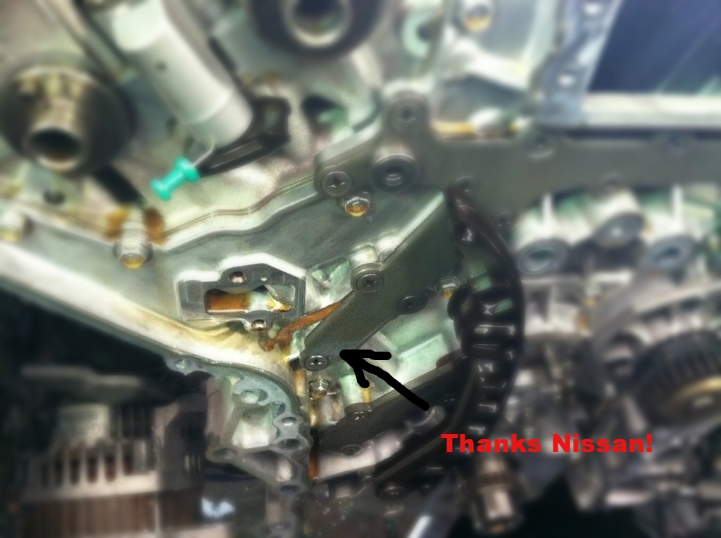

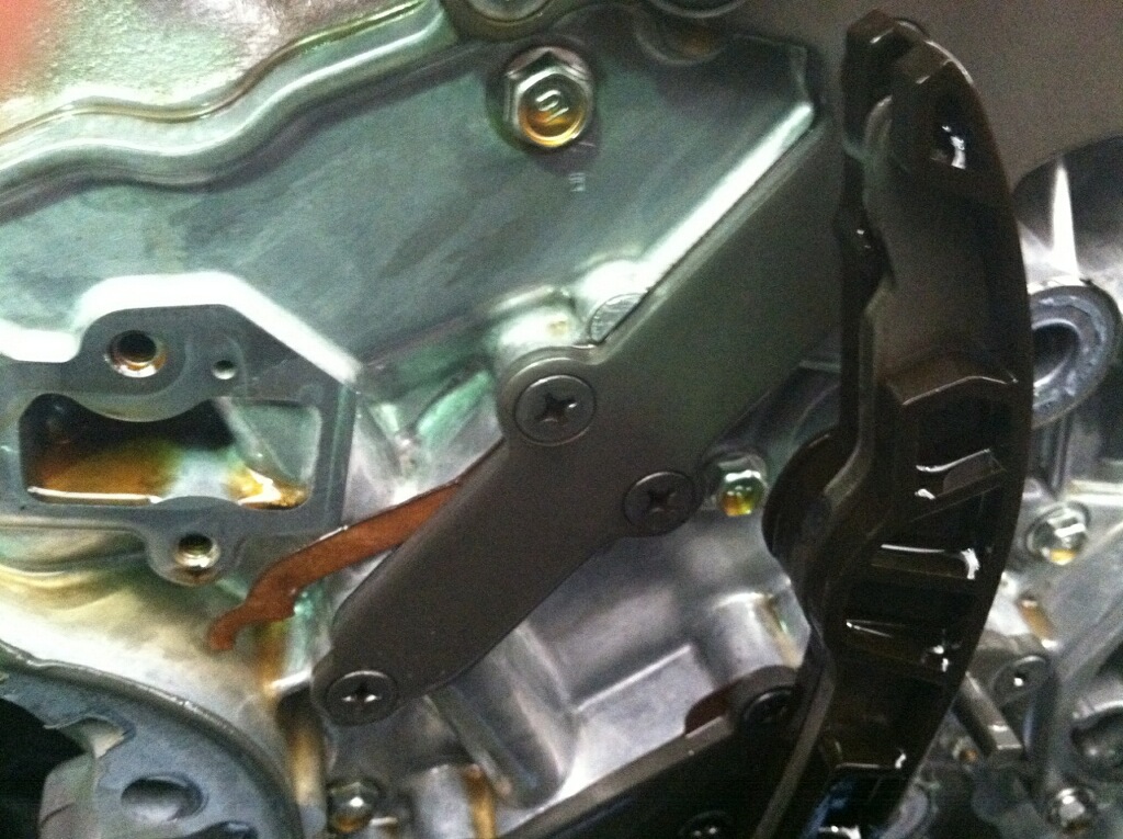

The cleanliness or lack thereof of the engine is not what causes this unfortunately. Yours is sludgy. Mine was clean enough to eat of of.

It's hard to tell but I don't see any broken gasket on his.

From: GA
They are hard to see, but it looks like there are 2 cracks in the main galley gasket. Looks like one running kinda vertical off the leg that goes down, and the other running up on the right side from the first lower bolt.

Victory, ask them if they can remove those gaskets and show you them
