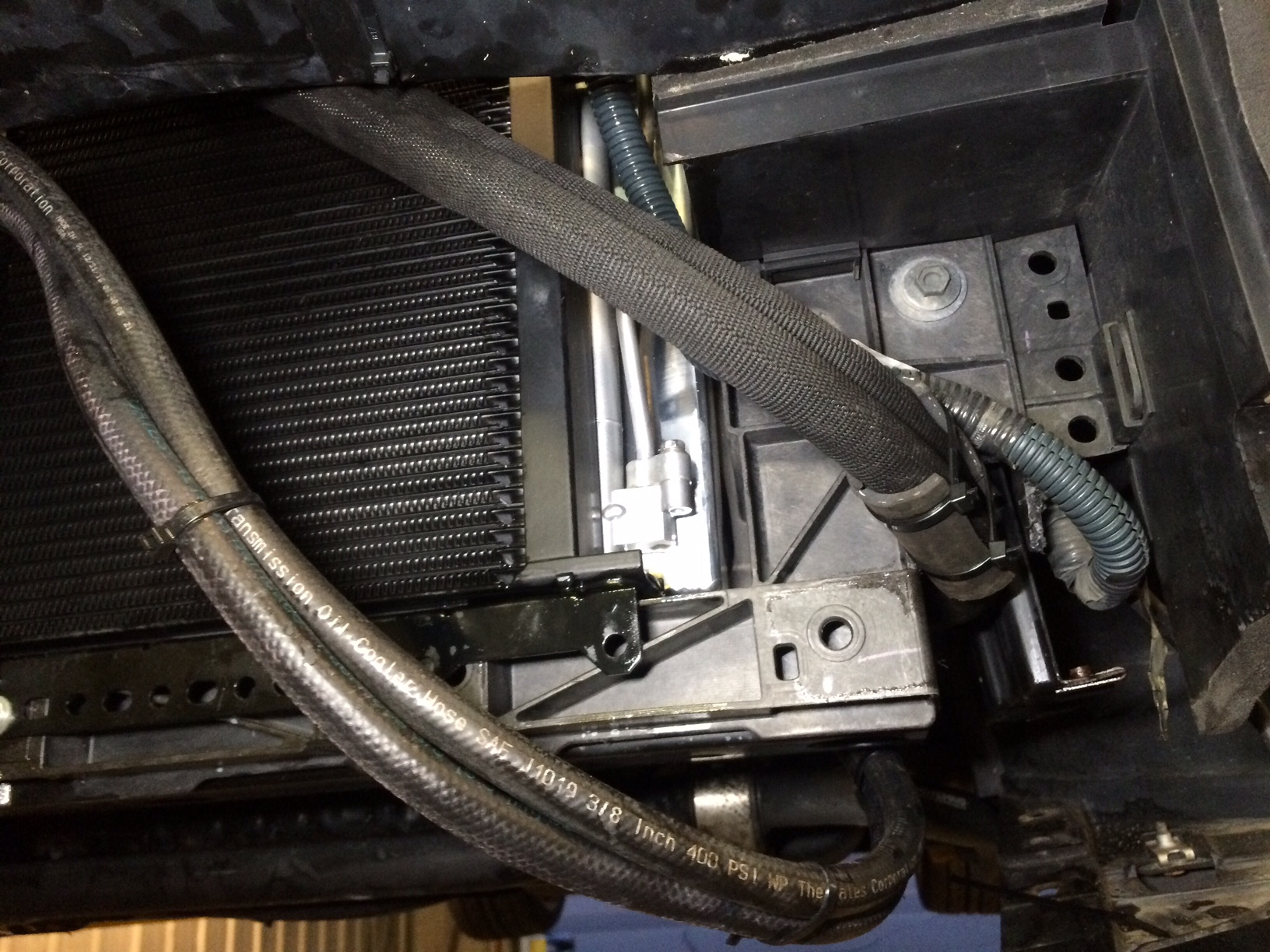

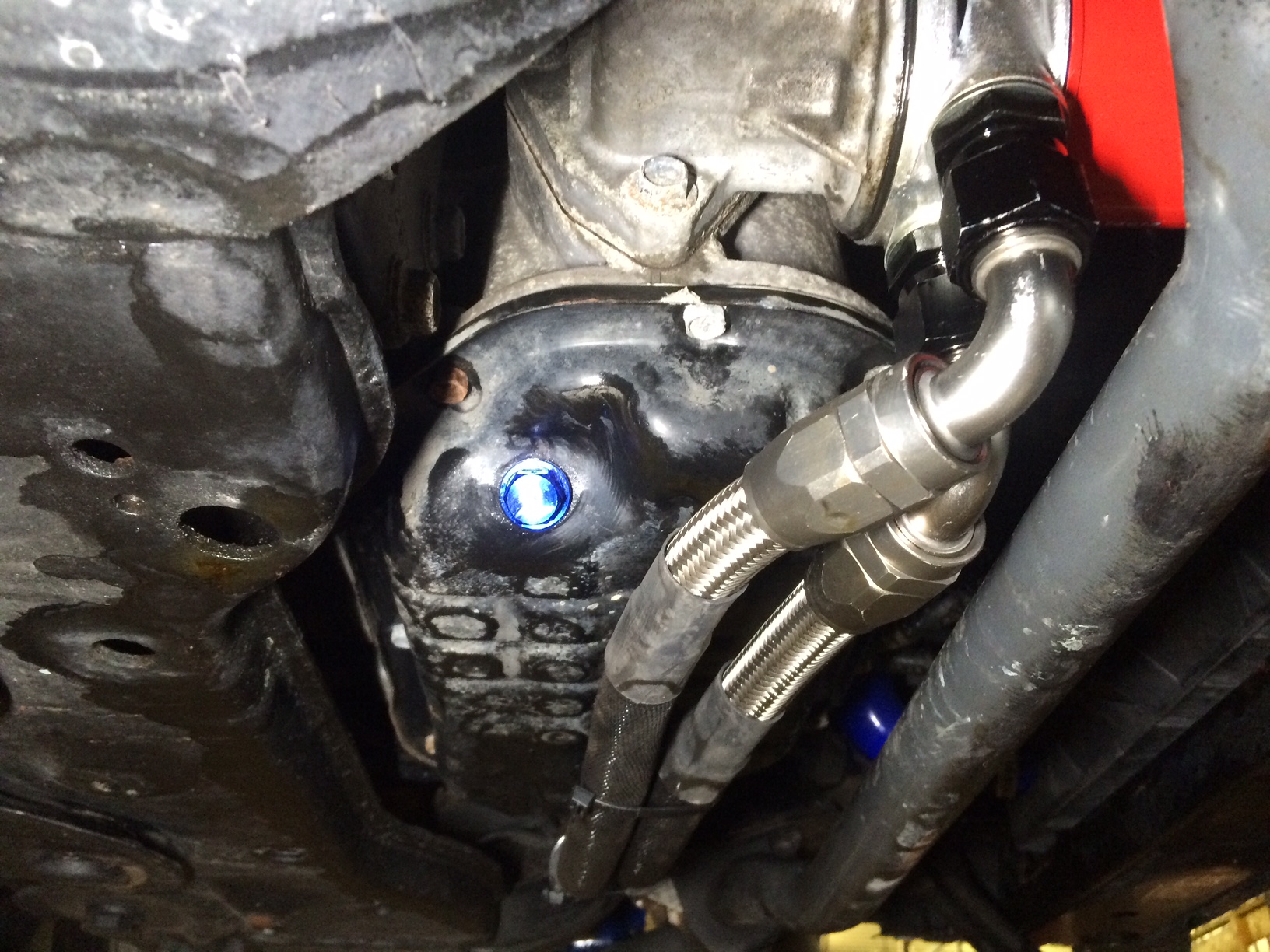

Upscale Speed's Avatar
Upscale Speed
iTrader: (18)
Joined: Aug 2014
Posts: 923
Likes: 120
From: Springvale, ME
See pics of my install. It turned out fine after Mike's advice.
Attached Thumbnails Z1 oil cooler install issues AWD-img_2075.jpg   Z1 oil cooler install issues AWD-img_2080.jpg   Z1 oil cooler install issues AWD-img_2084.jpg   Z1 oil cooler install issues AWD-img_2085.jpg

^^ Thanx LOVE The Z1 drain plug, You'll have to keep an eye on the fittings at the plate mine seap, almost all the time. I check them every oil change. But again I bet this is just "my" considering I can't get anything done right :/. LOL
