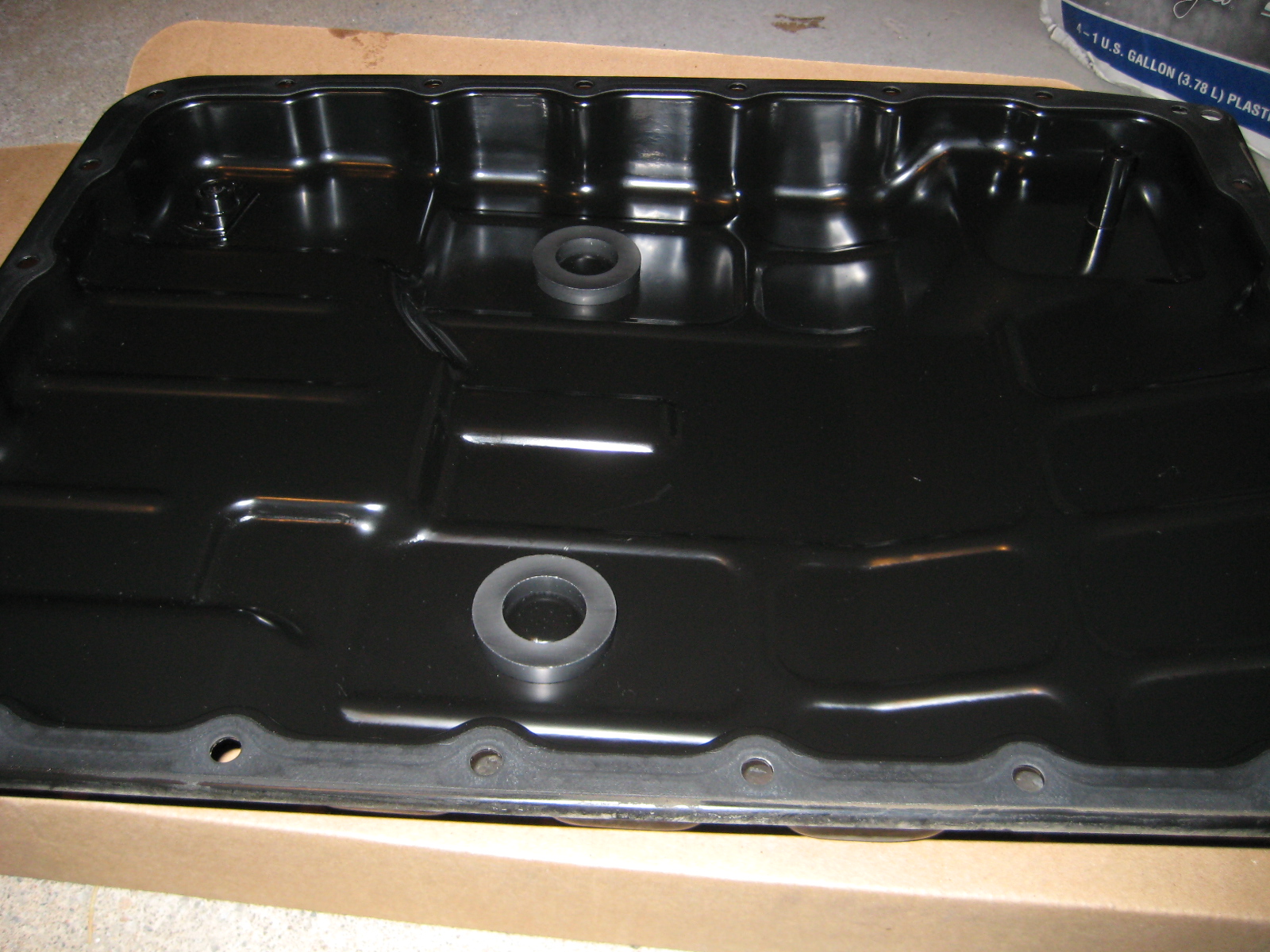

Fill plug should be on passenger side and drain is at the bottom of course. The process is very much straightforward and since you have experience working on a car, this will be a breeze.

Actually the fill and the drain are both on the bottom, here's a pic of the inside of the clean pan.
You are correct. I was thinking about 6MT which the filler plug is to the side. 7AT will have be at the bottom.
P.267 will provide instructions.
http://www.nicoclub.com/FSM/G37/Sedan/2011/TM.pdf
