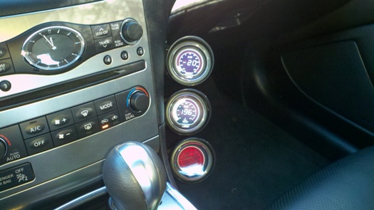

Pong where did you install your gauge pod? Any pics to help me? I'm getting mine installed starting Friday into next week.

ANMVQ's Avatar
ANMVQ
Joined: Dec 2009
Posts: 6,098
Likes: 396
From: Framingham Ma,
I had mine here Nice hidding spot
