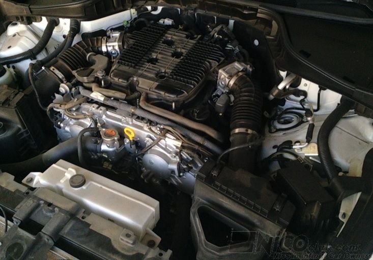

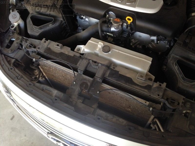

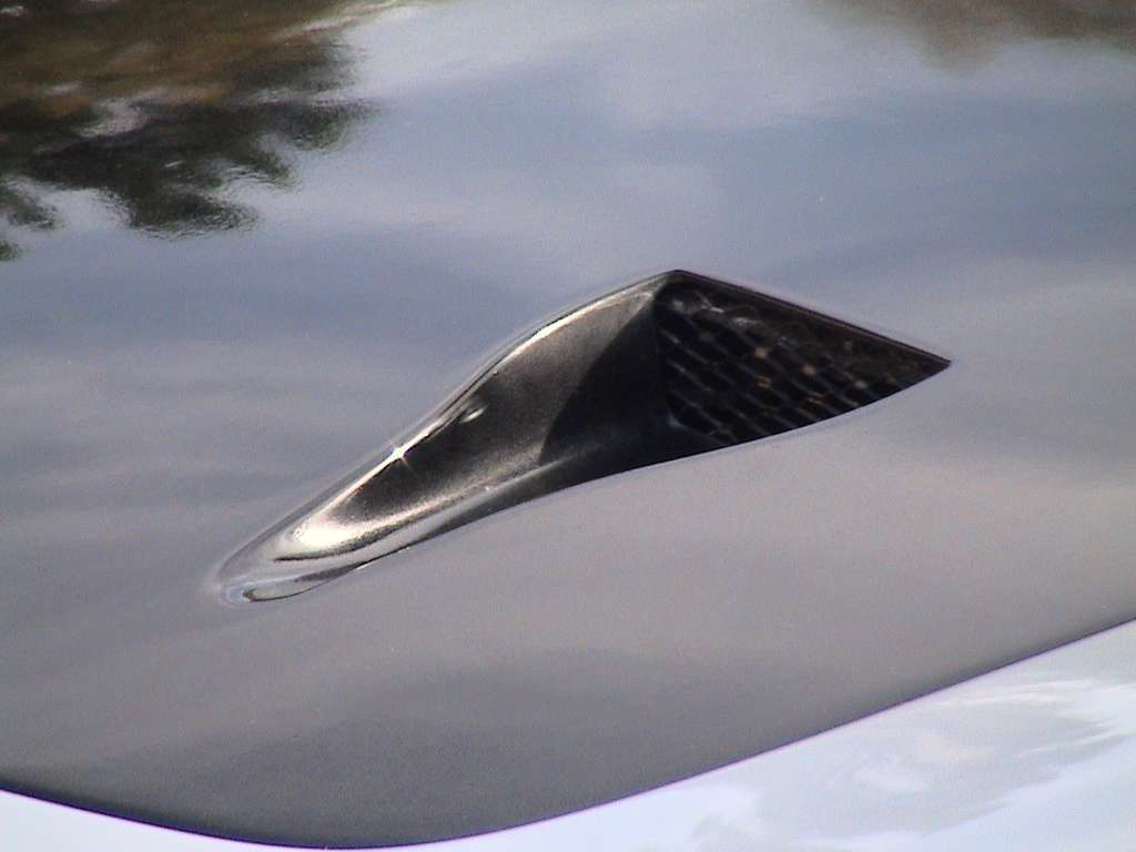

There are some NACA ducts which serve as air intake. It would help more along with the existing intake.
Here are some pics to make things clear.
This is an air intake box for the M37. I would cut the stock box on the upper portion to open another inlet port Just like in the pics. Then the NACA scoop outlet will go into the open port with sealing it to only get air from outside of the engine bay.
This will help more the stock setup with aFe drop ins and some post maf silicone intake hoses.
