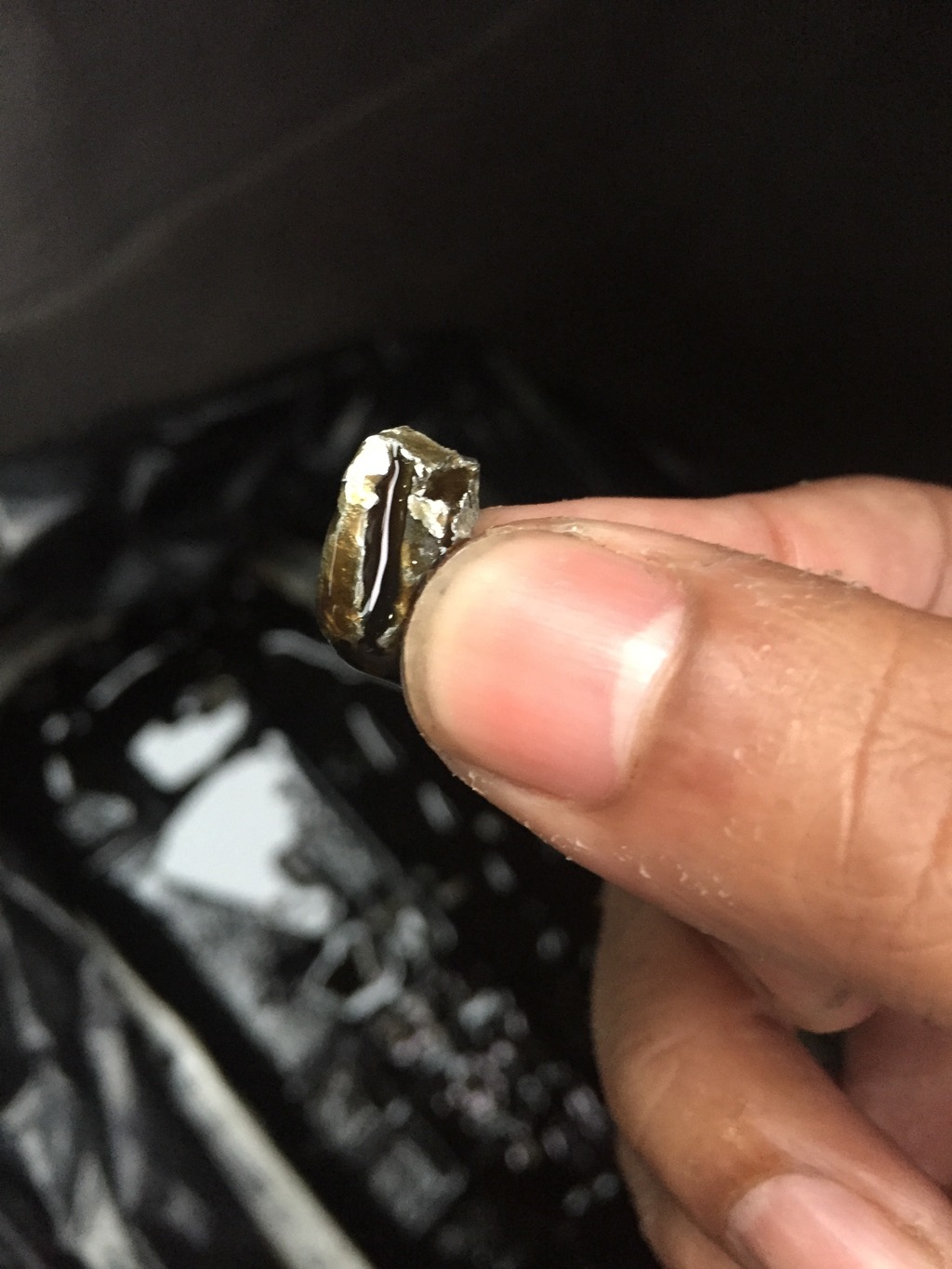

So after doing a compression test and getting 0 on all 6 cylinders i decided to take the crankcase cover off. i had to drop the oil pan to get to the last to bolts and i noticed shards and pieces of what looks like oil sprayers and bigger chunkier pieces. whatever broke is most likely the problem of why i am not having compression now to figure out where these pieces came from !

So finally i got some good news the compression issue is now fixed the timing was thrown off really bad intake valves are all good but i cant see the exhaust valves fingers crossed they are okay! now as for the what caused the timing jump i have two theory's i know for sure that the the tensioner had something to do with it [Marked with the red arrow]. Now if you look at by bank two with the [green arrow] that cardboard type gasket blew out. Now i am not to sure what that is can anyone chime in on what that exactly is? in the youtube video the number one spark plug was out

That is the infamous oil gallery gasket.
Read here:
https://www.myg37.com/forums/g37-cou...xperience.html
Cause for the dreaded P0011/P0021 codes that everyone is curious about - G35Driver
The oil gallery passes oil under tremendous pressure up to the cam sprockets to actuate the valve timing advance, as well as timing chain tension. When it leaks badly, you basically have little to no oil pressure at idle, and not nearly enough even while revving to properly operate the variable valve timing, let alone proper chain tension. If you did jump a tooth, I have no doubt this contributed to it.
The fact that you've been running the car with FI while your gasket was blown out is troubling to say the least. And the fact that you were actually boosting it in third gear to show (off?) a friend when it actually died makes me fear your motor could be toast. Of course, all that metal down there in the pan certainly adds a fairly loud testimony to that prospect as well.
Sorry man, but I think you might have bought it on this one.
Maybe, just maybe, if it shut down the instant everything broke, you didn't circulate any metal though the bearings. Fingers crossed for you man.
EDIT: check out page LU-2 here: http://www.nicoclub.com/FSM/G37/Sedan/2010/LU.pdf

thanks for you help and all the information i really appreciate it. i am doing a full wash down to get out whatever i can out of the block. i have my finger crossed i will be okay. i did buy a another used engine and decided to start building that one slowly
