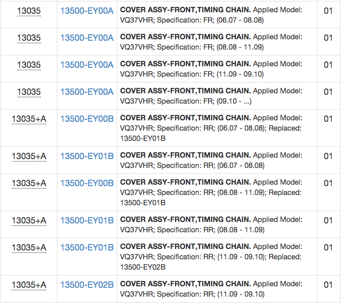

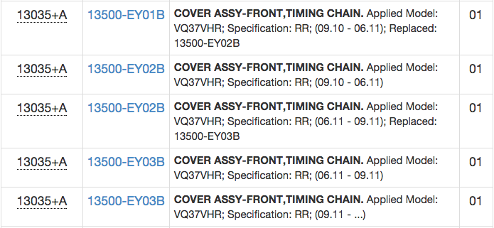

I just traced the part number of the "revised" gasket that was torn down in the main thread for this, part # 13533-JK21B and the application for that part was the EX35 and FX35 and the VQ35HR engine. It's not a new part at all. I am very confused now.
Old Mar 4, 2015 | 12:00 PM
Ryne's Avatar
Ryne
The Steering Wheel Guy
Posts: 3,111
Likes: 561
From: Frankfort, IL
It does appear that the timing cover and gasket set has gone through several revisions though throughout the years. (13035+A includes the gaskets)
This makes me feel like anyone with a build date in 2012+ appears to be safe. It's likely that only one of these part numbers and build date ranges has the defective gaskets and I'm sure we have enough data here to narrow it down.
