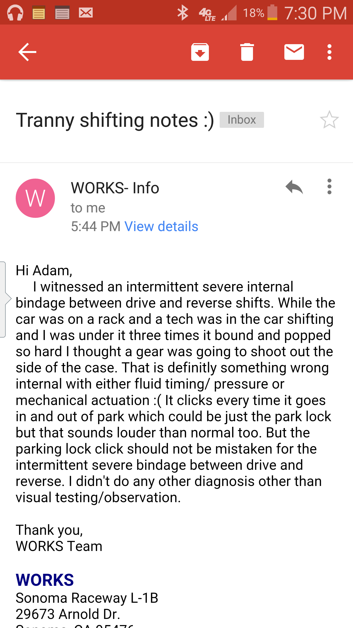

Man I'm glad to hear it wasn't the tranny on yours man......I definitely would have taken the driveshaft...glad you got yours sorted....I unfortunately didn't get the same news from my tune shop WORKS Motorsport. ...apparently I have some severe bindage going on...flashed my tune back to stock and took it in to the dealership...
