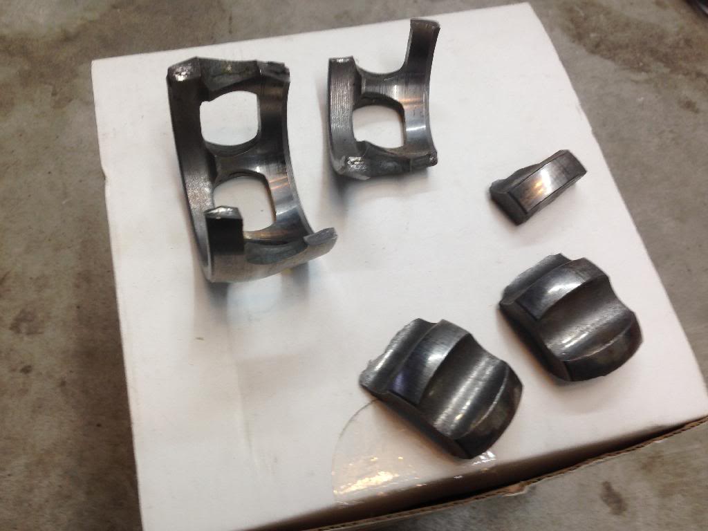

Join the club. I had to hold up track runs for the tow truck to come and pull me all the way to the end, they won't push a wounded car back after the next car has staged.
The good news is that it's not a difficult fix. You can find a used axle much cheaper than new (I paid about $125 I think) and it's not a difficult repair. Good luck.

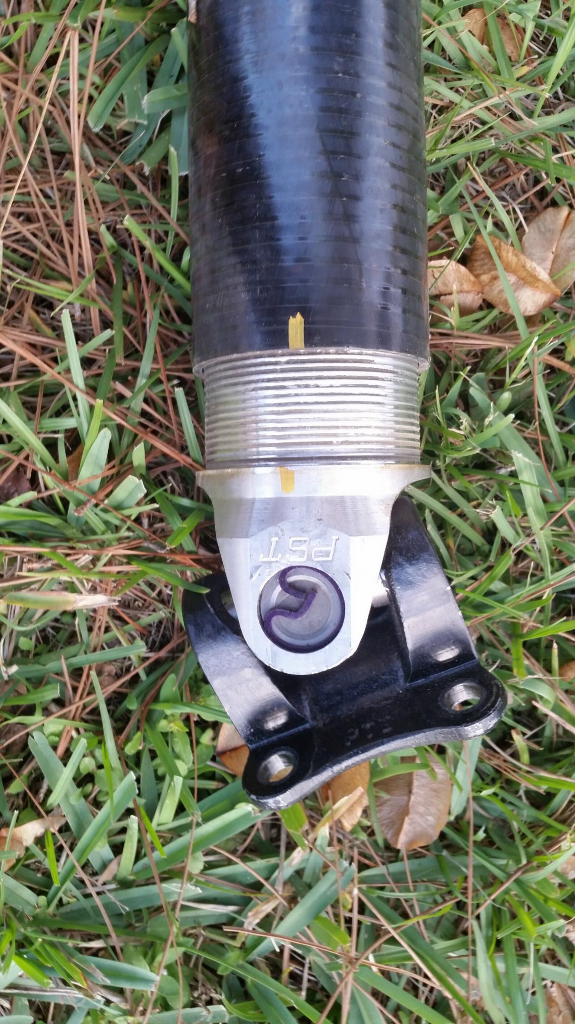

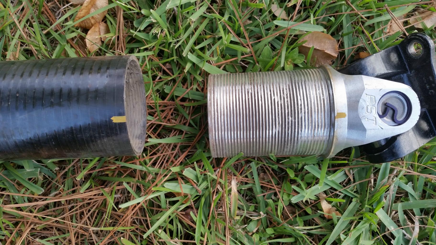

Well, it wasn't an axle. When prepping to remove the axle I happened to rotate the wheels. At the same time I noticed that the diff flange rotated the u joint but the carbon shaft remained static. I pulled the shaft towards the front and the shaft separated from the aluminum u joint. A quick call was made to PST and Mark said the quick way to see what he could do is to bring the shaft over to the shop. Today I took the 2 hour ride and let him take a look. From my layman view there was no damage to the carbon shaft and for all I could see it looked like the adhesive simply failed. I don't think my car is some Monday morning factory ringer and I seriously doubt I make anywhere near the rated failure torque of the driveshaft. Mark from PST was a pure gentleman and when I asked what he thought he said it wasn't clear but possibly a mistake during production or a bad batch of adhesive. He took my info to build a new shaft that should arrive tomorrow. Overall I feel like PST lived up to their reputation. Here's some pics.

When I finally do my swap I'm going with the aluminum ds. I don't trust the CF ones. That design doesn't look good the way the u-joint threads into the cf.
Glad they are standing up for their product though. Many companies these days wouldn't.

When I bought my driveshaft I looked for Aluminum and I don't think anyone will make them anymore. That u joint isn't threaded in, the grooves are to hold the adhesive. That's the way the adhesive manufacturers recommend. However Nissan uses a smooth bore and driveshaft shop followed their lead. PST handled my case just the way I'd expect a stand up company to do. If they were perfect we probably couldn't afford to buy from them.
