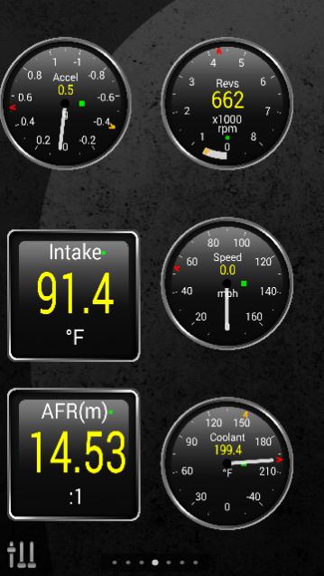

Anybody have AFR numbers with Intake,HFC,Exhaust without a tune? I have searched a million times and cannot find anything specific to those mods and the AFR results.
Old Jan 29, 2015 | 12:55 PM
PongSanity's Avatar
PongSanity
Posts: 996
Likes: 129
Cai, hfc, uim, cbe, no tune. Off my torque app on idle few weeks ago.
Old Feb 1, 2015 | 12:33 PM
briang37's Avatar
briang37
Joined: Mar 2014
Posts: 68
Lol interesting, I forgot I have that app
