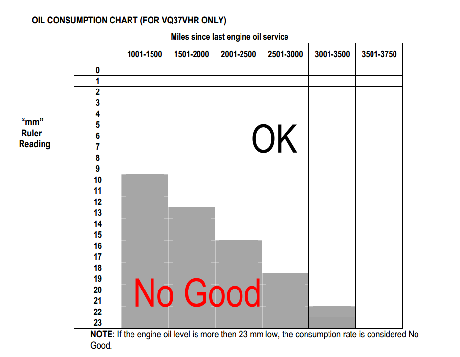

Here's a useful pic from the pdf clutchfan posted.
Left column is how low in mm the oil level is from the full mark, horizontal axis is mileage. No good is considered excessive. For 3500 miles since last oil change, 21mm (apprx 13/16") is considered acceptable.

Thanks Solo ^^^
Both our Gs (07 & 09) never more than a mm or two below the top mark on the stick, total miles between the two is now about 185k.

You're welcome. Just call me Jay. Solo is part of my last name
Impressive with the oil consumption at 185K miles. My consumption above was from a few road trips that involved some sustained revving of the engine (3-5K rpm) on the twisty backroads. I was about 5mm low when I returned from the trip. Similar past road trips had minimal if any oil consumption.
Compared to my old camaro which needed a quart every 300-400 miles, I can live with a pint every 3K
