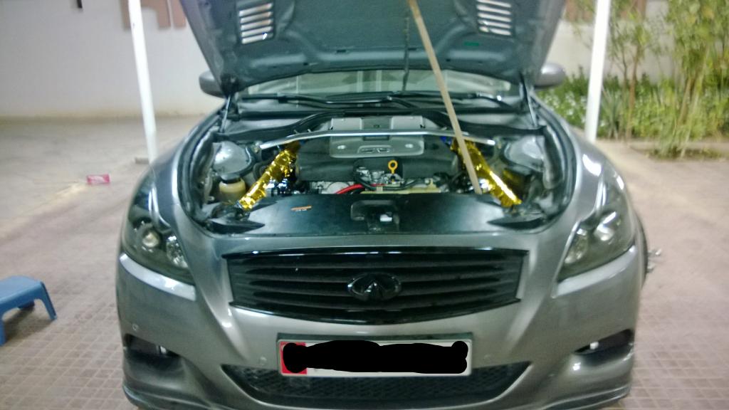

I have it and it does as advertised.
I can put my hands on my intakes with no issue lol.
Did you put more than one layer on the pipes? My intakes are not too hot after a drive but when it sits on traffic they still get hot.
