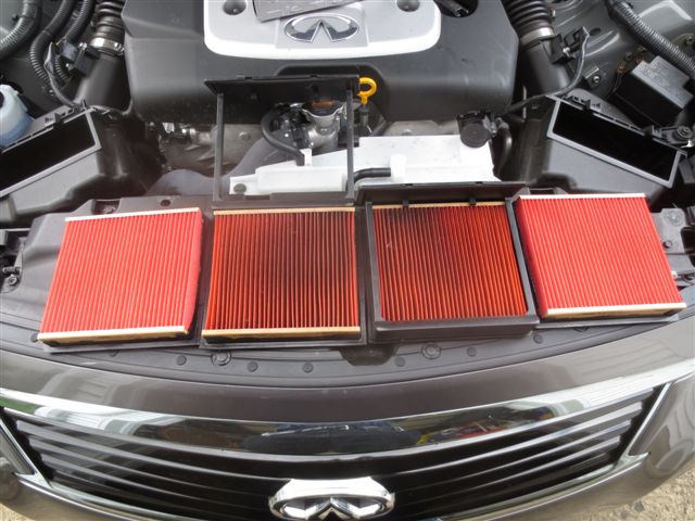

I check mine after about 8k miles and replace them between 8-10k miles depending on how dirty they are.
