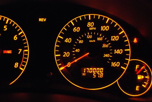

Originally Posted by jdubg37
If I'm in second gear or 3rd or 4th or 5th and cruising and I step on the gas the Rpm's go up about 2k then drop back down and car grabs and takes off. But If I floor it starting in first gear and go through the gears it doesn't slip at all. What do you guys think It is
If driven properly a clutch in a MT should last 200k miles
My 06 G35 just before trade in still on the original clutch.
No slipee
Telcoman
