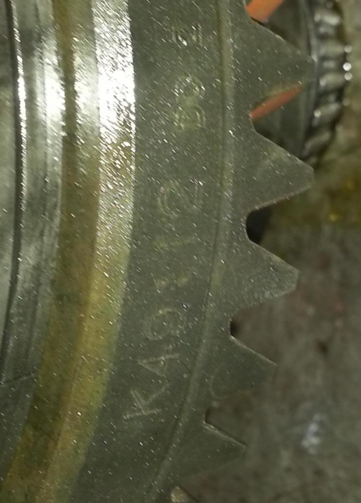

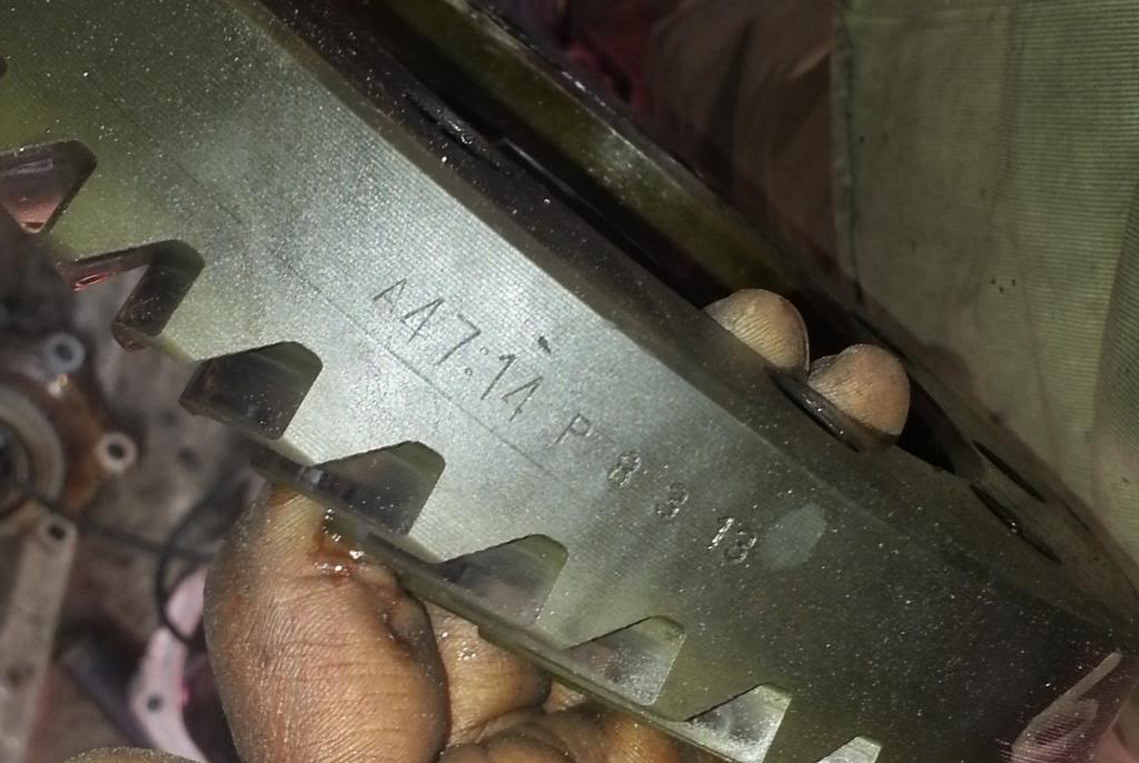

I finally pulled my OEM Ring & Pinion out. My fellow 5 speeders, I got some bad news for you:
This was pulled out of my OEM diff. It shows that the Ring has 47 teeth, and the Pinion has 14 teeth. If you do the math, that's a ratio of 3.357:1. Every online resource I came across showed 3.69:1 just like the MT but that is clearly not the case. I double checked with Nissan's technical department here and they have confirmed that it's a 3.357:1 not 3.69:1.
Luckily, this bad boy is going to replace it

OK! Well, it all makes sense even if the specs don't. At least you WILL get the increase you wish.
IS that the 4.08 set in the second photo? And.... what are you learning about jamming that in there.
