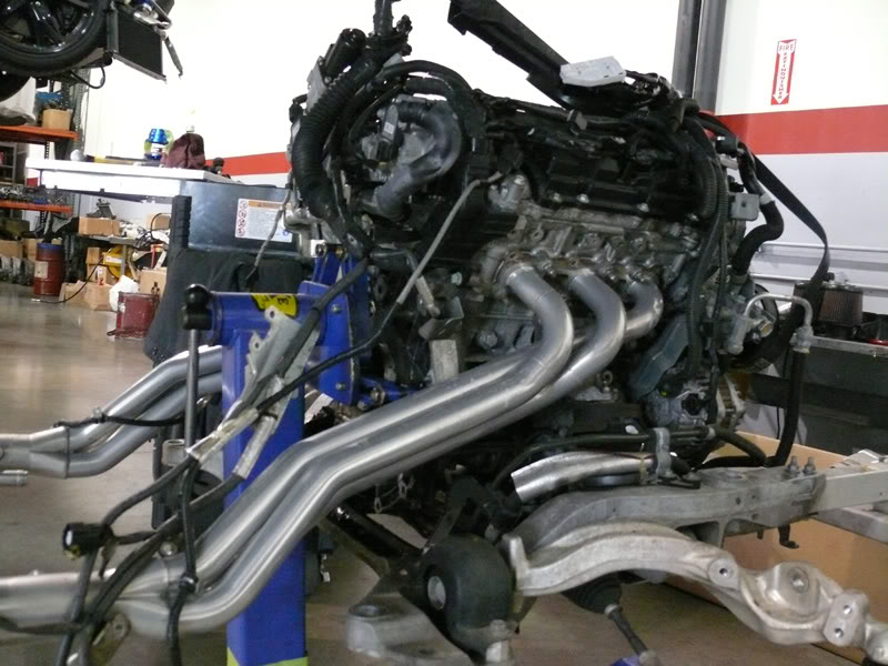

Phase 1: Engine Removal

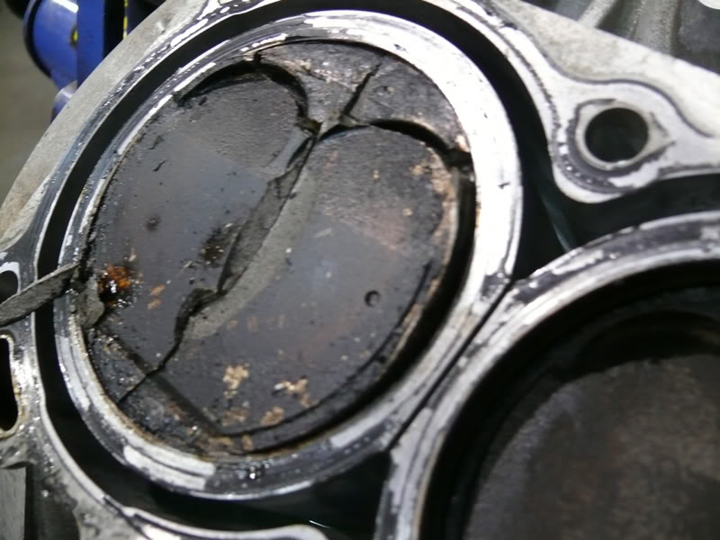

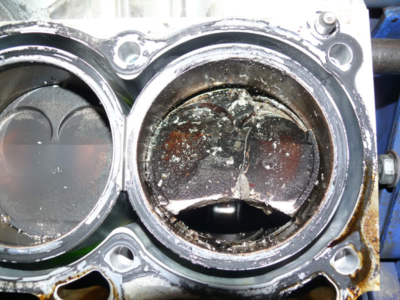

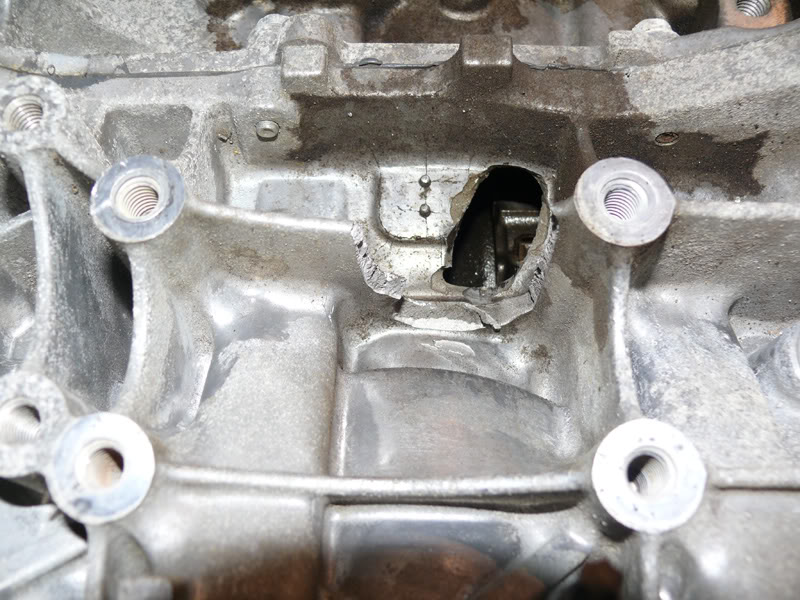

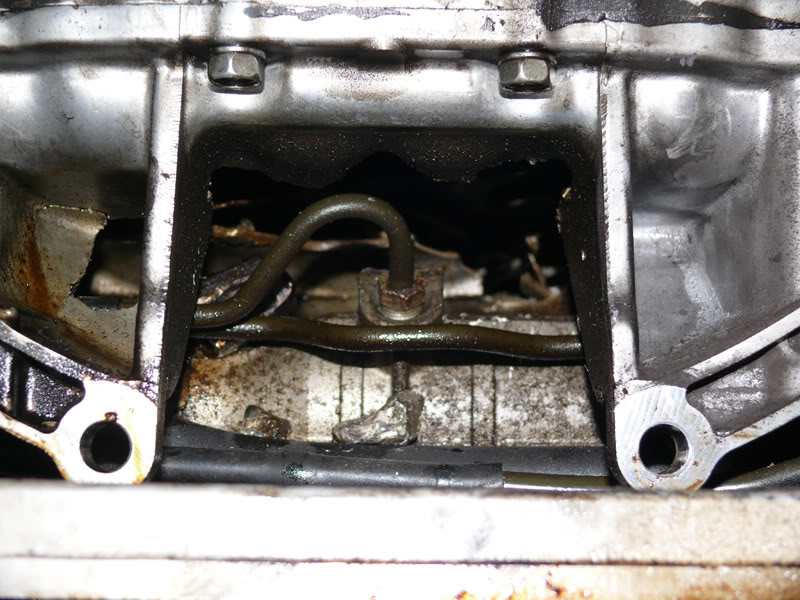

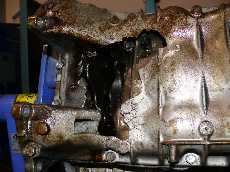

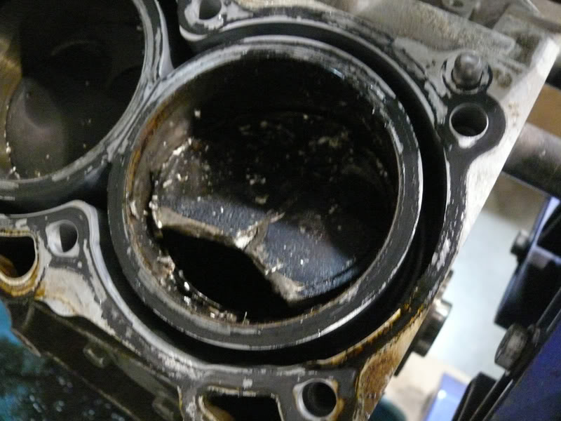

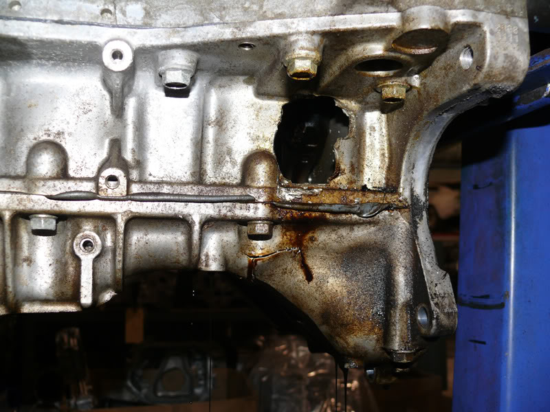

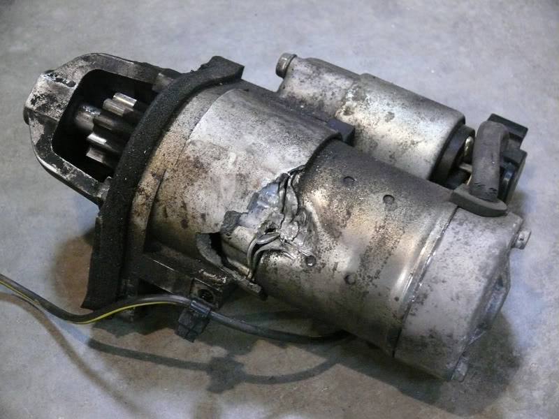

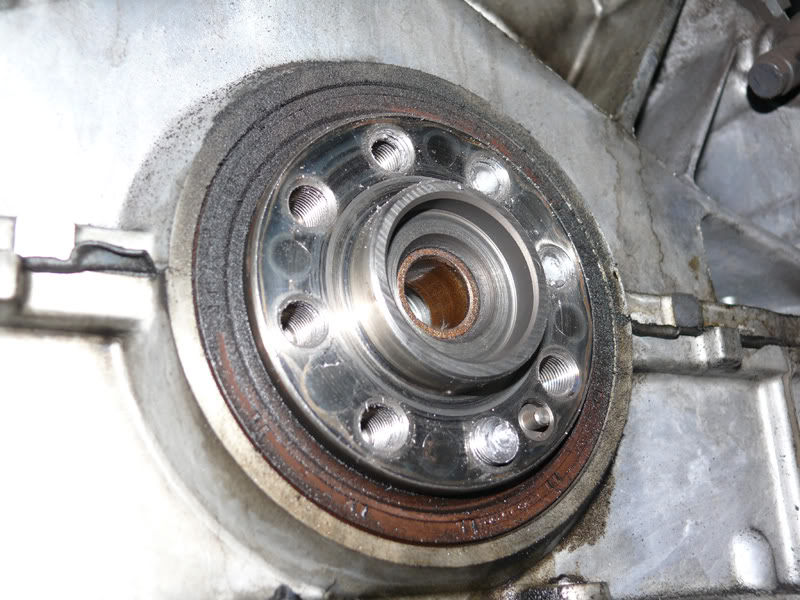

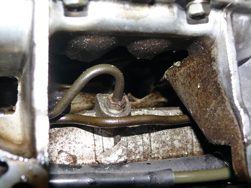

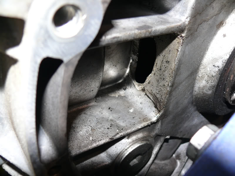

Since we are doing a twin turbo and an engine build at the same time, it makes good sense to drop the engine. After pulling the motor, we saw that it was completely unsalvageable. It is truly amazing how much damage that a catasrophic engine failure can cause. The block was completely destroyed, the starter was bent in half and the flywheel bolts were completely sheared off. Remember, this was an NA engine with breathing mods only.
Here are some pics of the aftermath.

Originally Posted by DashKid
WOW. CRAZY how did that happen? Seems like they got a chain saw that just hacked at that engine. WOW.
and an underdrive pulley
I don't think anybody is gonna know exactly what went on inside that motor before it blew up, but, it you know much about the subject, you'd know that "breathing mods" was the first clue. Probably was running lean and detonating, you don't need to be boosted for this to happen.
With all the members here that have done similar things, we may be seeing more of this in the near future.

Old Jun 1, 2012 | 08:13 PM
Sunny G's Avatar
Sunny G
Joined: Sep 2008
Posts: 1,020
Likes: 50
I'm going to go out on a limb here and say it had something to do with the pulley and long tube headers with no tune. The other mods not so much because they make the engine run lean but not so much that everything explodes like a megaton bomb.

Old Jun 1, 2012 | 09:59 PM
Staples's Avatar
Staples
Joined: Jun 2008
Posts: 1,659
From: Bel Air, MD
Could have been a number of things to cause the motor to go boom. I have seen the Stillen G3s matched with non-restrictive exhaust components throw lean codes.
Old Jun 2, 2012 | 12:14 AM
MSIZZLE's Avatar
MSIZZLE
Joined: Aug 2011
Posts: 37
i would look at the pulley as well, no way an intake and an exhaust should cause that
