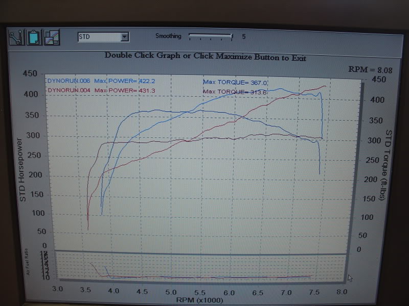

Old Oct 16, 2009 | 03:23 PM
  #116
Ivoidwarranties's Avatar
Ivoidwarranties
Joined: Nov 2008
Posts: 2,078
Likes: 29
From: Omaha
Can someone tell me what's going on here?
It looks like two different runs here. One tops out at 431 hp and the other at 422 hp. If that is the case I would want the 422 hp tune. Way way more area under the curve and a lot more useable power. Or am I looking at it wrong?
Old Oct 16, 2009 | 03:48 PM
  #117
Mike's Avatar
Mike
Joined: Feb 2008
Posts: 4,549
Likes: 20
Lowest boost level vs higher boost that tapers?
:shrug:
Old Oct 16, 2009 | 05:47 PM
  #118
Modme's Avatar
Modme
iTrader: (17)
Joined: Jun 2006
Posts: 1,585
Likes: 82
From: So Cal
Yeah, Sam was playing with the gain and response settings on the boost controller. But because my wastegates are opened prematurely, the car wont make more than 6 psi.
