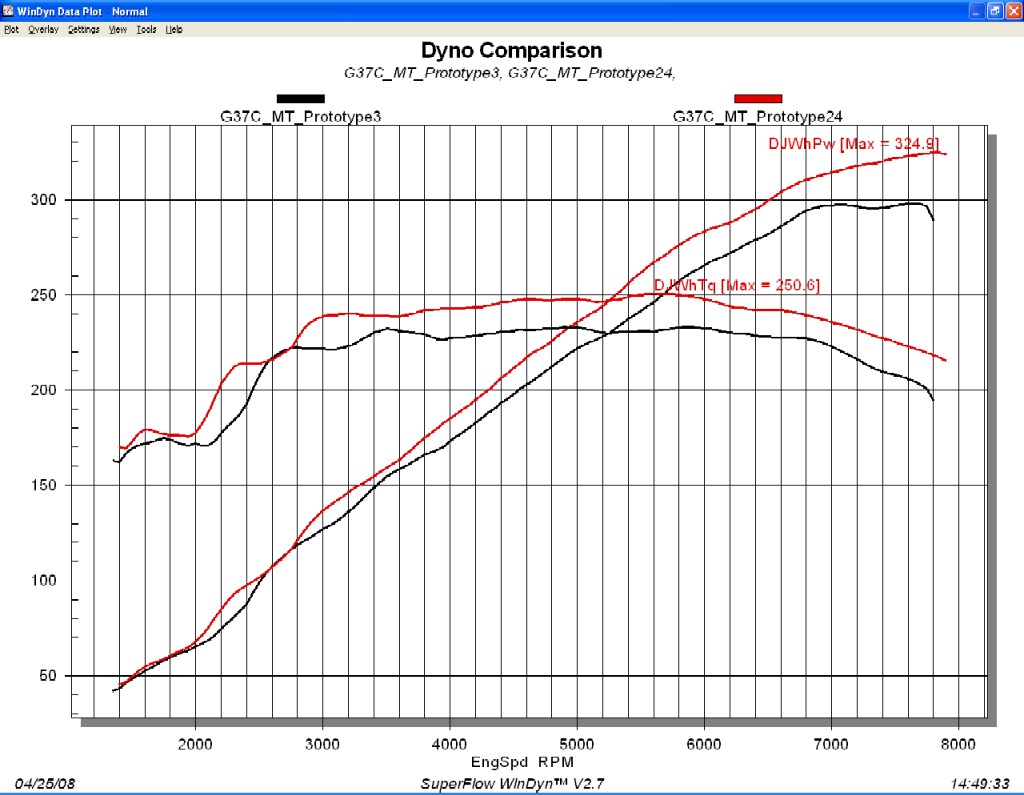

Now going purely off max HP it is as follows: And these are all Dyno Jet weighted numbers.
Stock ECU & Stock Air - 293 HP
Stock ECU & Fujita - 296 HP
Techno ECU & Stock air - 299 HP
Techno ECU & Fujita - 304 HP
Techno ECU, Fujita & HFC - 312 HP
ABOUT 21 HP GAIN
But the numbers are real misleading because they each peak at different RPM's and the gains in the mid-range are kind of different from the peaks. Like the Stock air box and the tuned ECU has a slight advantage in HP in the MID, until you hit 6900 RPM's them the Fujita and tuned ECU has more.
I don't see why you people are having a hard time interpreting these numbers. The tune gave 6-8 peak HP, and according to the poster boosted midrange HP and throttle response according to his seat of the pants. That's the best you can hope for from a tune on a modern NA car. Tuners can't get any peak HP out of NA BMW's anymore, just improve the midrange and throttle response. Sounds like Technosquare does a good job.

To all that may be interested, Technosquare just finished the Reflash for the G37Coupe MT Prototype car. The car came to us already with a prototype HKS Exhaust (which includes downpipe and mufflers), but stock cats, stock headers, and aftermarket intakes were installed.
Got some good strong numbers throughout the entire band, and the car now pulls all the way to the new Rev limit, which is 500 more than stock (although on the graph, it doesnt show it, but it is.) Things changed were Timing, A/F, throttle control, rev limiter raise and speed limiter removal.
TechnoSq is quite happy with the results on this prototype car, this was done using 91 California pump gas. 324.9 rwhp, 250.6 ft-lb torque....
93+ octane states could see a little more with more advanced timing...
If you have questions, please feel free to PM me (i'll try to check back often) or you can email me directly.. Chezee350 at Hotmail.com.
--Cheston
