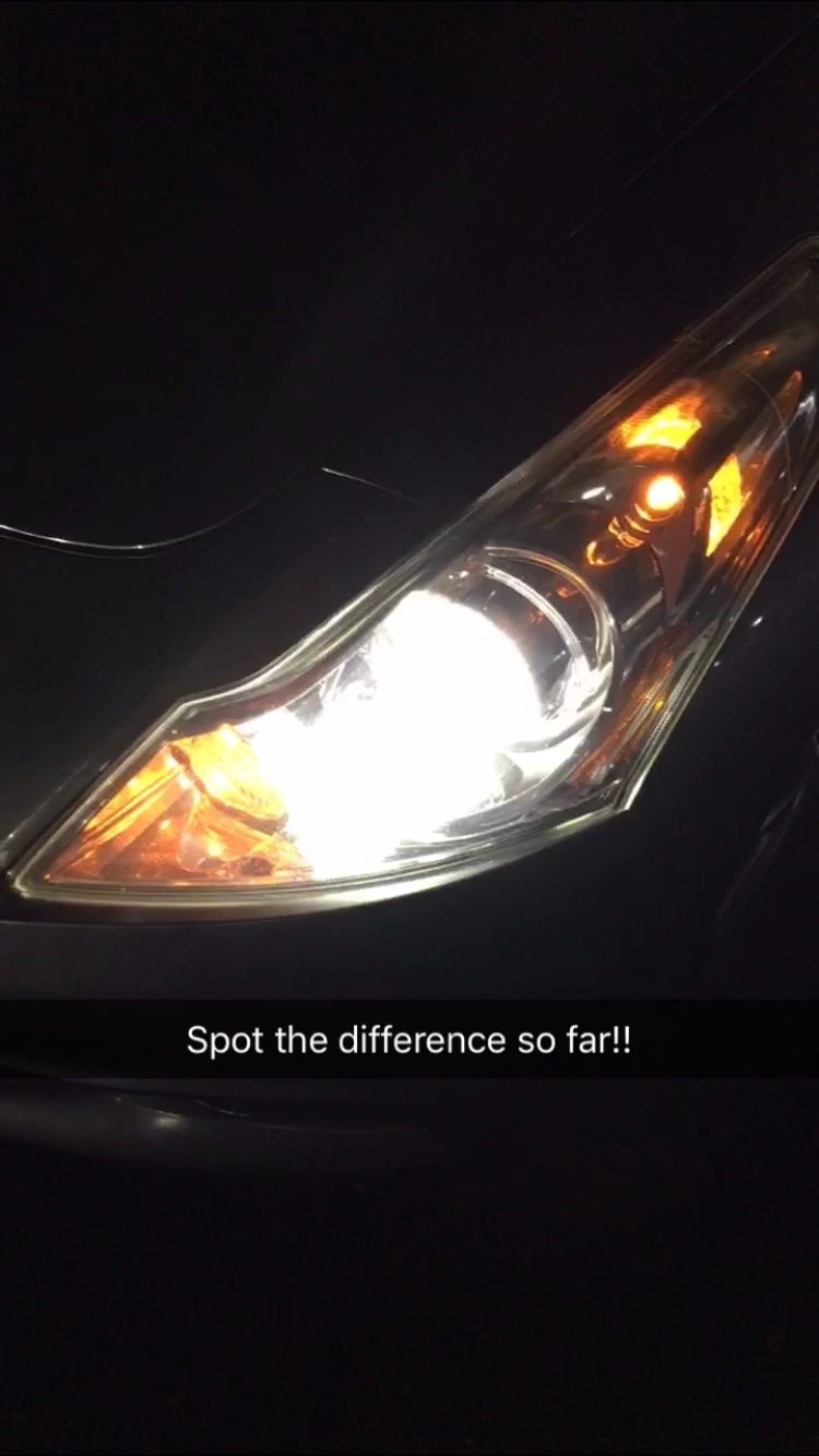

  • Switchback LED lights function as turn signals, except only turn the orange/amber color when you actually active your turn signals or hazard lights. The rest of the time they will glow a beautiful white, and make a great fix if you don't like the constant yellow from your sedan's headlights. Picture of mine below. The stock bulb is a 7444NA, whereas these are 7443 which fit perfectly.

    . Since you will likely be replacing with an LED, you do not have to worry about touching the LED since it is not sensitive in the same way a halogen bulb is. Photos below show the before and after of my headlights (taken from SnapChat so pardon the caption). Be sure to test the lights before you put it back, since even though the bulb will fit in both sides it will only light up if inserted correctly.
Front signal light before
Front signal light after
