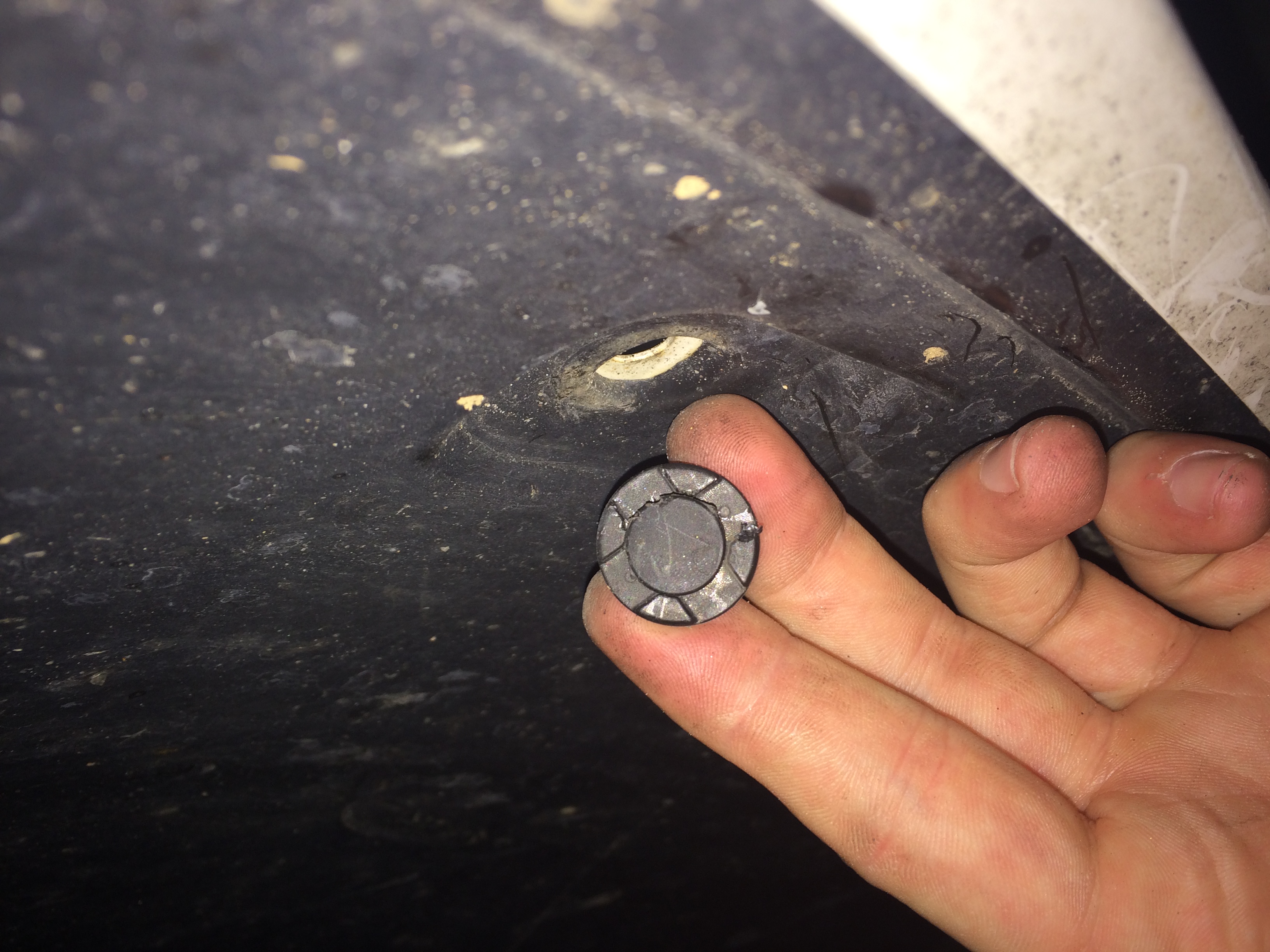

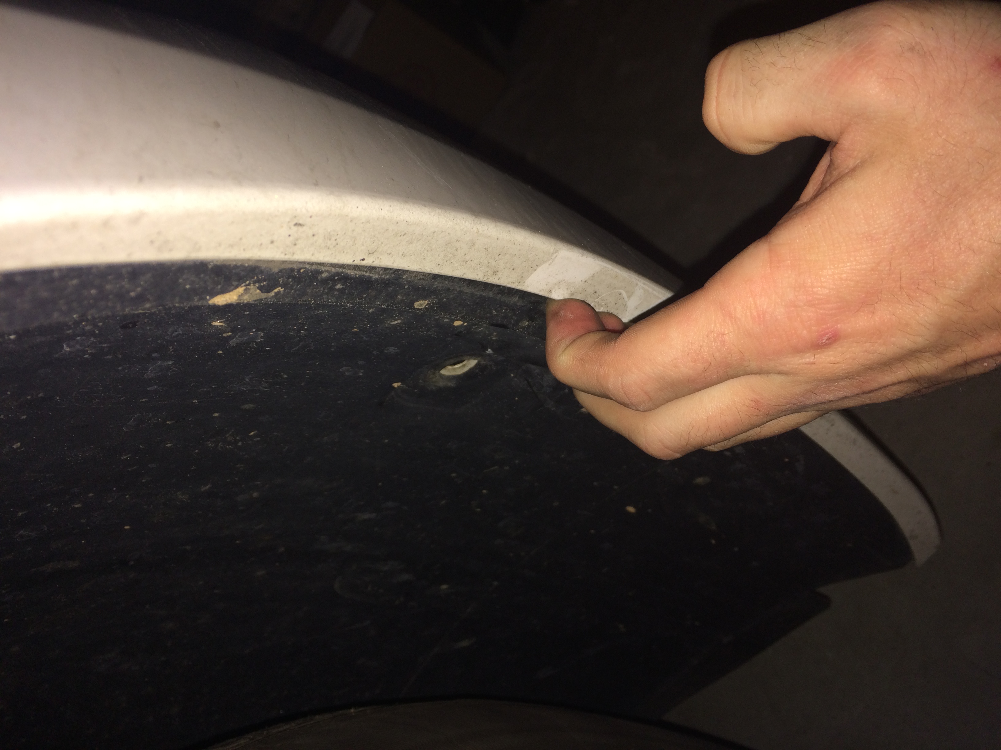

Start your car and cut the wheel either hard left or hard right. Then go to the wheel well and remove the plastic push pin.
https://www.myg37.com/forums/attachm...1&d=1486039369
Pull the plastic wheel well liner away from the bumper. Takes a little work put don't be afraid to get into it a little bit.

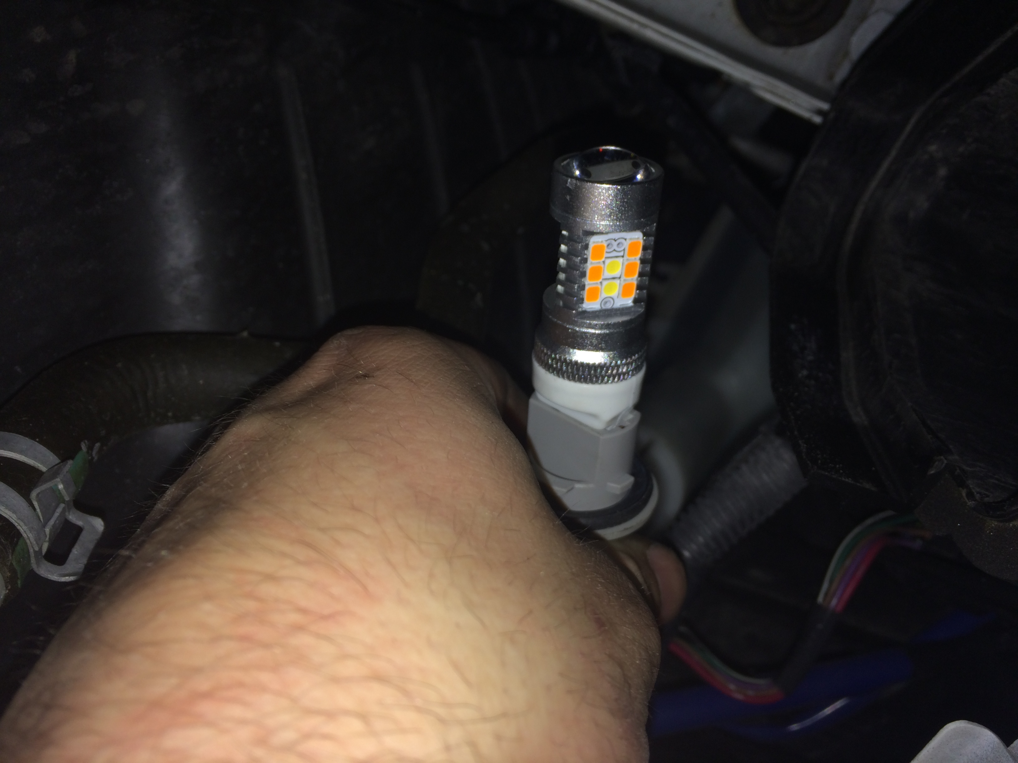

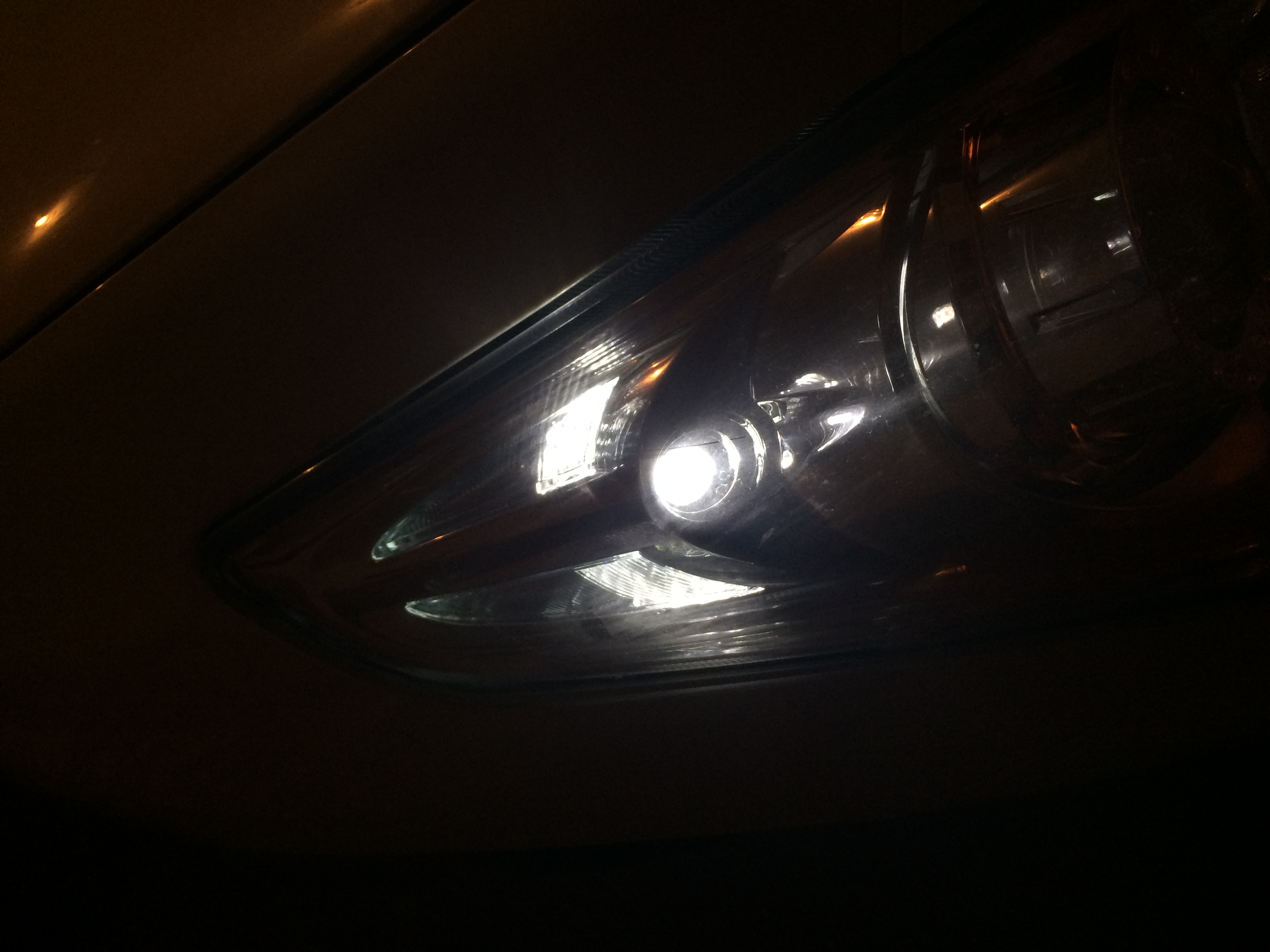

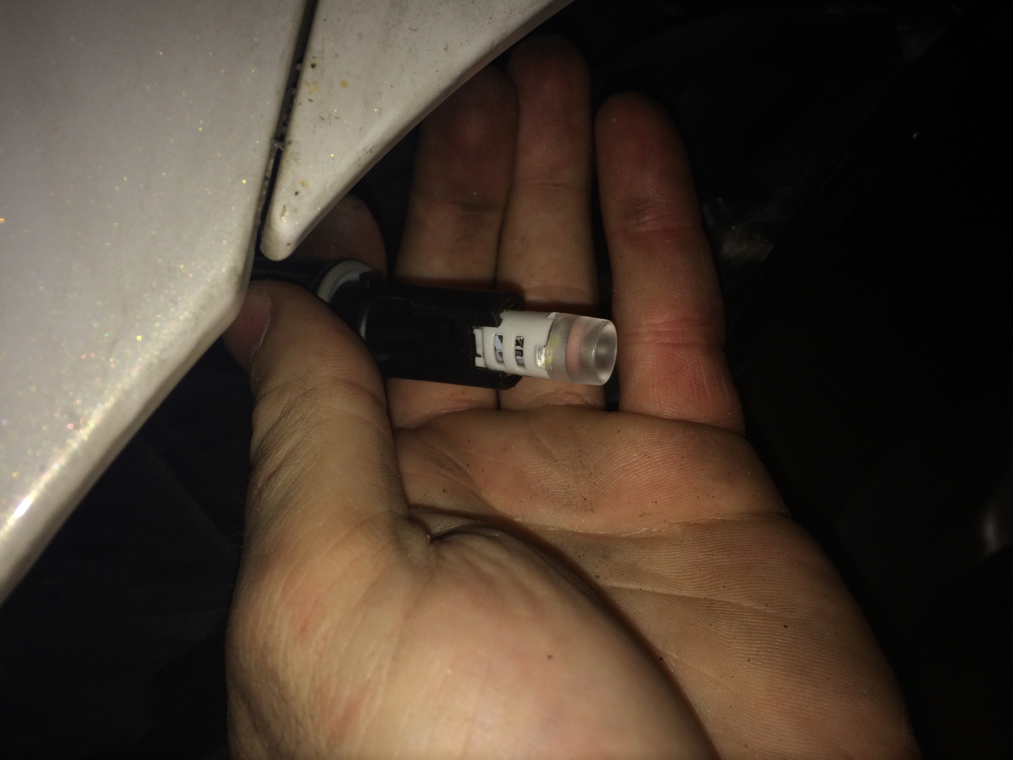

Pull out the OEM amber bulb and replace with your LED replacement. The bulb might not seem like it will fit, or at least that was my case, but with some added pressure it will snap right in. If this happens to you - do not get carried away...
https://www.myg37.com/forums/attachm...1&d=1486040128
https://www.myg37.com/forums/attachm...1&d=1486039767

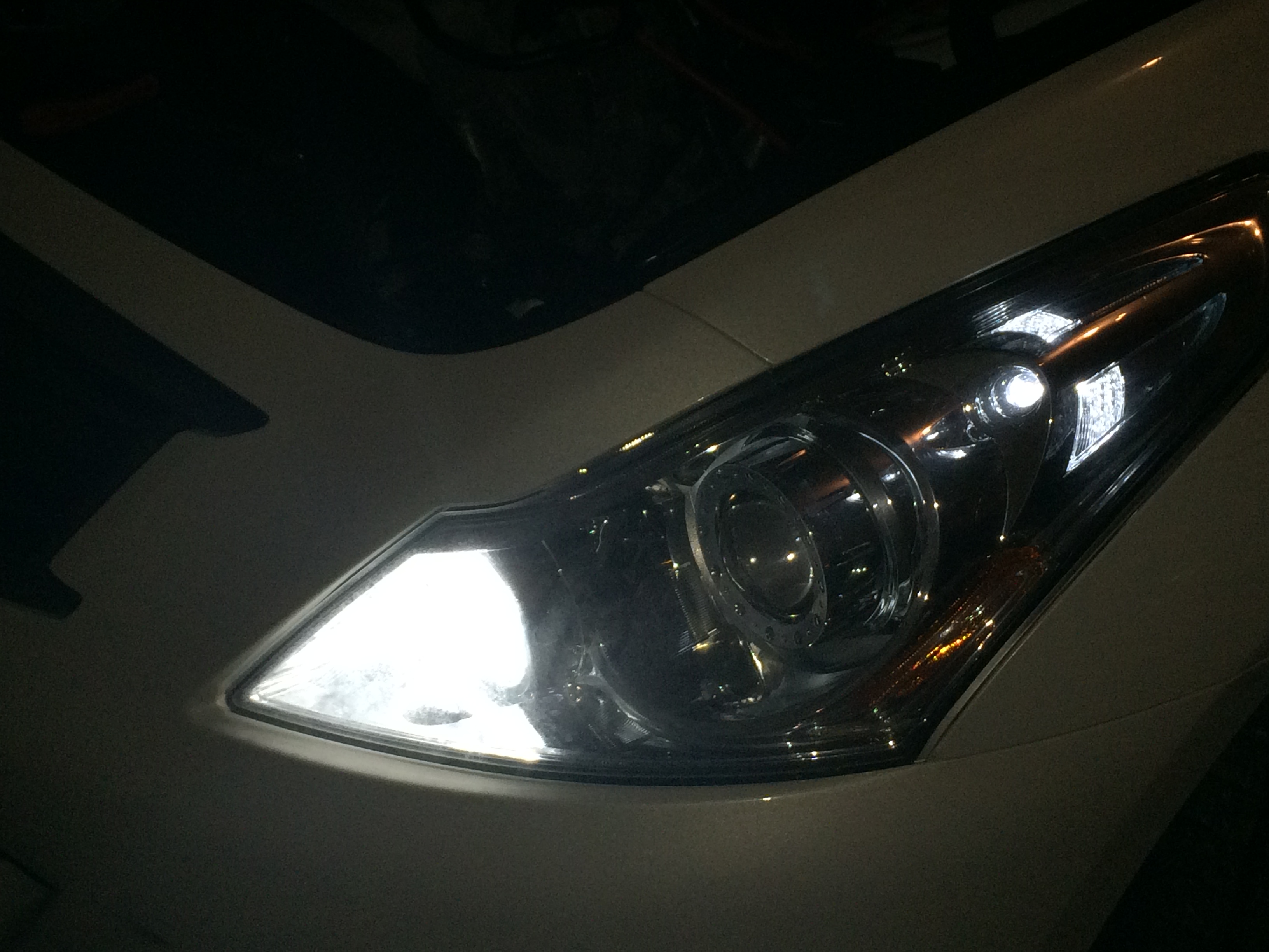

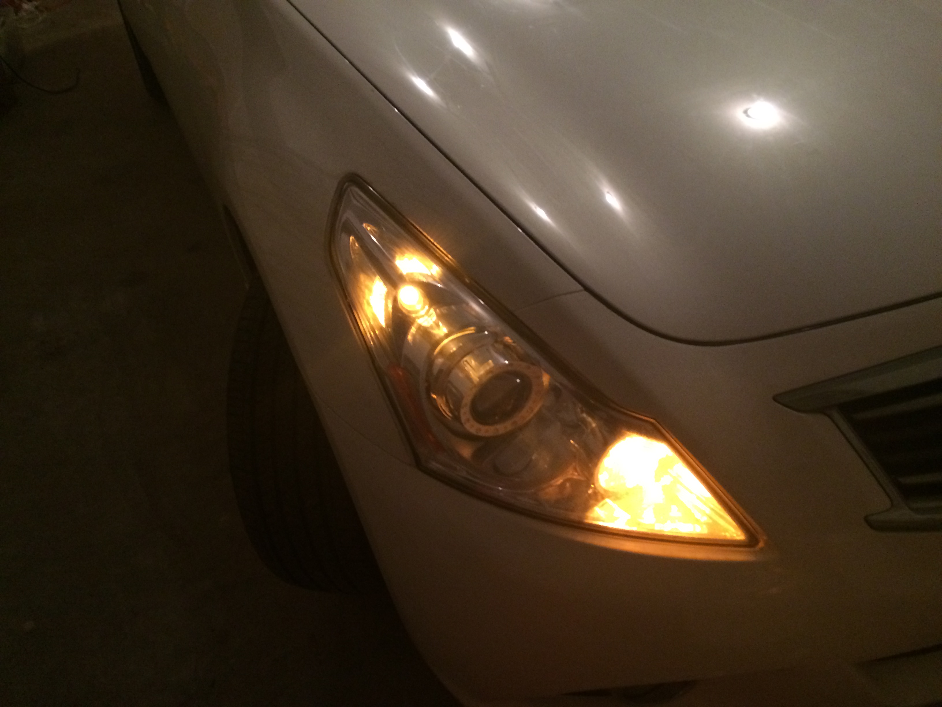

Picture of both in with amber city lights for comparison. The blue is a little exaggerated for some reason. They have the blue "twinkle" in person but not as prominent as pictures suggest.

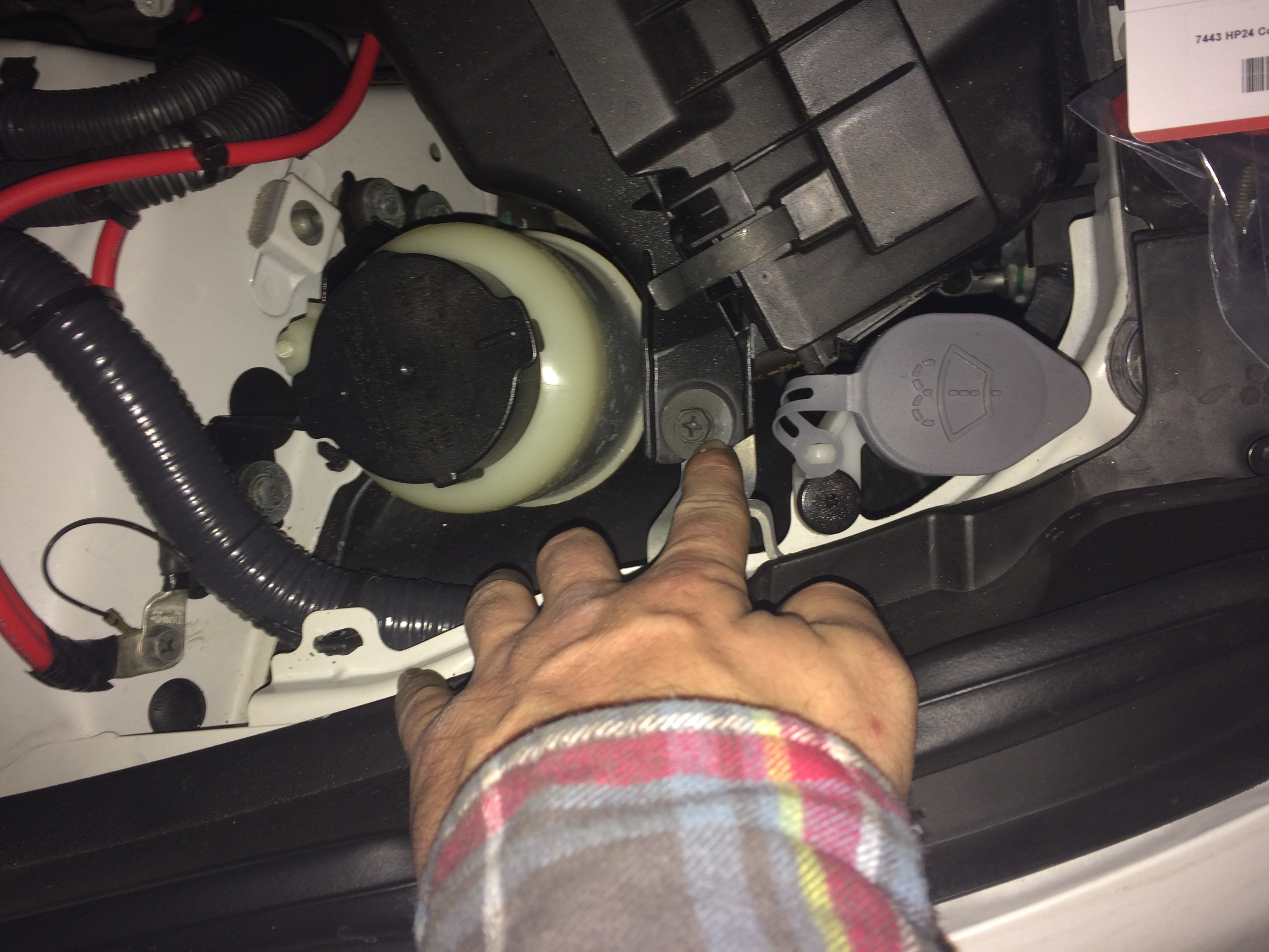

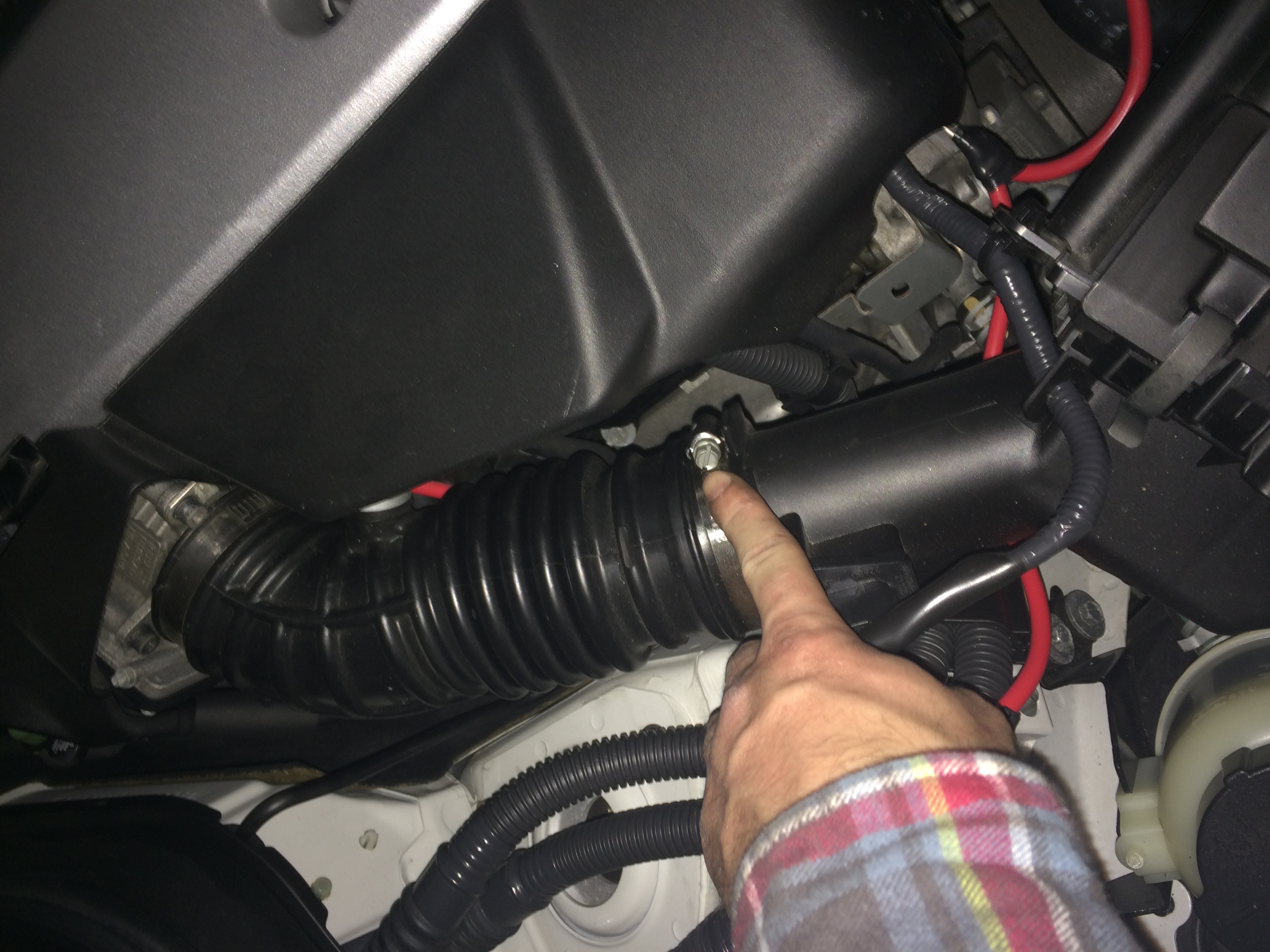

I'm just going to explain how to do one side since doing both is a little redundant but if anyone has a question feel free to ask. Start by removing the airbox. It is secured by one 10mm bolt, Clip securing MAF sensor to the box and the intake ring. After that, just pull up and rotate out of your way. BE CAREFUL WITH THE MAF.
https://www.myg37.com/forums/attachm...1&d=1486040241
https://www.myg37.com/forums/attachm...1&d=1486040392

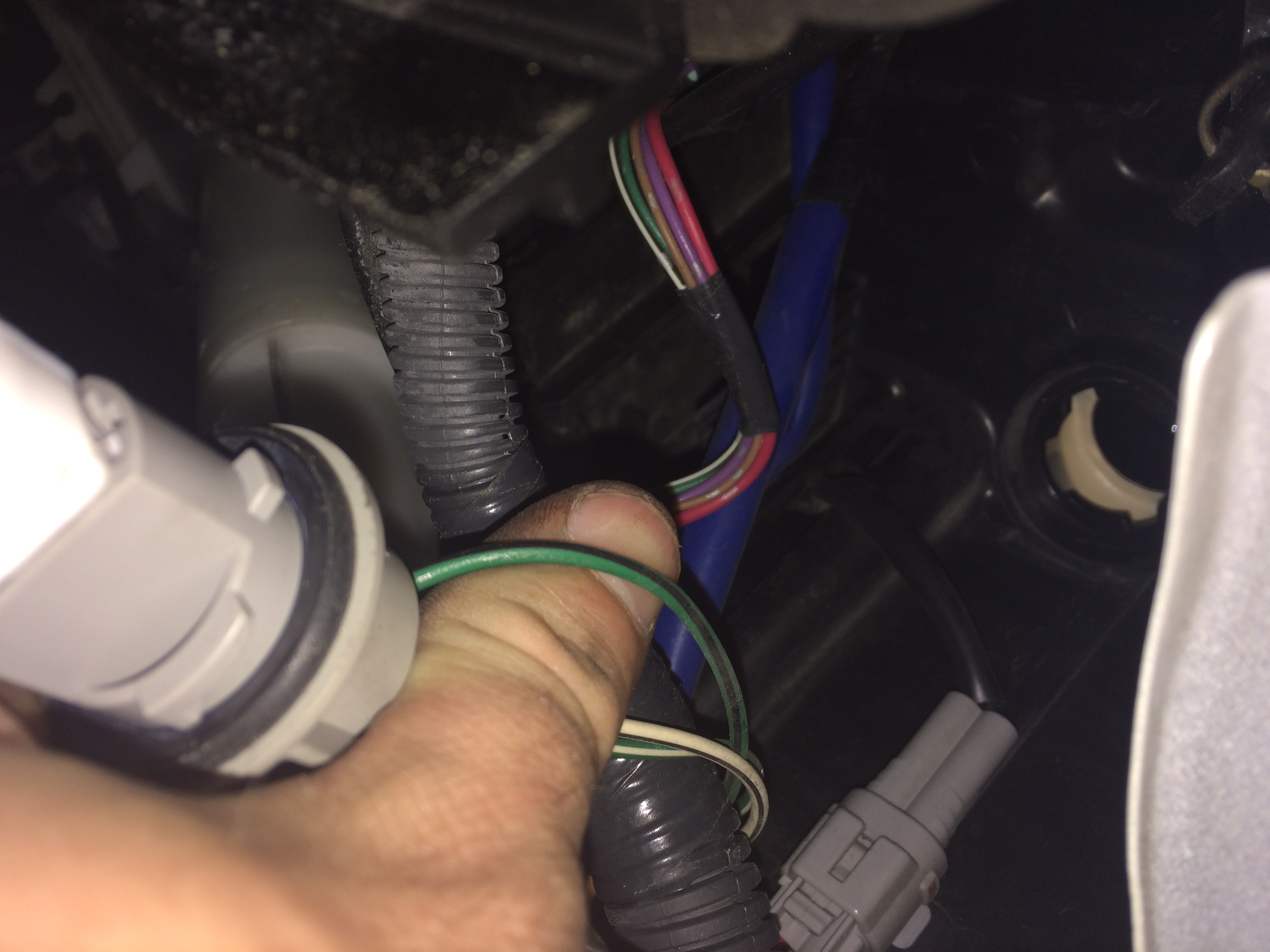

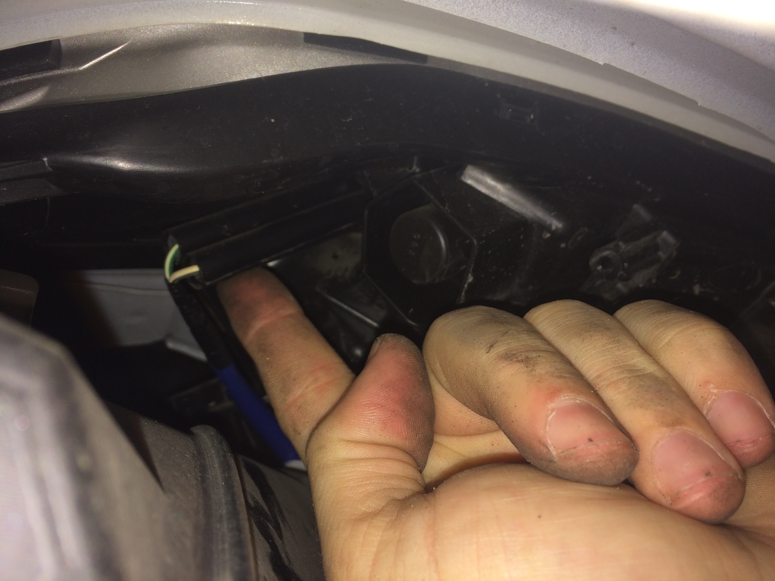

Next locate the City light bulb housing. It can be distinguished by the three wires exiting the back and the white housing. You may have to lean over into the bay a bit to see it. Just like the city lights
https://www.myg37.com/forums/attachm...1&d=1486040464
Pop out the OEM amber and replace with the LED replacement.
https://www.myg37.com/forums/attachm...1&d=1486040852

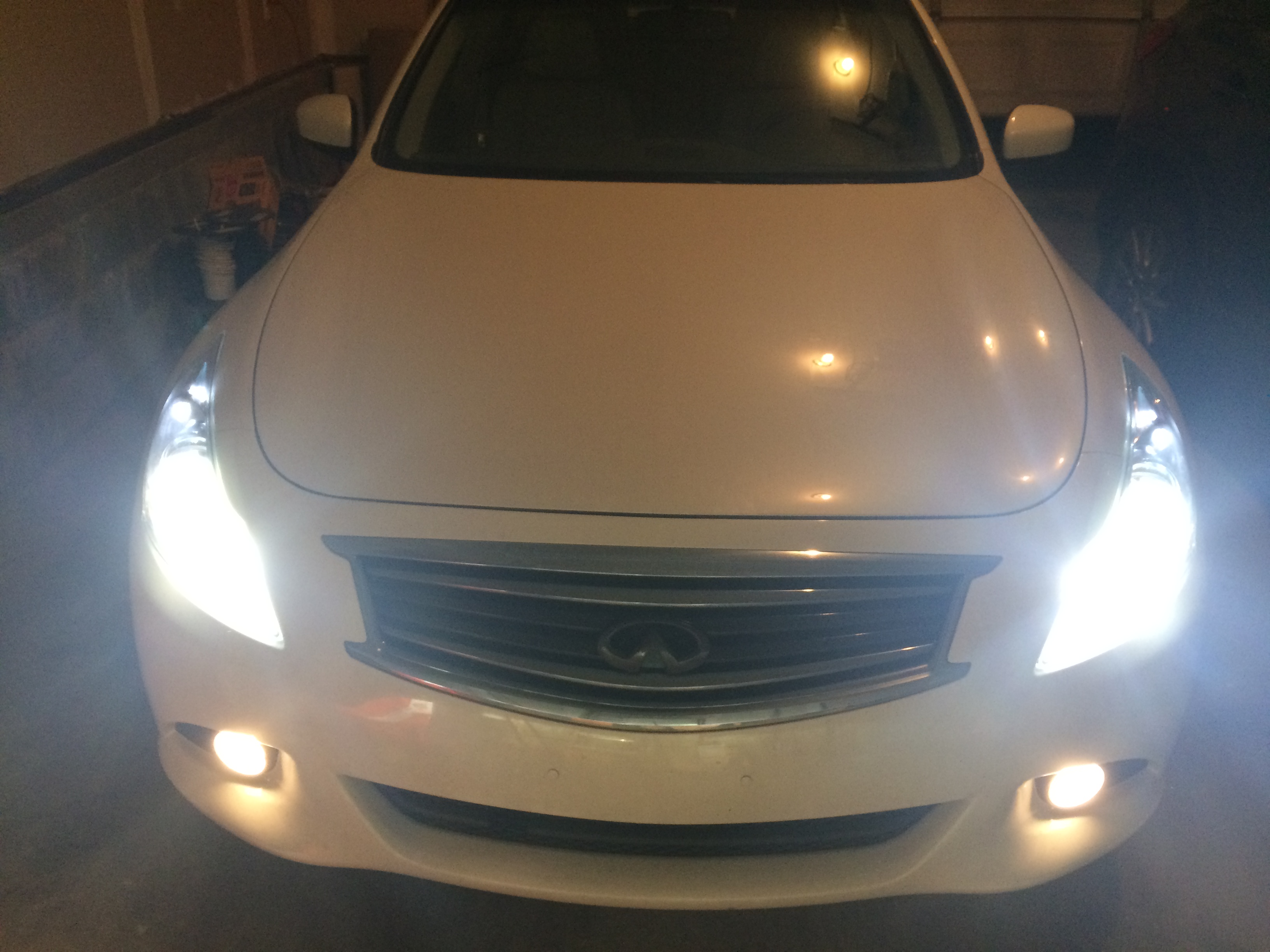

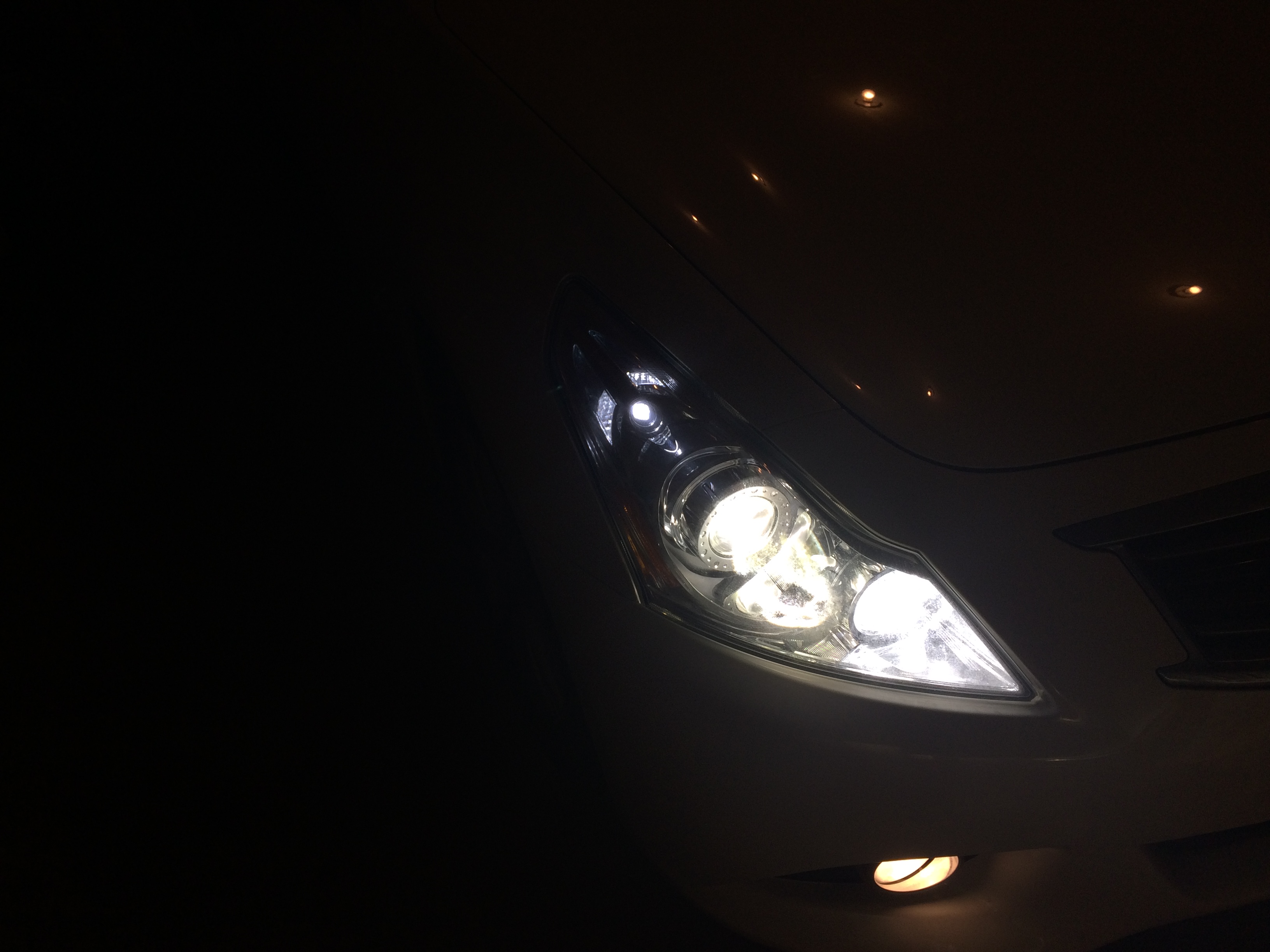

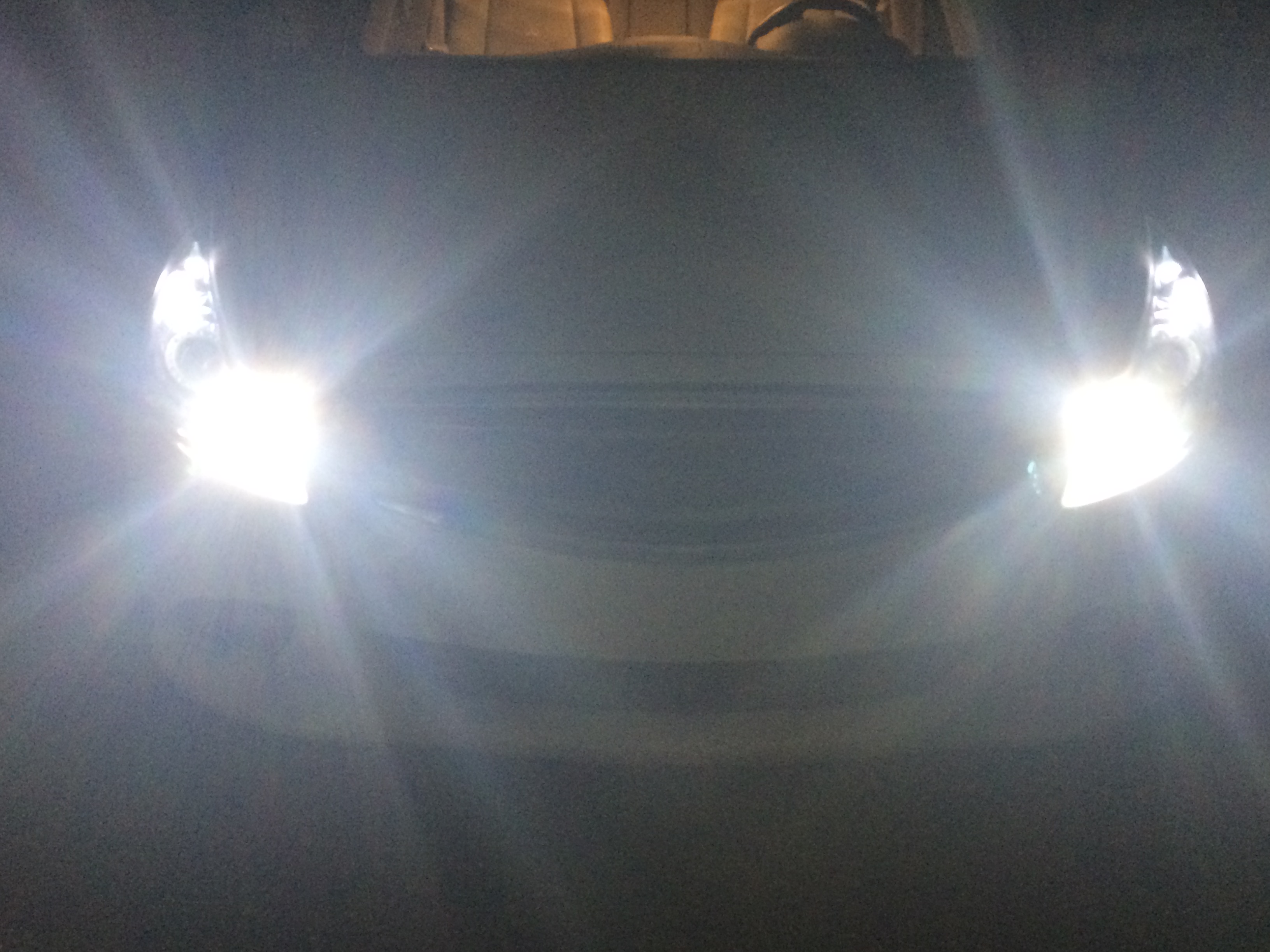

Here is a picture of what it looks like installed and turned on without signalling.
https://www.myg37.com/forums/attachm...1&d=1486041093

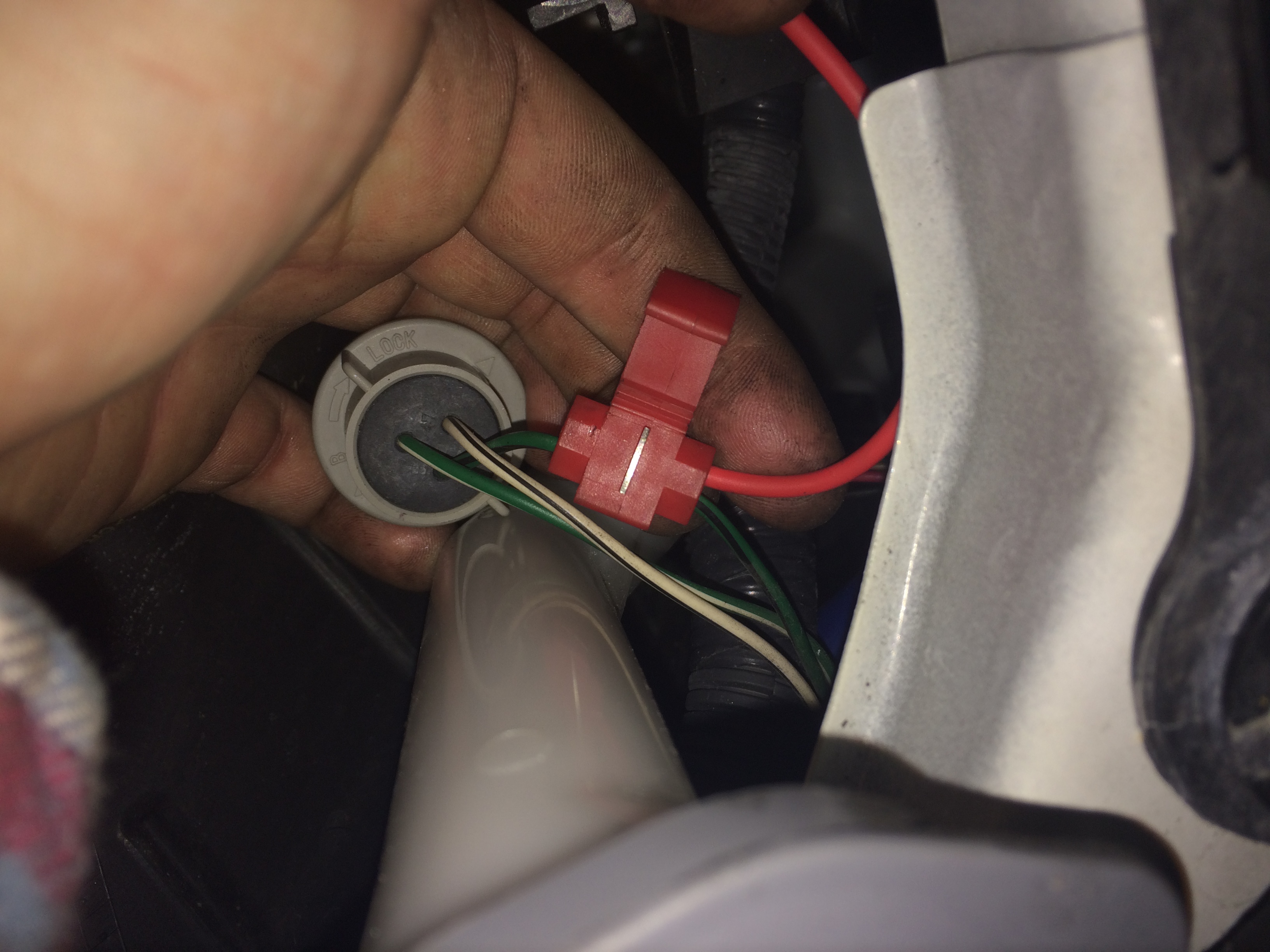

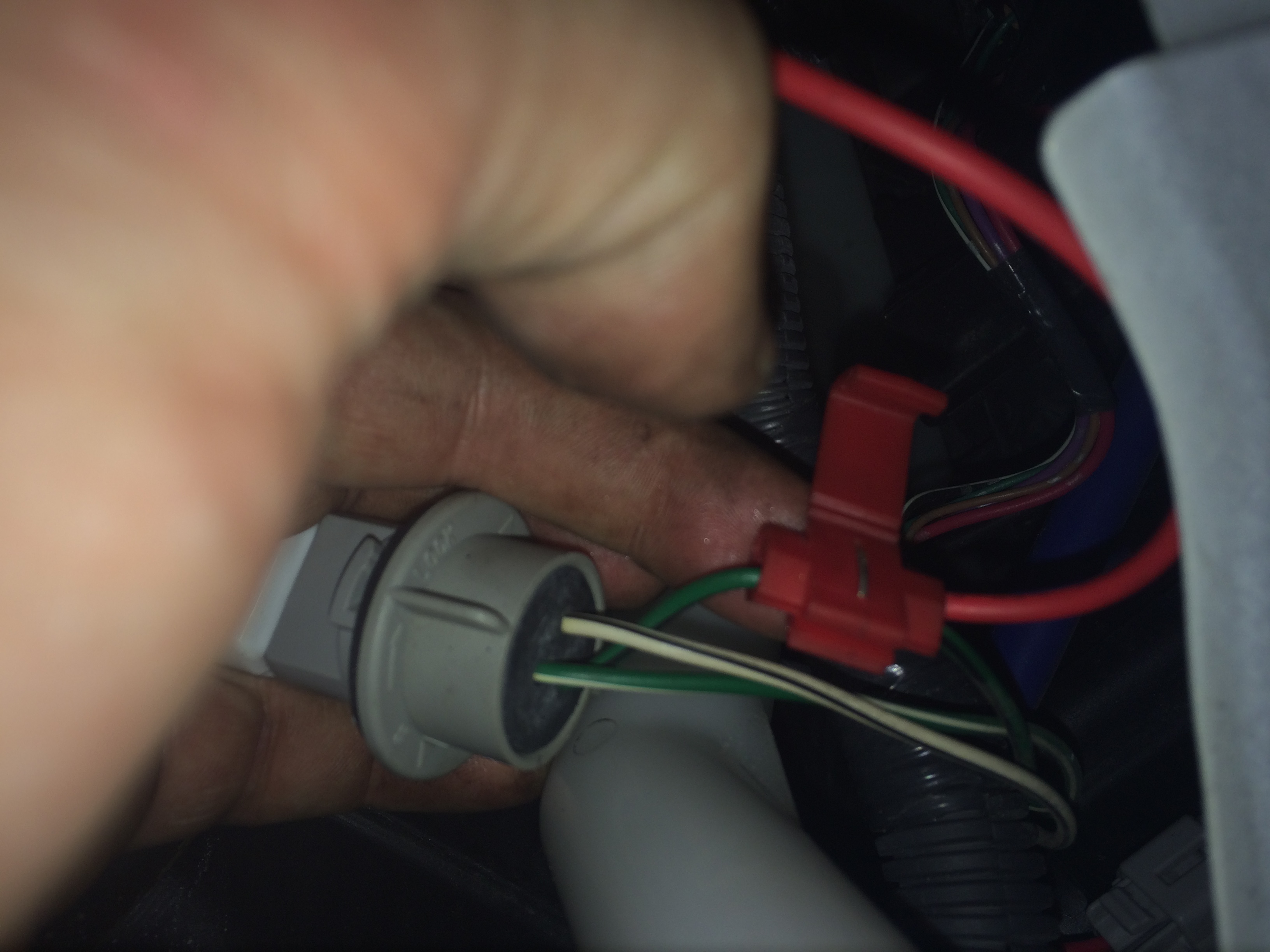

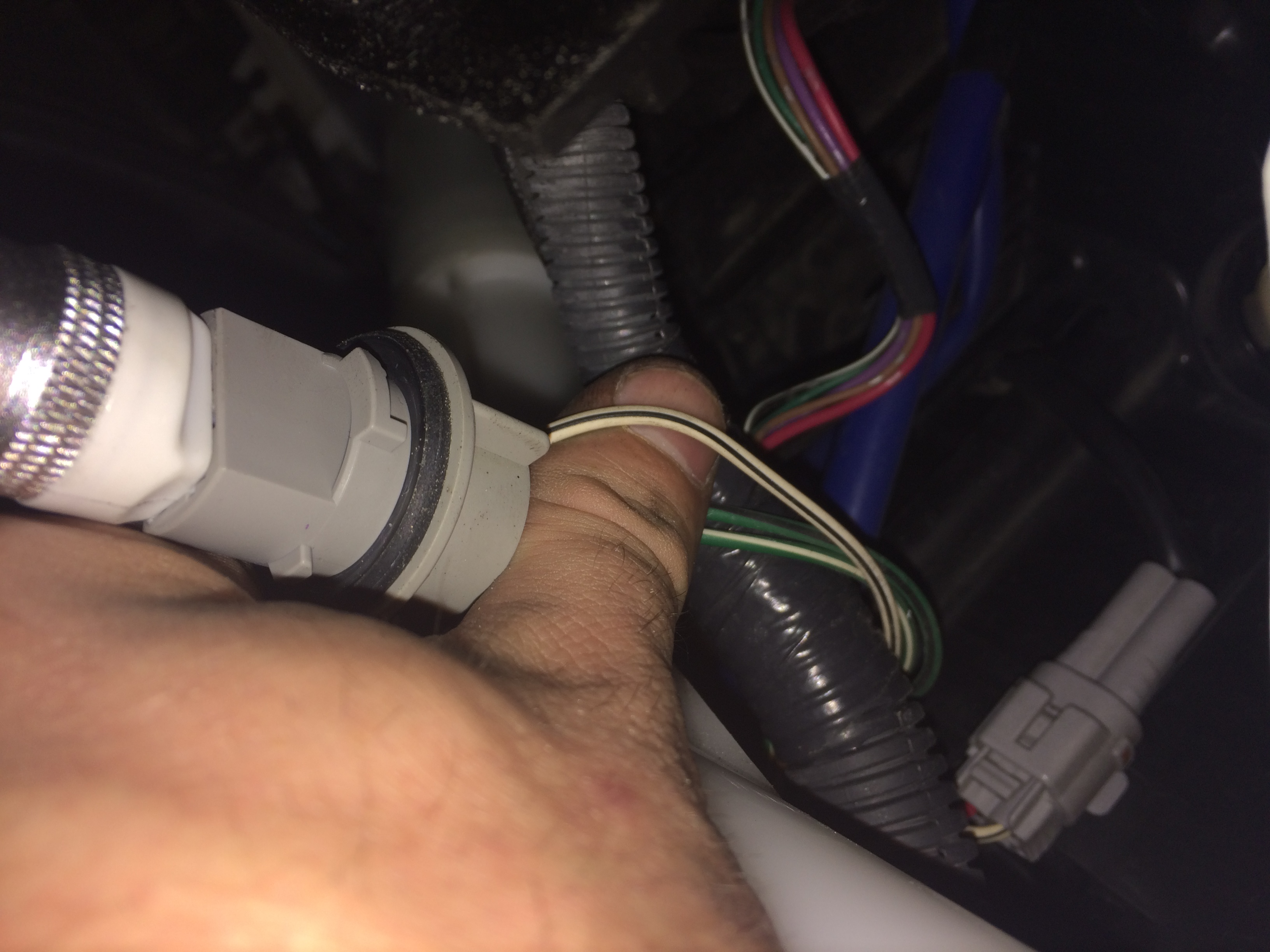

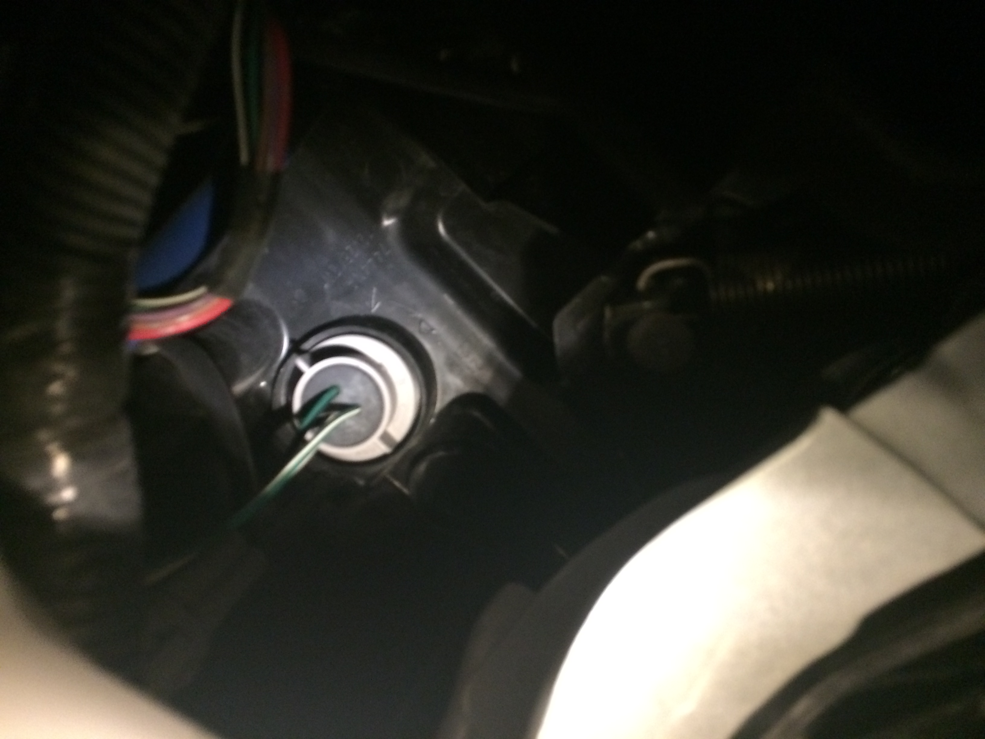

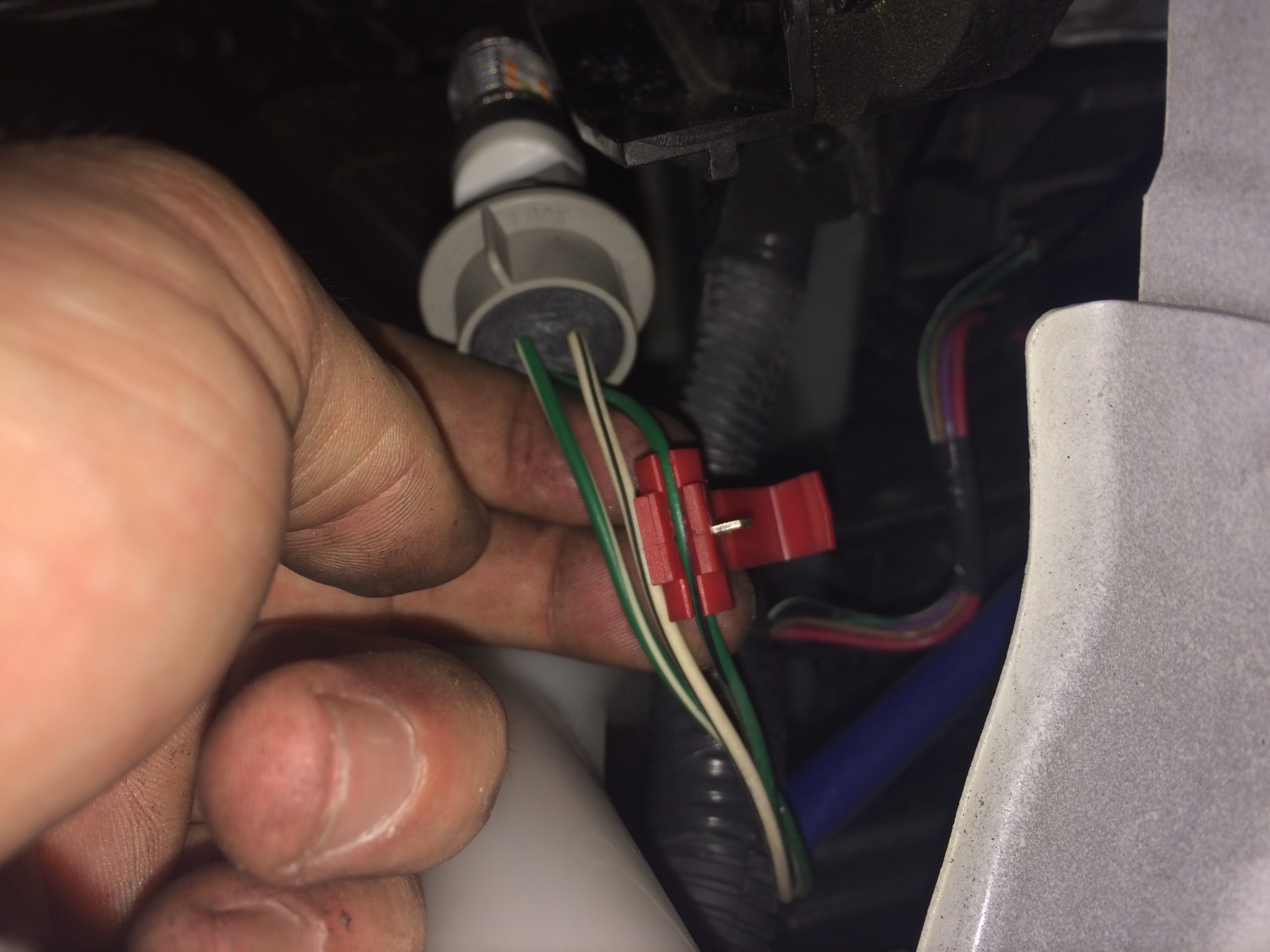

I'm going to backtrack to the point where we install the new bulb. If you look at the back of the housing you see three wires: Green/White, Green/Black, and White/Black.
You want: GREEN/BLACK & WHITE/BLACK
https://www.myg37.com/forums/attachm...1&d=1486042361

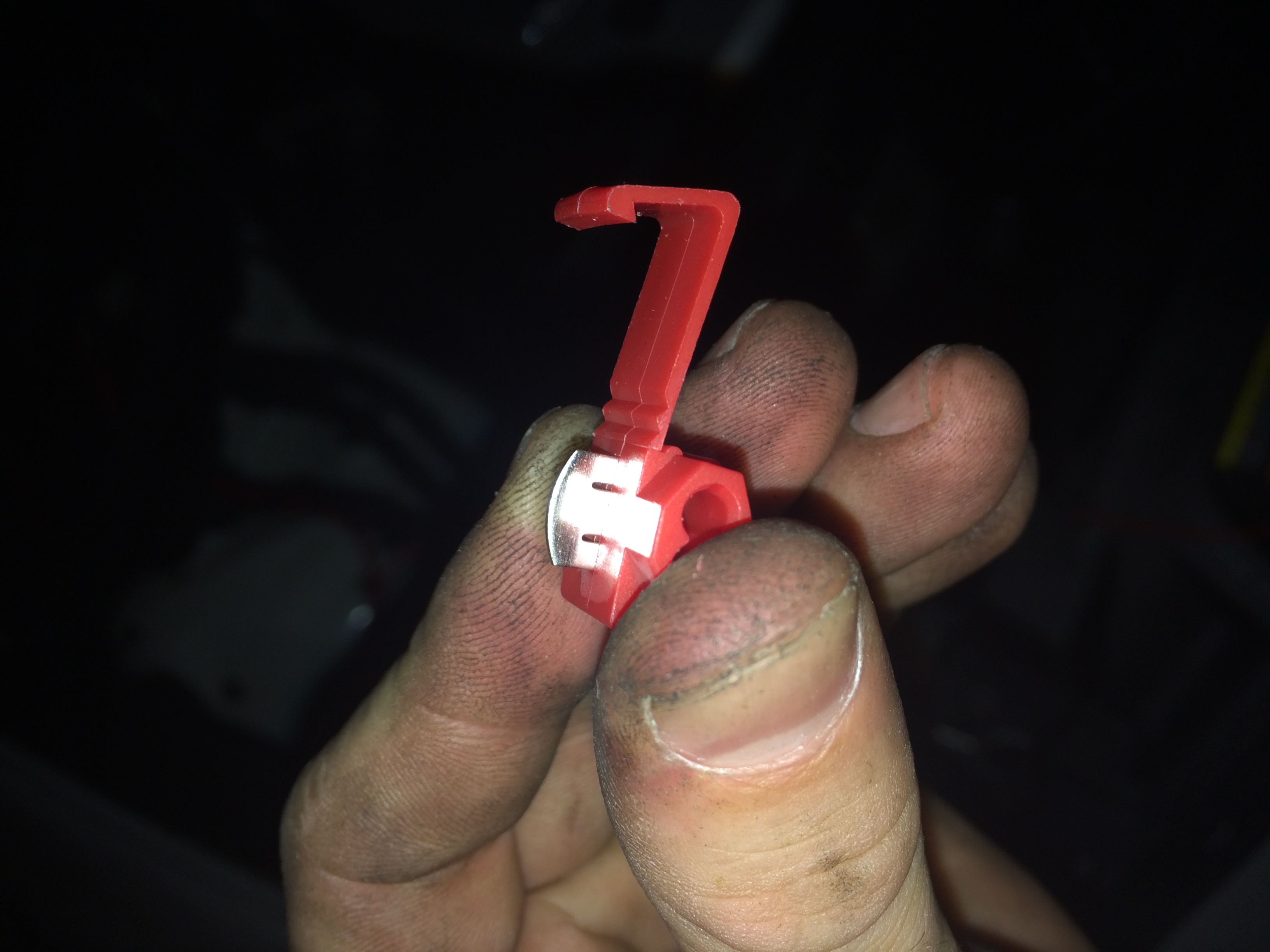

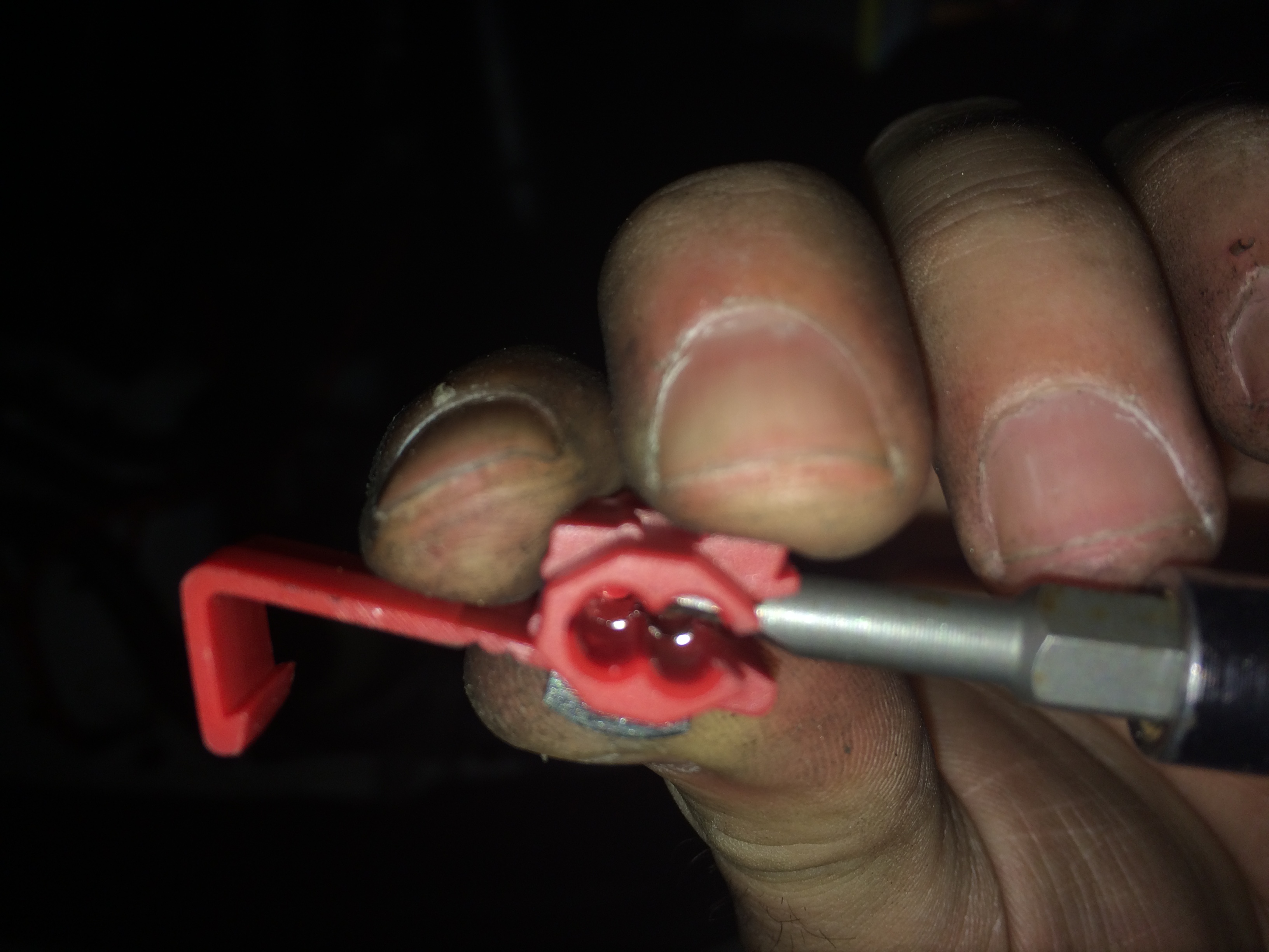

Take your red connector, provided by DD, and spread it open just a bit. You can use your flat head by sticking it in and twisting sideways. This helps the wire slide in. You will notice, on the connector / splicer you can see two openings. One you can see all the way through and the other one is capped off; so you can't see all the way through. Your head light wire goes into the opening you can see all the way through while the red resistor wire goes into the capped opening.
https://www.myg37.com/forums/attachm...1&d=1486042538
Next, take one end of your resistor and slide it ALL the way in until you hit the capped end.

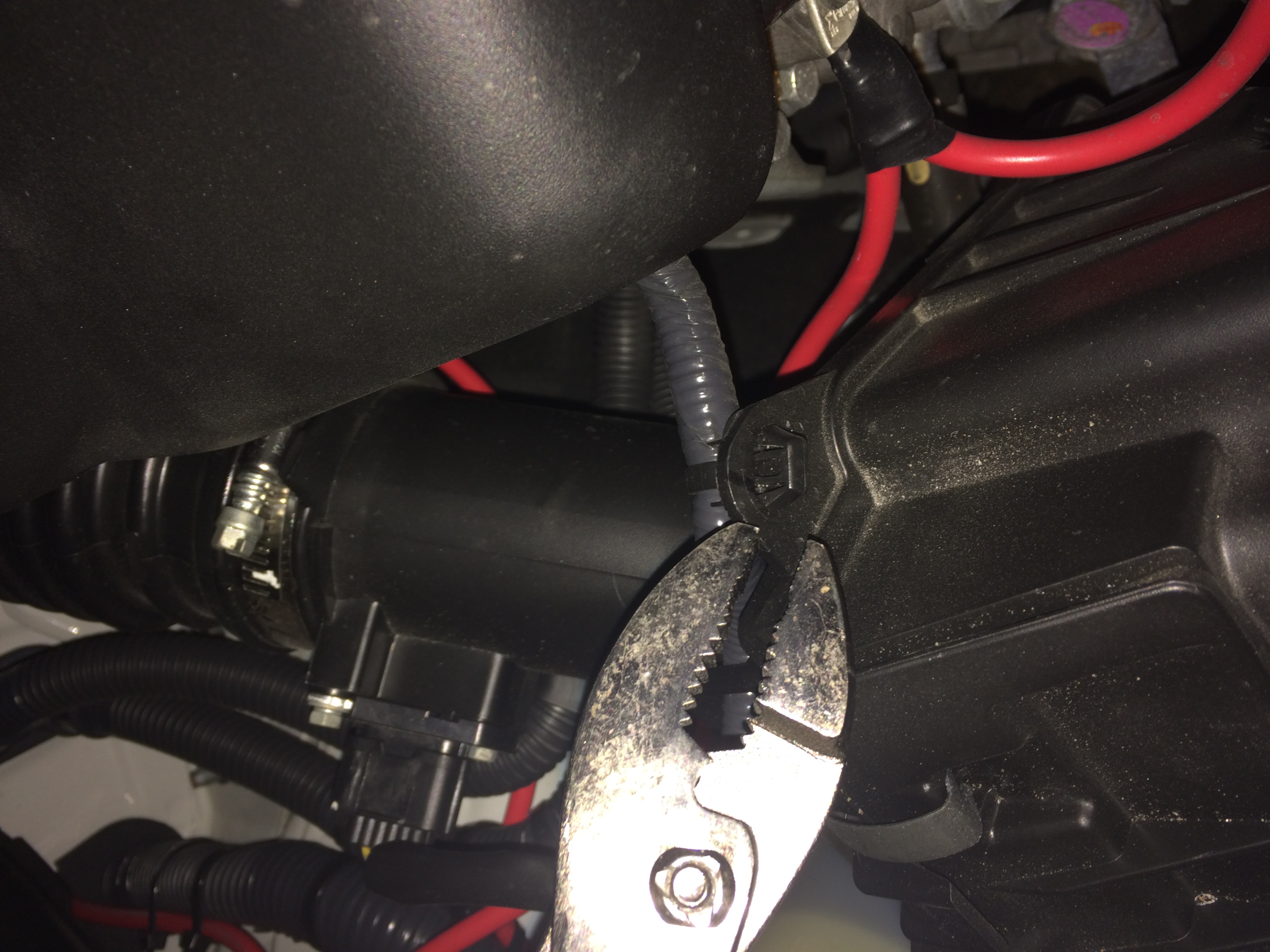

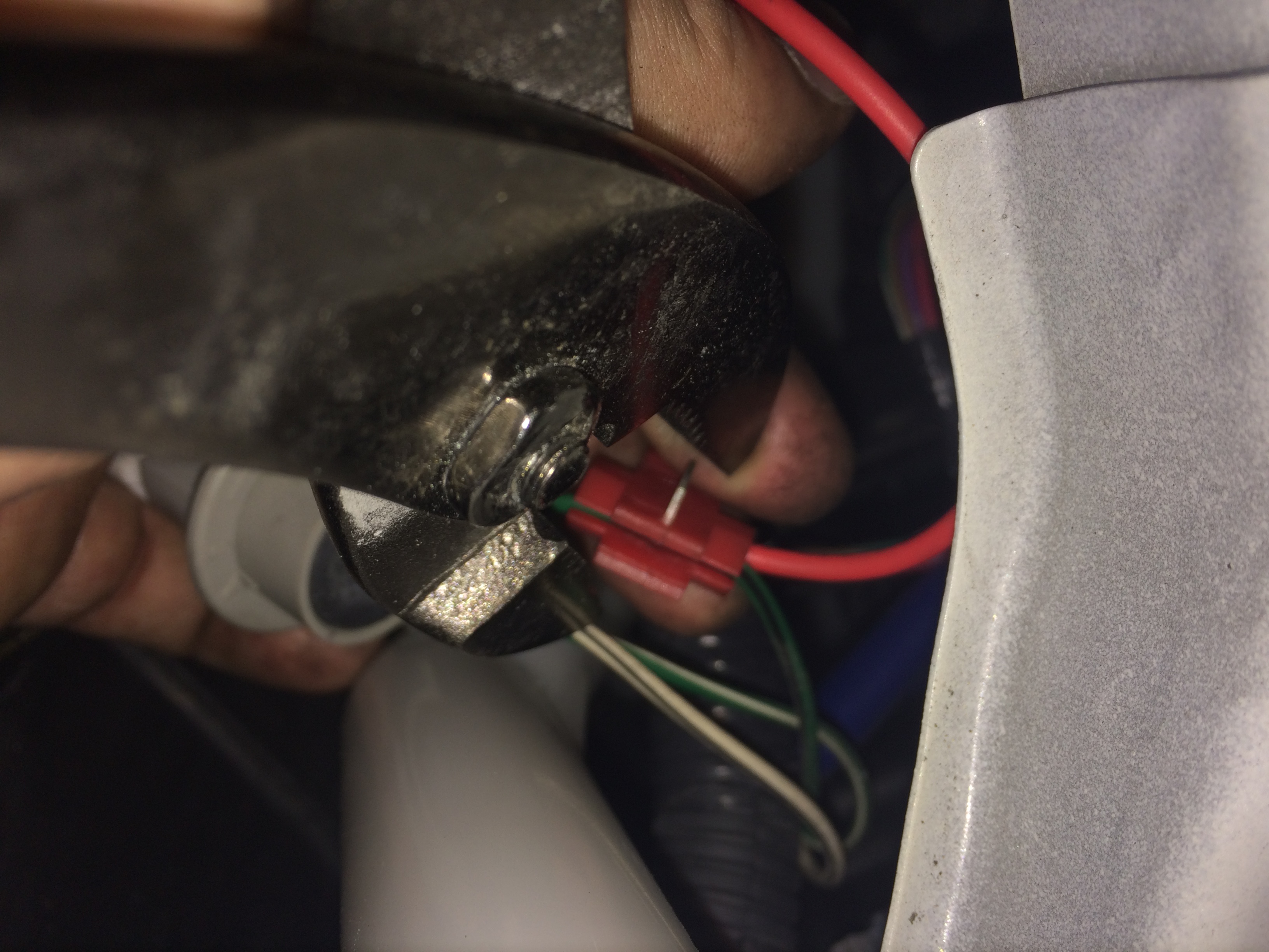

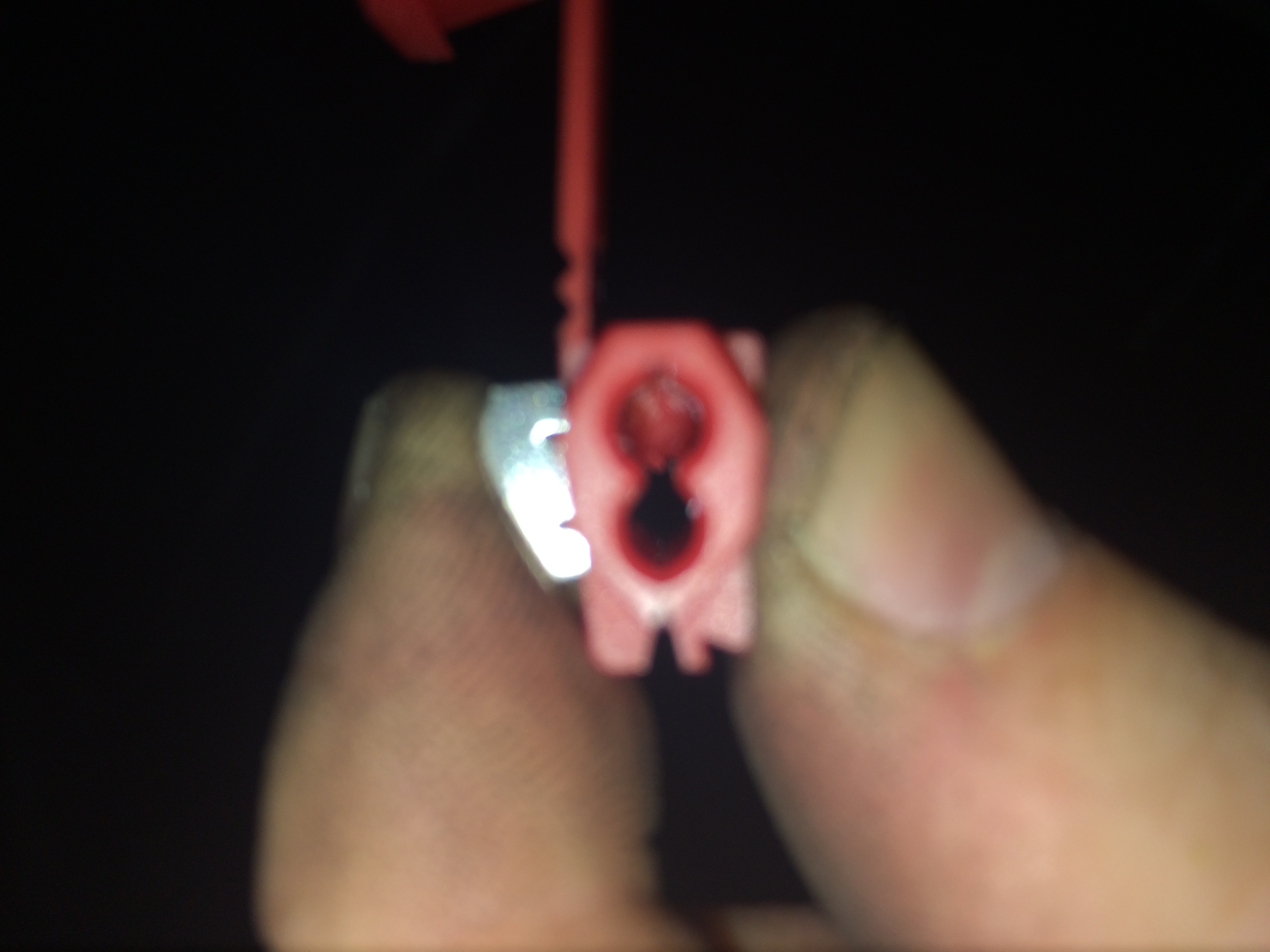

This is where most people snap the resistor shut and call it a day. Truth is, this is NOT enough for the metal splicer to cut through the wire's coat. There were multiple posts I read that stated the blinking was still occurring even with the resistors. There is a strong likelihood that they did not cut the splicer through the coating. I actually did this the first time and then went back and used my pliers to seat the splicer flat. Pictures below.
This is after my first attempt where I just snapped the cap shut. You can clearly see, despite the blurriness, that the splicer only moved on the end where the snap shuts.
https://www.myg37.com/forums/attachm...1&d=1486043093
With pliers and how it SHOULD look:
https://www.myg37.com/forums/attachm...1&d=1486043272

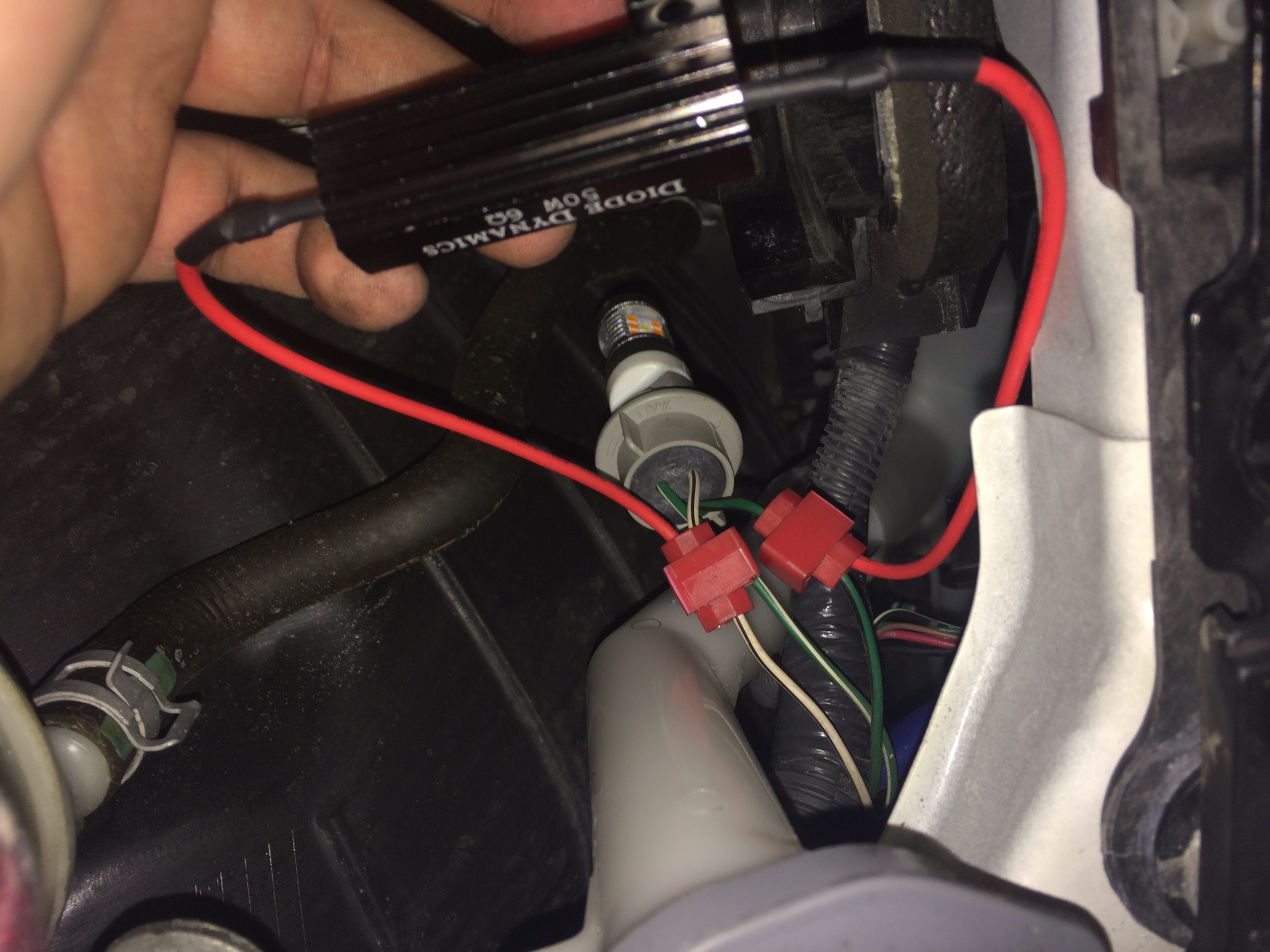

Now, just do the exact same to the other wire in the assembly. Repeat on both sides. Here is a picture of the set up when put together:
https://www.myg37.com/forums/attachm...1&d=1486043396
Picture with both replacements installed.
https://www.myg37.com/forums/attachm...1&d=1486043564
