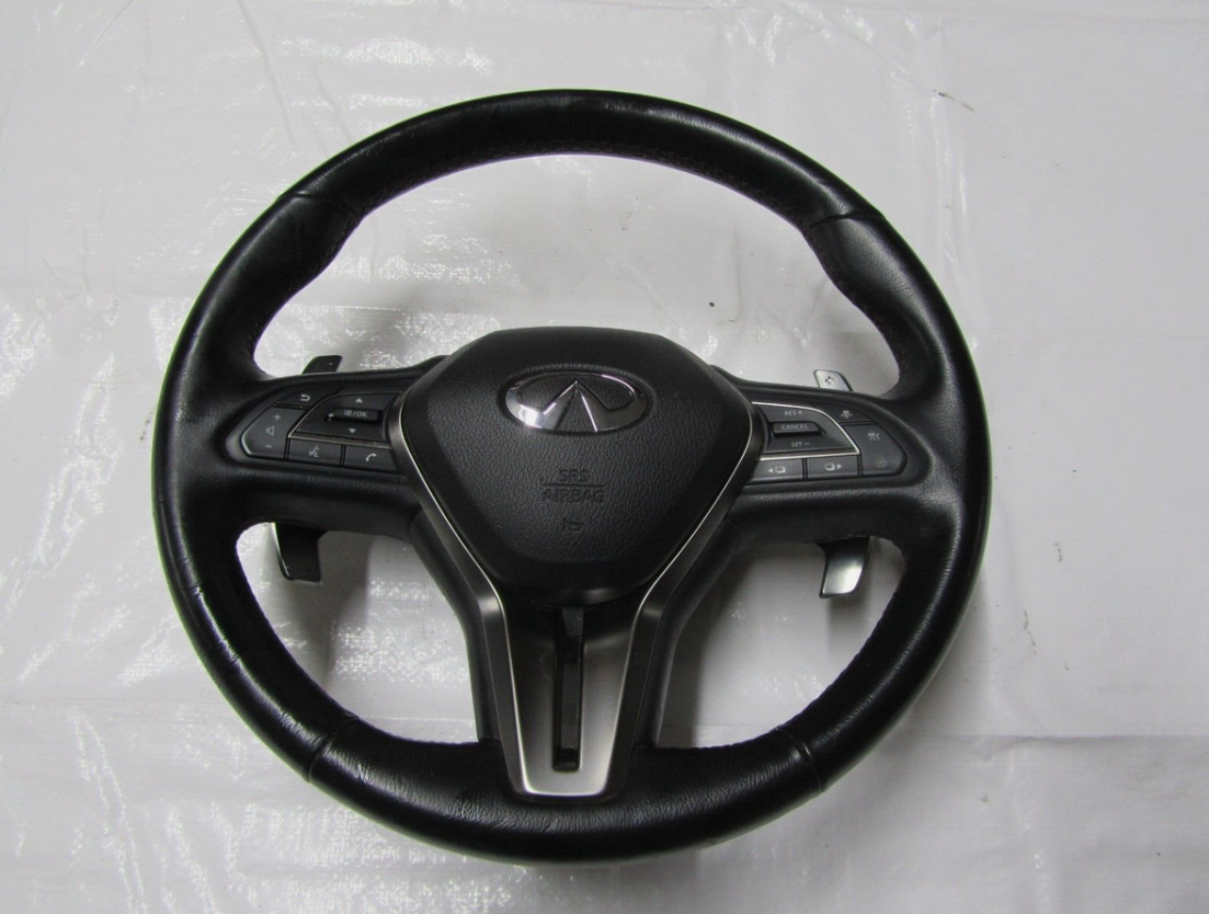

Hey does anyone know if it is possible to switch the new q60 steering wheel and shift **** to the old G37, they are somewhat the same car so I don't see why not and people have switched over the gt-r and maxima shift *****, and people have switched over the Z steering wheel to the G so does anyone think this mod is possible, im wanting to give my car a little "update" and I think this mod would be awesome, however I know on the new steering wheel there are some new buttons for functions that arent on the old g37, so if i install the new steering wheel will those buttons just not work and just be a "prop" or will that affect the functionality of all the other buttons (volume, phone, etc). I'll post some pics so you can see what im talking about.

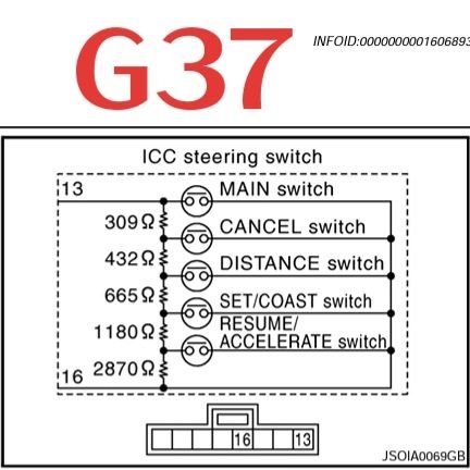

Likes: 1,612
From: NC
It is just a matter of checking the resistance values of the ICC button(s). The main difference between the two wheels are the connectors. The G37 uses a 8-pin connector (that plugs into the clockspring) whereas the Red Sport and Tech package wheels use a 16-pin connector.
Edit: just checked the two FSM's and the Q60 ICC button(s) likely will NOT work on the G37 ICC system. On the Q, the ICC is integrated with DAS, and the signal values are slightly different.

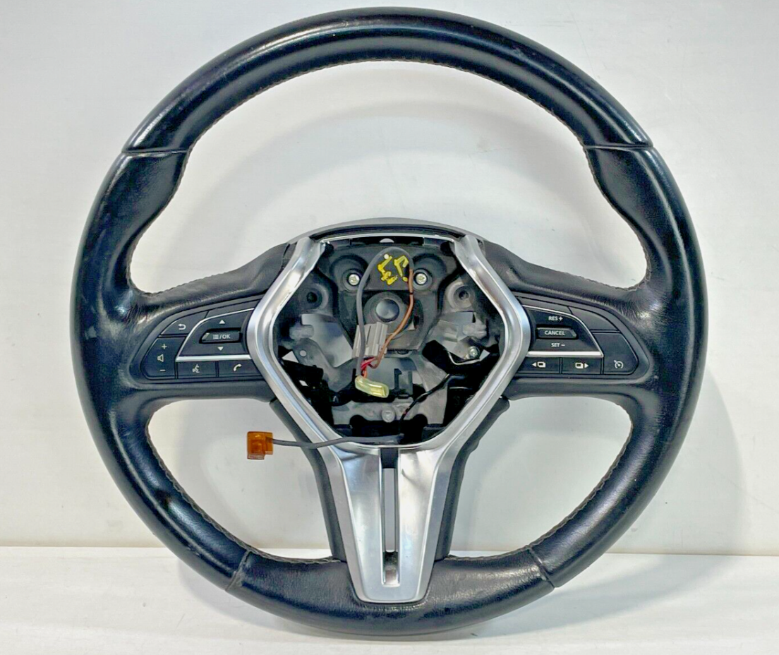

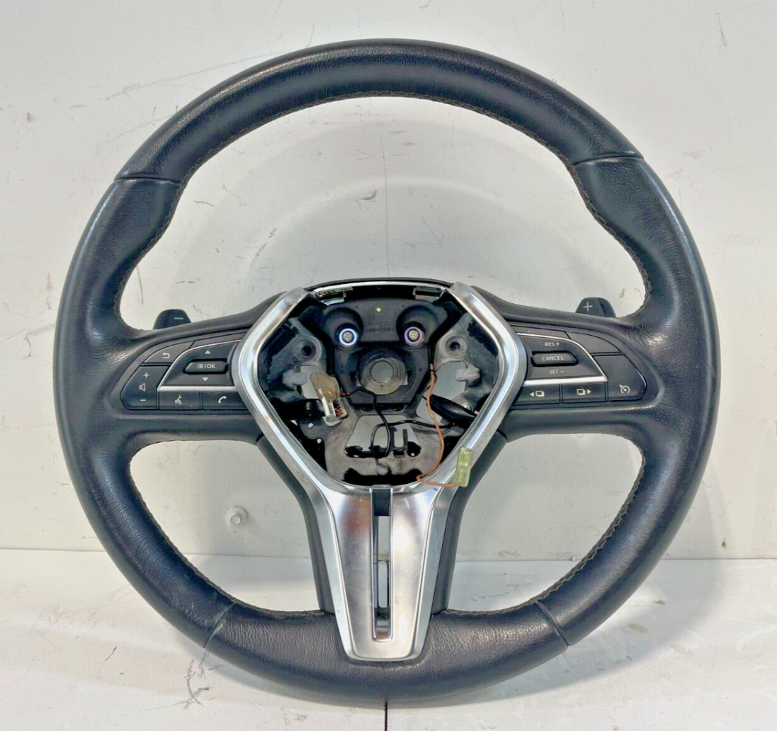

There are three (3), yes, THREE (3) different steering wheels that Infiniti used for the Q60/50 (C/V37) cars.
Base/ Non-Tech:
Tech (w/ steering wheel mounted paddles, and w/ or w/out heater):
Red Sport (Tech pkg., larger paddles, DAS wheel switches, heater, and red stitching):

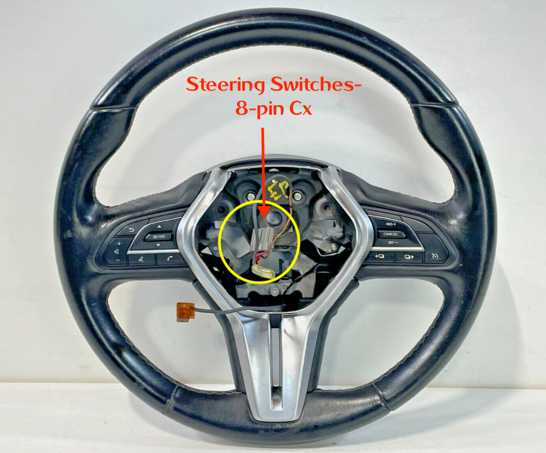

There are major differences in the wiring between the Tech/ Red Sport wheels and the Base/ non-tech wheel. The key difference is the wiring connector. The Base/ non-Tech wheel uses a gray, 8-pin connector to plug into the clockspring:
The 8-pin gray connector is what makes this a direct fit for the G37 clockspring.

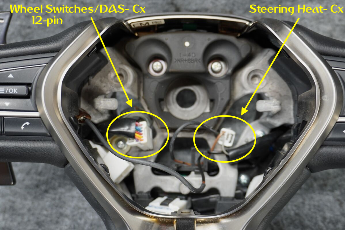

The other two wheels use a 12-pin for the switches, paddles, and DAS, and, if heated, a separate 2-pin for the heater that plug into the clockspring:
Because of this white 12-pin connector, it is not compatible with the stock G37 clockspring.
ONLY THE BASE/ NON-TECH wheel is "plug-and-play" compatible with the G37. This wheel will bolt right on, the switches will plug into the clockspring, and you retain your existing paddles.

In order to use any of the other two wheels extensive re-wiring has to be done to the car side harnesses at the clockspring. You will also need, at a minimum, a different clockspring (the G37 unit not contain the required number of circuits on the ribbon cable nor the larger heater circuits), remove the G37's column mounted paddles and move those wires to the clockspring (car-side) connectors, and, if you want the heat, adding in a dedicated, switched relay circuit.
