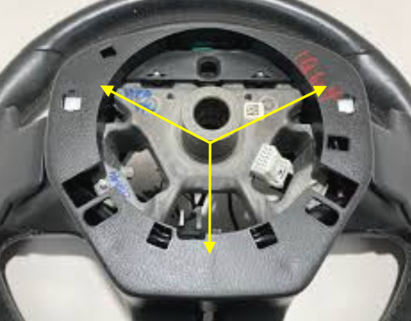

I ended up getting a pretty clean base wheel for $80. I just need the airbag now. I found out that the steering wheel mounted paddles were incompatible and that both the tech and red sport wheels had different wiring around the clock spring or something. I already have the column mounted OEM G37 paddles but I don’t use them anyways. My 2 last questions are what exactly rubs? Just the paddles when you use them or are there plastic pieces that scrape when you turn the wheel? And does the base wheel have a heat function? The ebay seller told me that the base wheel I got does have the heat function but idk if they’re right. And is there an easy way to get the heat functioning or is it just as difficult as rewiring the entire pin connector and clock spring for the steering wheel mounted paddles. I could live without it since the G wheel never had heat but if it was easier to get going than the paddles, although unlikely, that would be nice. Thanks for your help.

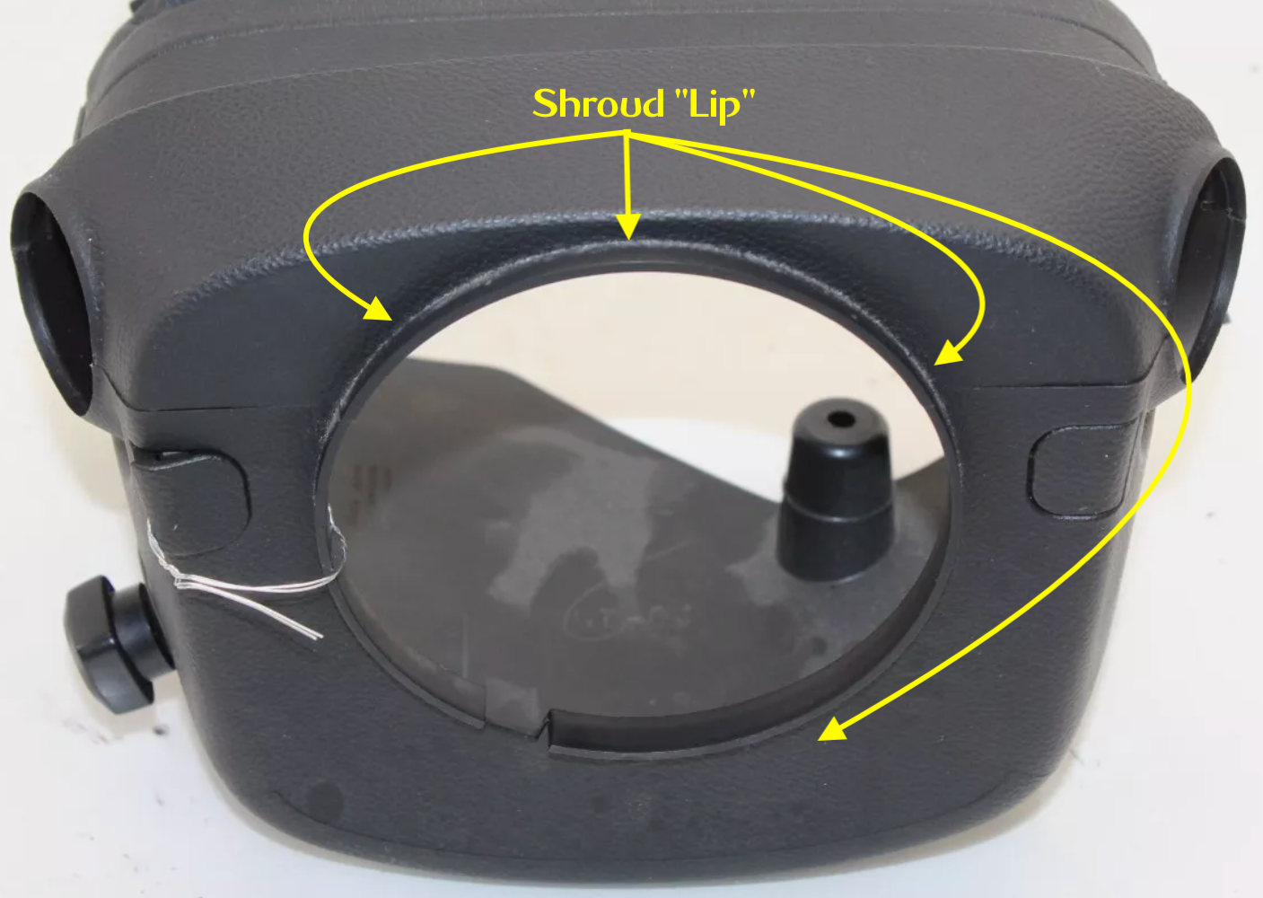

Originally Posted by Levi4689
...what exactly rubs?
The plastic trim cover on the back of the Q60 wheel
MIGHT slightly rub on the lip of the G37 steering column shrouds
I think it is just a matter of the two halves settling in. After all these years any rub is gone so I would consider that issue moot. The G37 paddles will clear the Q60 wheel with zero issues. The paddle "might" hit the back of the steering wheel when "shifting" but not enough to effect anything.
